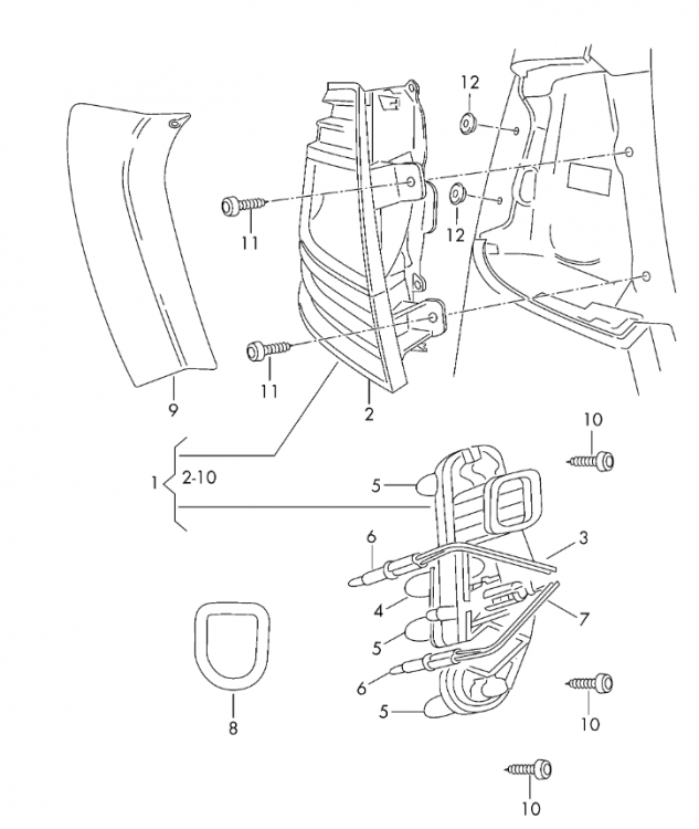

Here you have a diagram of the brake light just in case.
