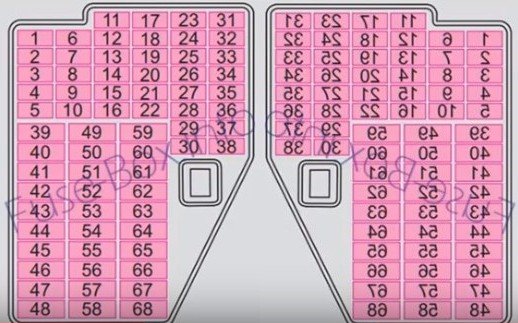

The fuse box is hidden on the SIDE of the dash panel. On a right hand drive model its the whole right end and has no obvious catch/lever to open it. There is a tiny access hole which can be used to lever off the whole end panel to reveal the fuses. The picture shows both LHD and RHD (flipped) diagrams.
