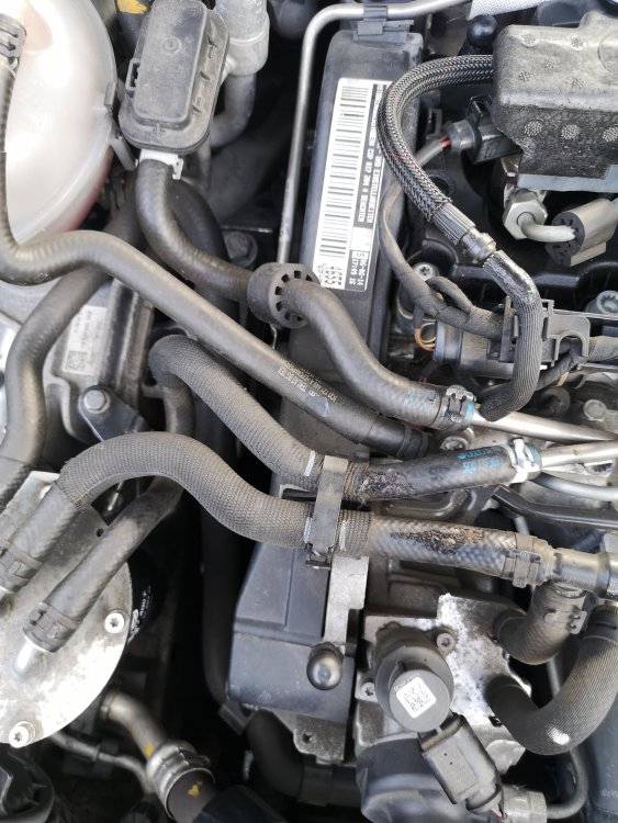

I'm experiencing exact same but on the vrs diesel 2014.
I have had a look at fuel pressure the fuel pressure drops when it starts to rough idle. If you blip the throttle it goes fine blip again it will start rough idling again.
I have been experiencing this for a year now but it is starting to get worse noticed also when it rains it does it worse more often than dry.
No fault codes spoken to a few specialists they are saying could be fuel pressure regulator haven't yet changed them will do soon and see how that goes.

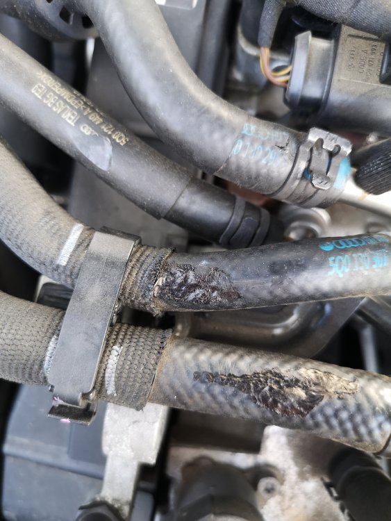

Funny you said about injector seals i changed all 4 seals and o rings on injectors last week they where leaking from seals. Still doing it. No codes come up have obd eleven. Put injector cleaner in problem still there.
5 hours ago, Dillaz_k said:
@Ecomatt car has been serviced.
What state is your dpf in? I only ask as if it is getting blocked it can cause running issues. Also have you ever had your glow plugs replaced? If one of those isnt seated correctly it can lose compression.
@Ecomatt i have had dpf removed/gutted i started noticing this issue alot more as soon as i removed dpf.
Haven't changed glowplugs before car is on 107k now. Spoke with mechanic he said glowplugs don't need changing as you only use them for when starting car when cold and thats it and unlike petrol sparkplugs this wouldn't be the issue.
Do you not think it could be fuel pressure regulator? As when the fuel pressure drops thats when it has a funny idle if you blip throttle its fine and runs fine when driving and sometimes when you come to a stop on idle its perfect sometimes it's not.
