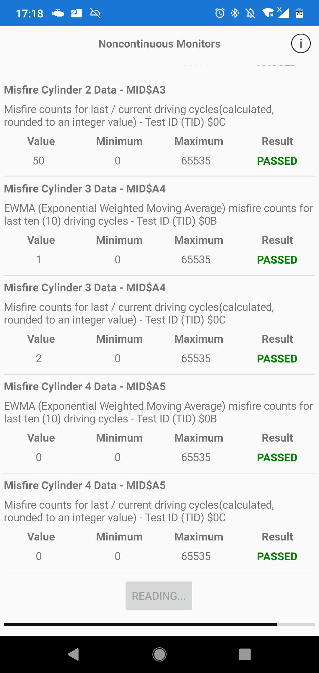

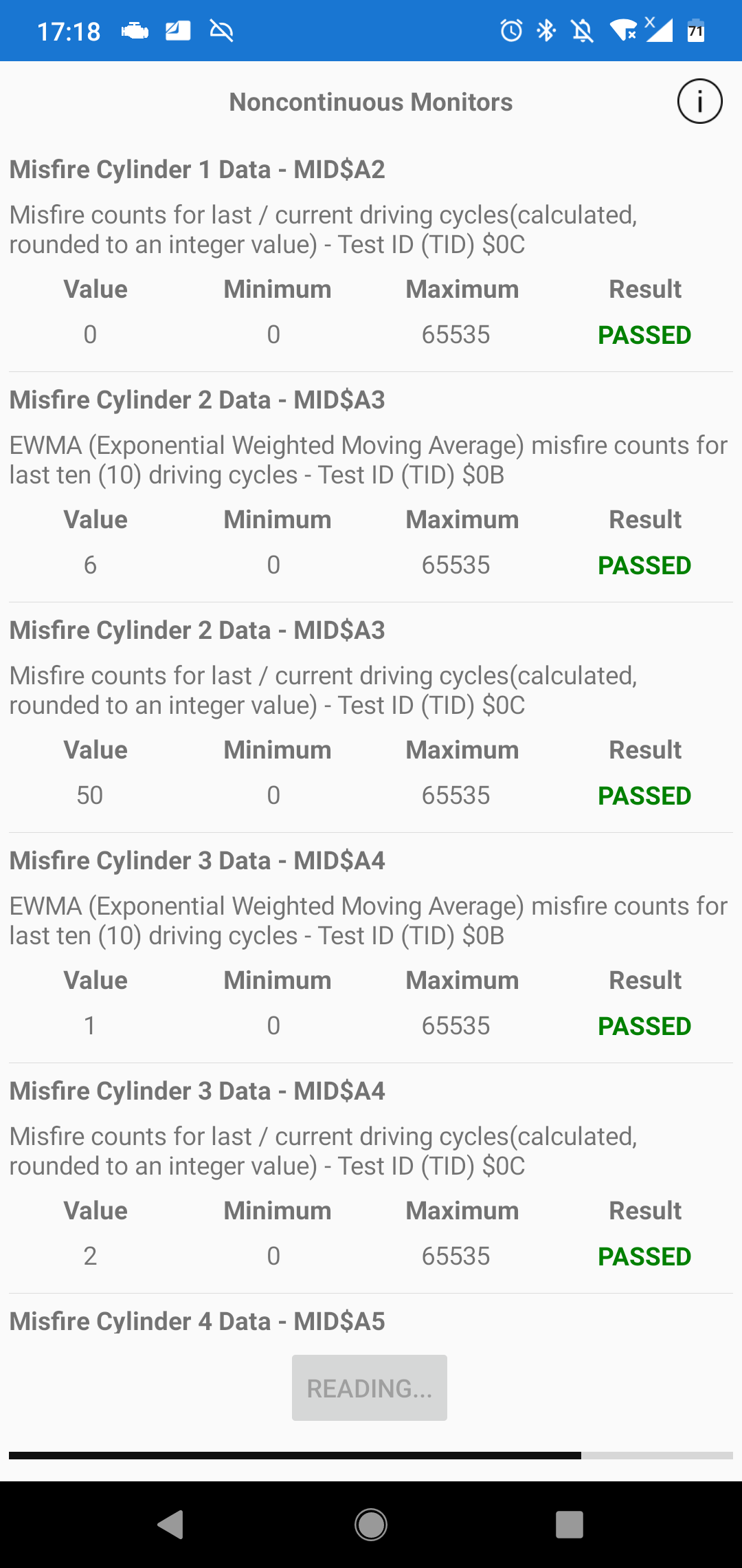

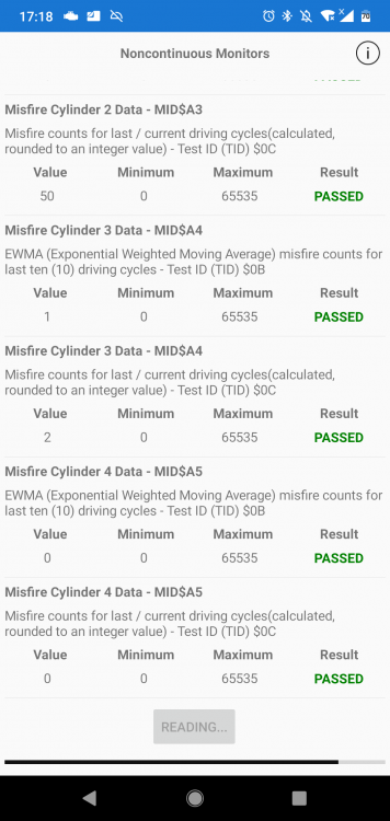

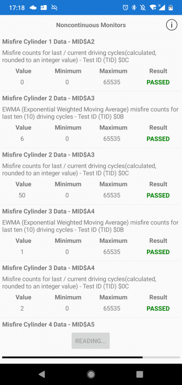

Here are some of the misfires that get logged at idle:
Screenshot_20190920-171806.thumb.png.609be253d4087b77cc76d7f7fb76b84c.pngScreenshot_20190920-171816.thumb.png.3446d5e1242b5089bd10450a877c3602.png
These don't cause the CEL to come on as they're below the threshold, however you can definatley feel them!
Any input?

I would be logging the AFR and timing advance during these events. That would tell you a lot about what is going on.
The car does prioritise efficient combustion over smooth running, but it normally shouldn't have to.

As it is only really one cylinder my guess would be injectors. Most likely the low pressure injector on number 2
Happening as you say it does, it will be as the engine goes from direct injection during warm up to manifold injection for normal use at idle
