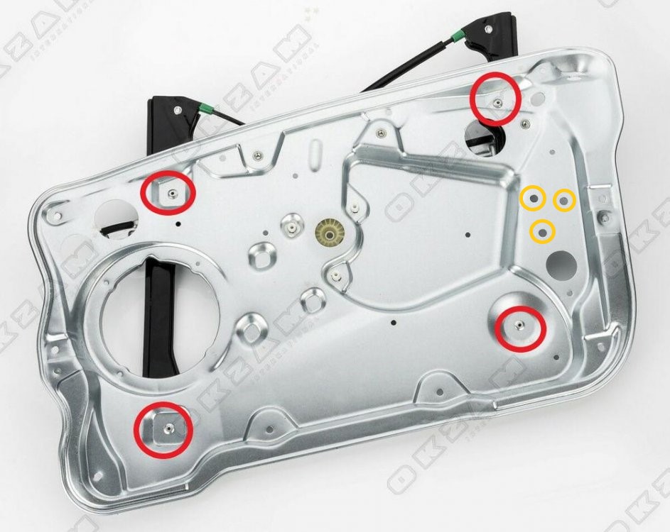

The official way is to remove the ancillaries carrier panel complete with the lock unit. This is where you would need to disturb the short bowden cable and outer door handle. However, it's perfectly possible to remove the ancillaries carrier panel without touching the lock unit or its short bowden cable. You need to drill out the three plastic rivets on the panel and this frees the plastic bracket from the lock unit and it can then be discarded as it will no longer be needed (put tape over the rivet holes afterwards). If the window is trapped in the bottom of the door you will also need to drill out the four regulator pop rivets in order to get the panel off.
Regulator rivets (red circles) and plastic rivet locations (yellow circles)....
