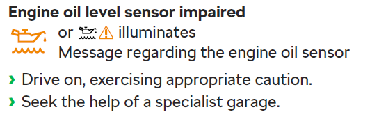

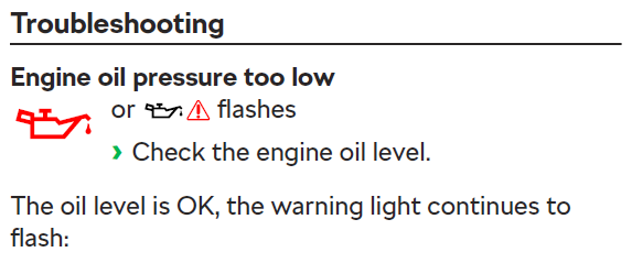

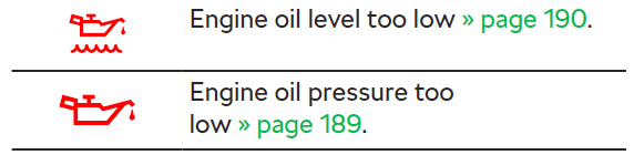

If it is the oil can symbol flashing, your oil pressure is low.
If it is an oil can with a wavy line below it is a level warning and will be accompanied by a message the oil level is too low, too high, or oil sensor fault.
Any chance that for your next post you can add something other than your username into the subject box, such as "Engine Oil Warning Light"?
Does this apply to both diesel and petrol cars ??
Yes...
