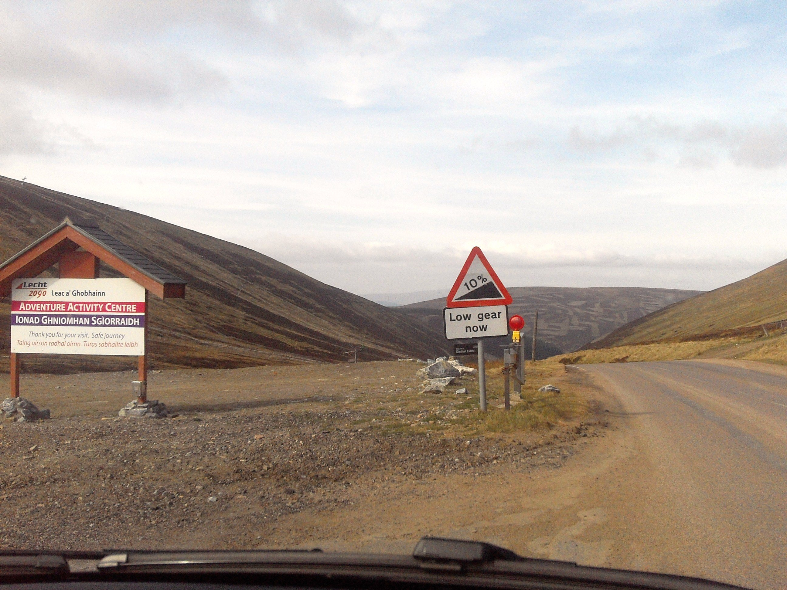

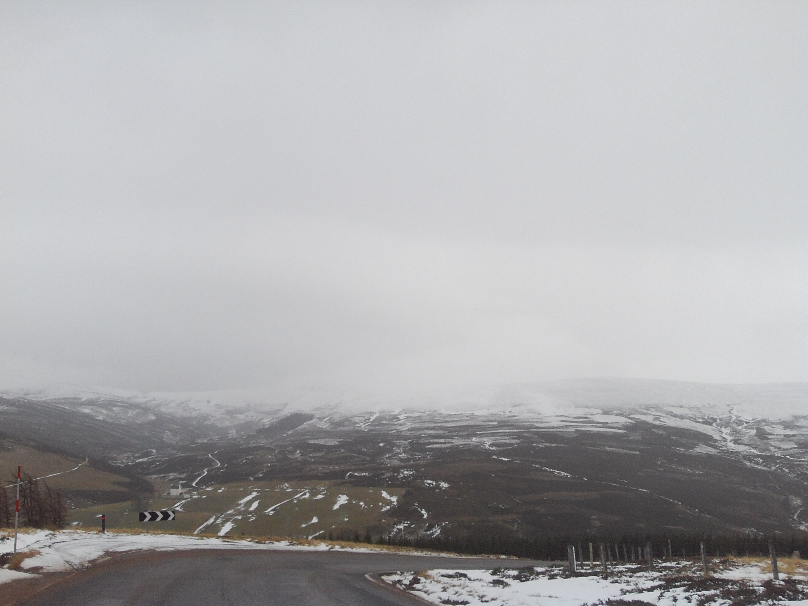

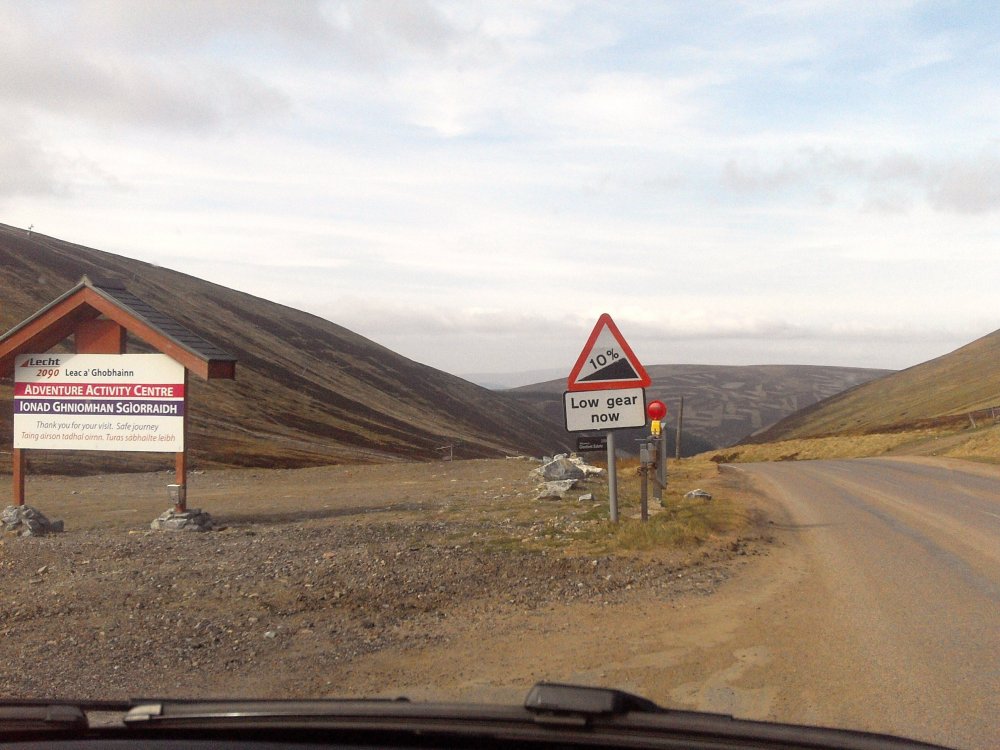

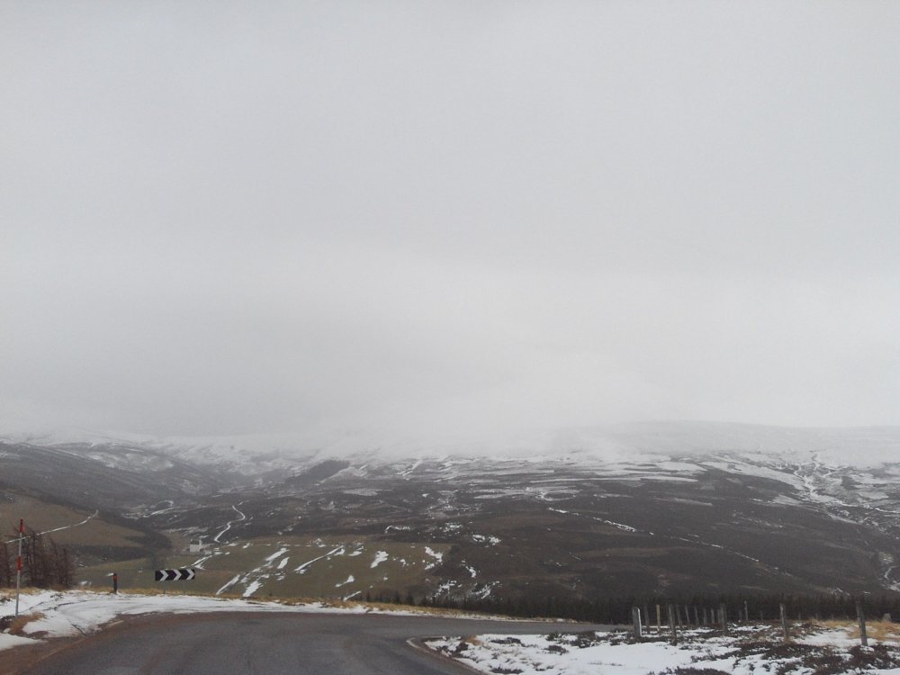

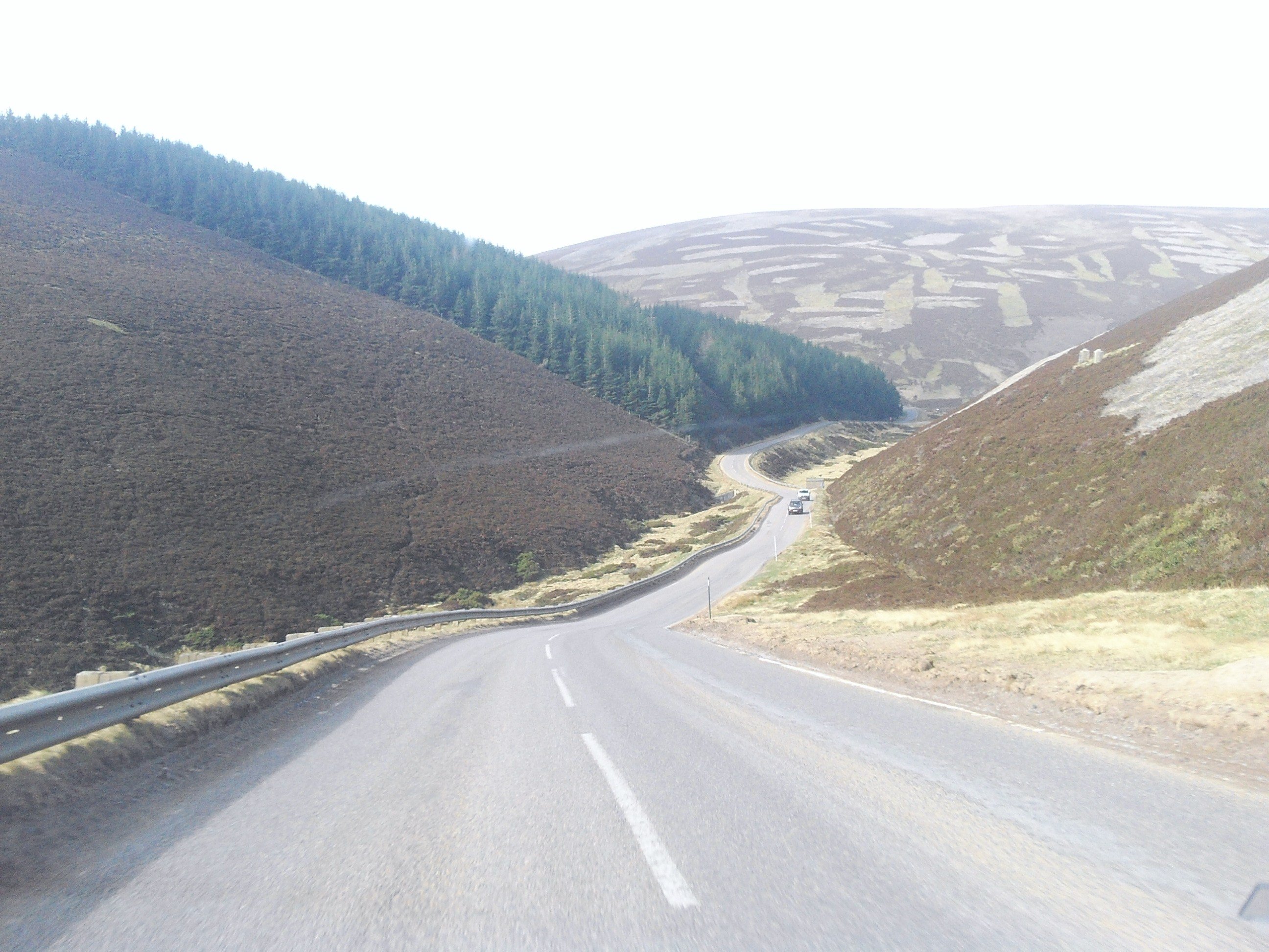

Thank goodness for a bit of engine braking when down down the south side.
Going north not needed.
