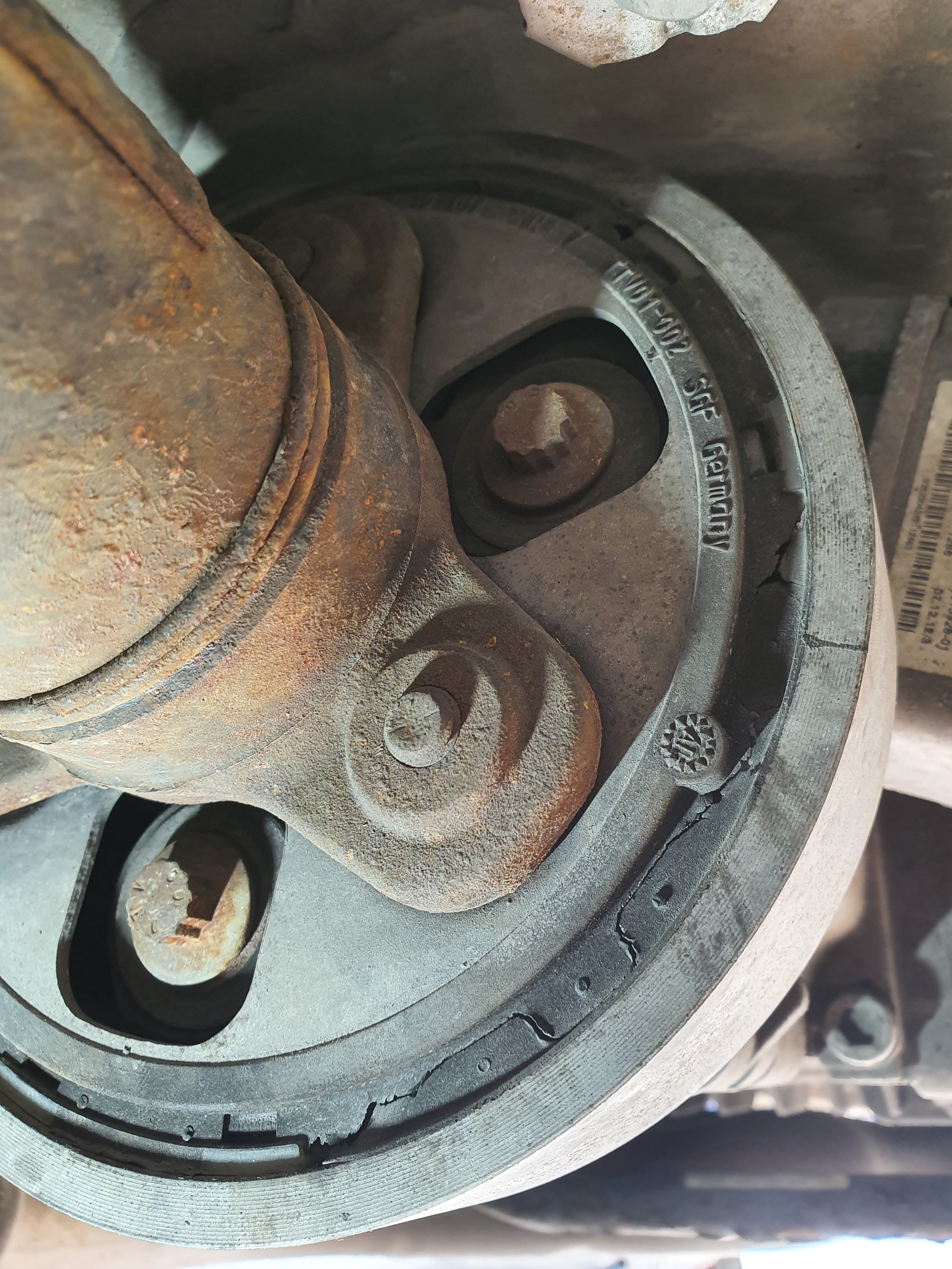

I have a 2013 estate 4x4 and when driving at speed can hear a loud whirring noise at the back of the car. Looked under the other day and saw the prop shaft bushing was badly worn. Has anyone replaced this before ? Big job? Also would that be the cause of the noise ?

Haldex was done recently .5k ago. Diff hasnt been done since I bought it. Just wondering would that perished bush cause a noise inside the car

Bearings seem ok. Serious head scratching going on here. Mechanic cant put his finger on it either. Does anyone have a how to for removing the prop shaft to replace that bush by any chance??
