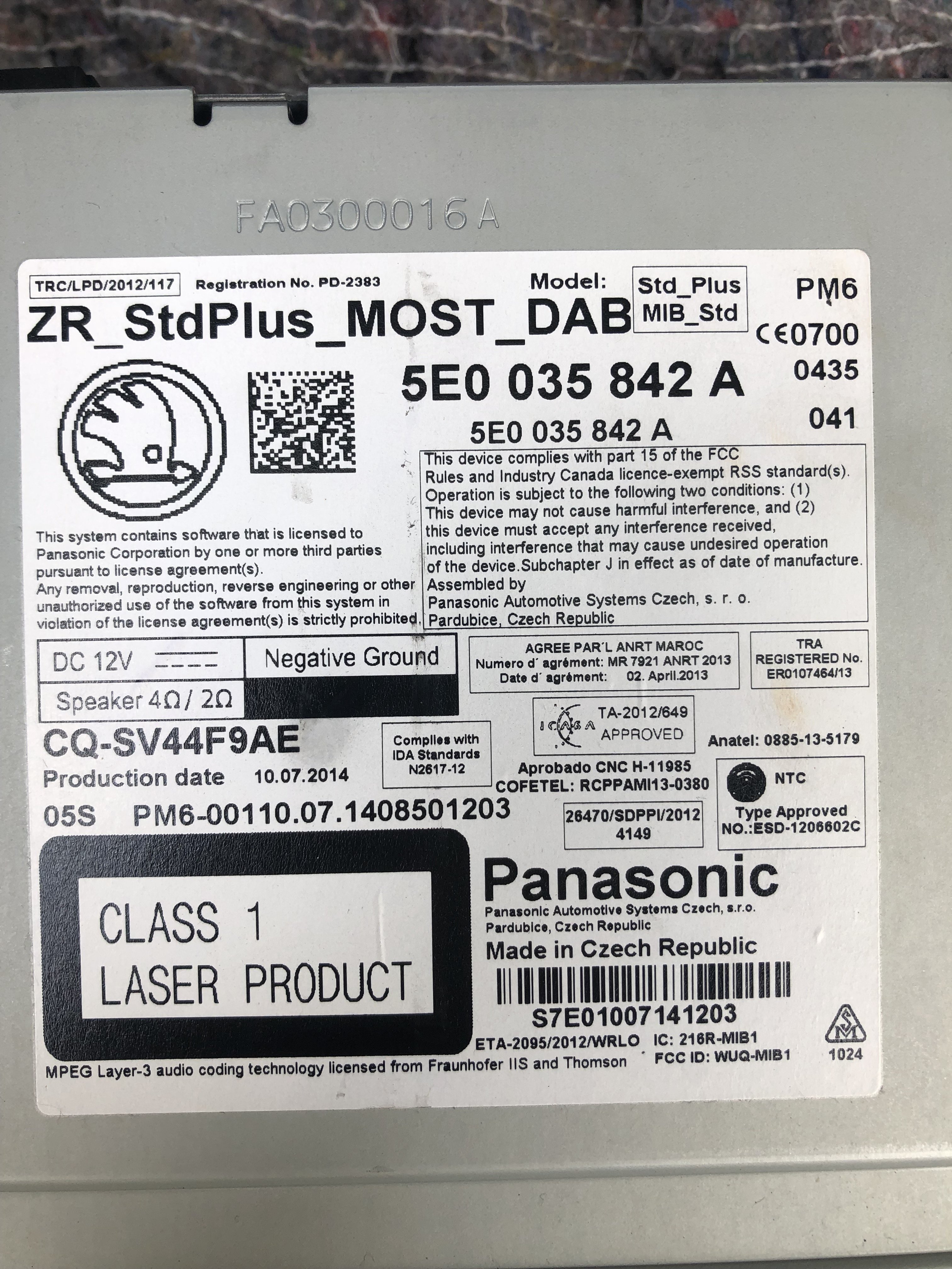

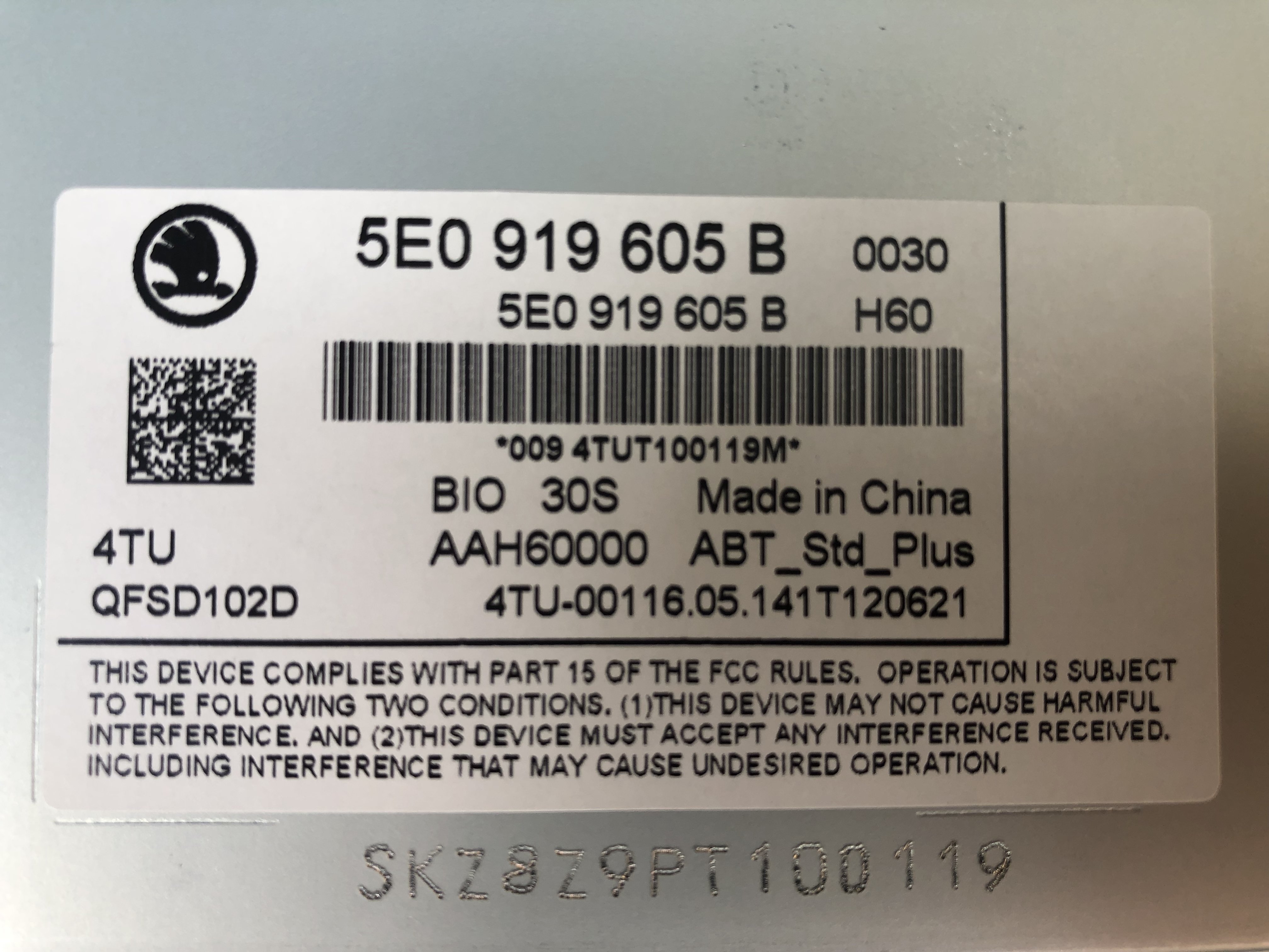

  • My head unit is part number 5E0035842A and screen is part number 5E0919605B (images attached) - what are these known as? Bolero, Amundsen, Columbus? These are terms I read frequently on this forum but I'm not sure of the difference...
  • What would people recommend as a replacement for the 5E0035842A head unit in an Octavia Mk3? I have an iPhone so would love CarPlay but not sure if that is possible, or affordable...
  • Is there any security coding etc that will stop a simple plug and play install of a head unit sourced online e.g eBay? If there is security coding/pairing, is it a DIY job to get around it or dealer?
