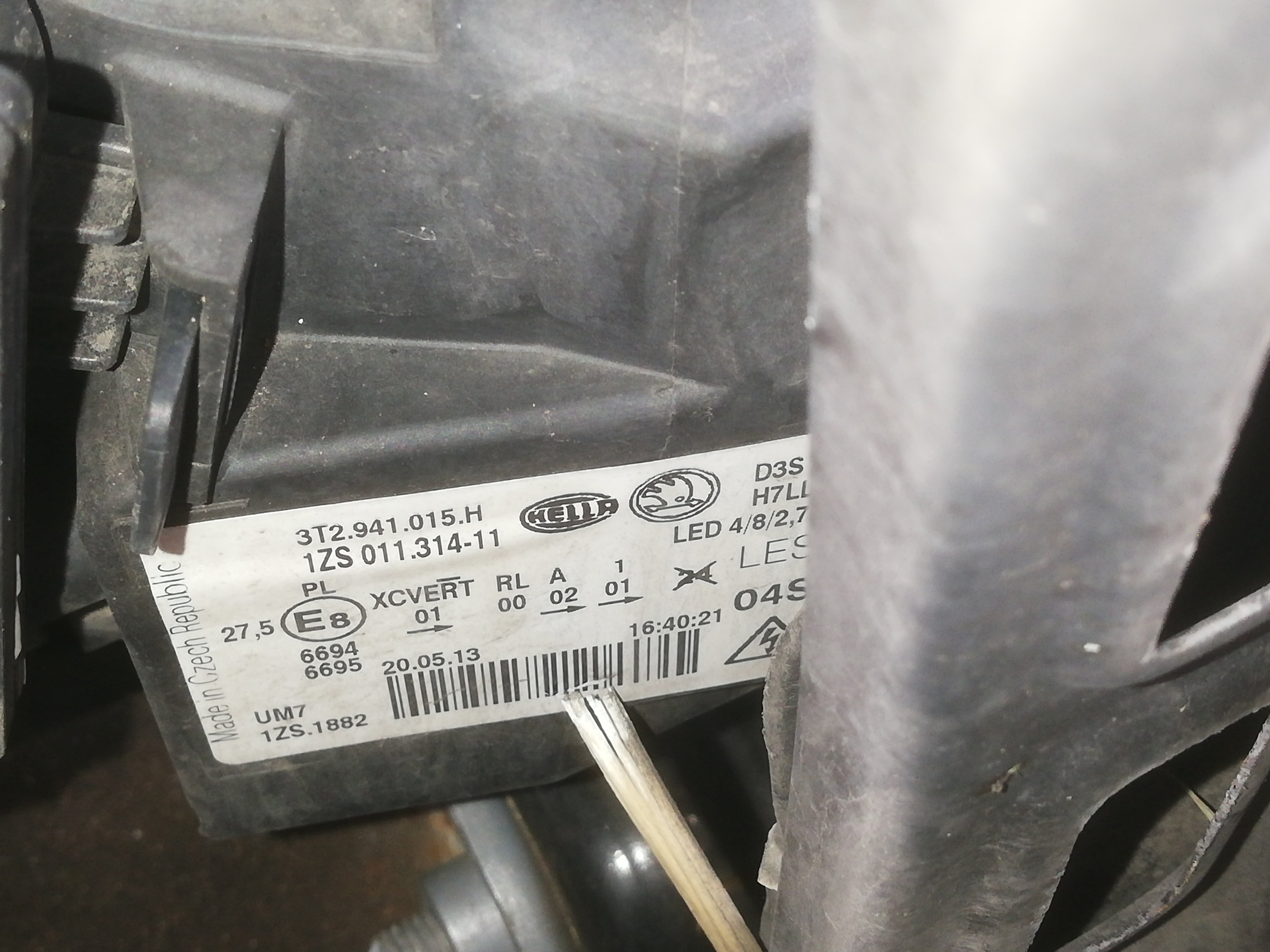

Thats what I have been told but the light that was removed was a led unit and i have a mk 2, the images below are of the headlamp

Pretty sure that's a bi-xenon headlight with an LED daytime running light :)

@langers2k is correct - the part number in your photo is for the Bi-xenon headlight. The LED reference refers to the fact it is the part that has an integrated LED DRL.   It is the same as the headlight unit fitted to my 2014 Superb 2 estate facelift car (which is what your car is).
In any case, the answer to what @silver1011 asked is definitely that you have the bi-xenon headlight units.

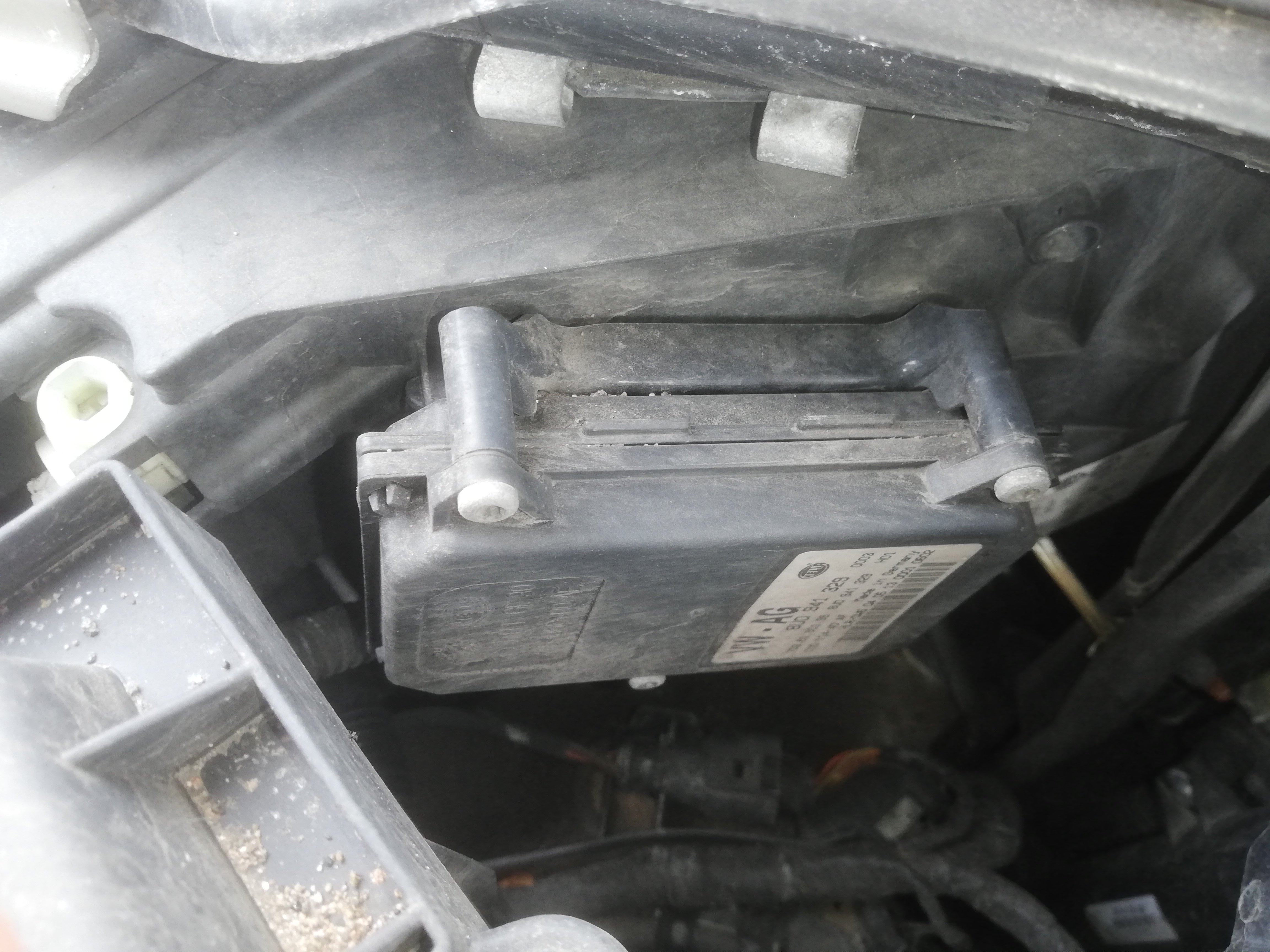

When you say that the LED was failing - do you mean just the daytime running lights (DRL) part of the headlight? Is the part in your second picture the part that was replaced?
