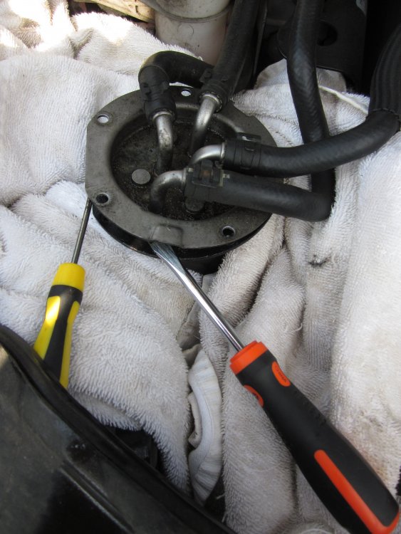

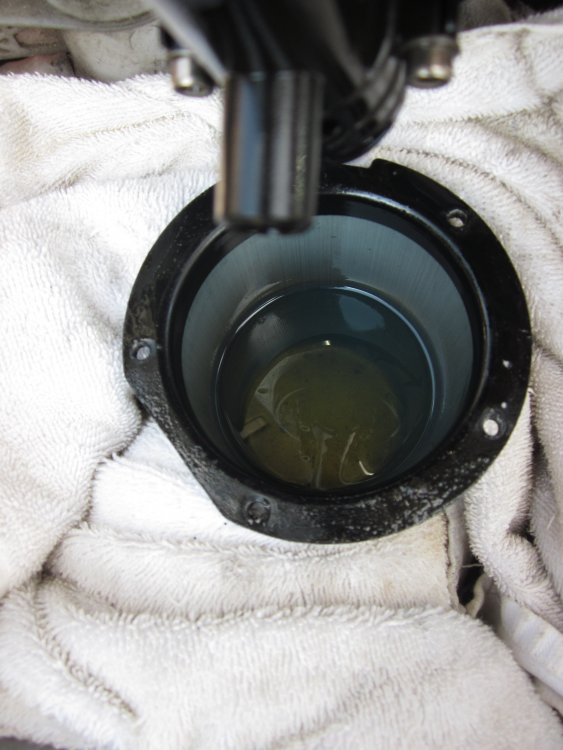

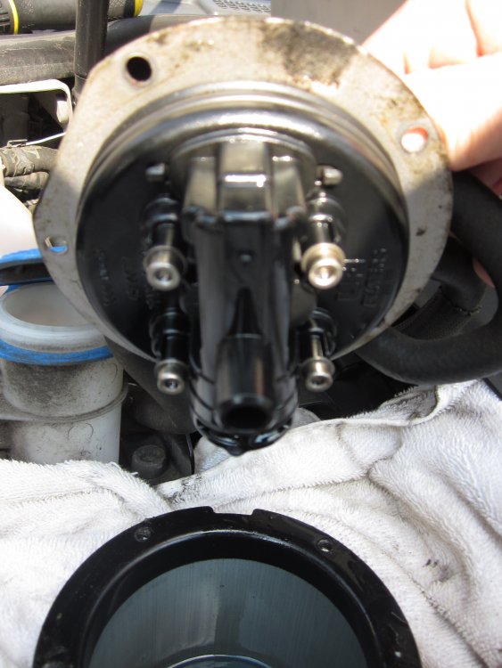

I'd suggest taking it back to the garage that serviced it and get them to fix it at their cost! A ham-fisted mechanic can warp/damage the fuel filter lid by prying it off with a screwdriver. I assume this is what has happened?
As above, there are only three ways a fuel filter housing can leak...
1) Corrosion, usually the lid, as it is recessed and can hold water.
2) Leaking fuel hoses that enter and exit the housing via outlets and inlets on the lid. The hoses can perish and split, the clips, if removed or knocked can loosen and let fuel escape.
But by far the most common problem, as mentioned above...
3) Some ham-fisted mechanic has bent the lid when trying to remove it OR not renewed / damaged the o-ring. The lid is well sealed for obvious reasons, and over time the seal can become very comfortable, making the lid removal very stubborn. So, you have to be extremely careful when levering it off, take your time and lift it in increments around it's full circumference. All fuel filters also come with a brand new o-ring...
When replacing the screws alternate from opposite sides to ensure the lid is tightened evenly...
Take a look down the side of your fuel filter housing, there should be a part number on there...
