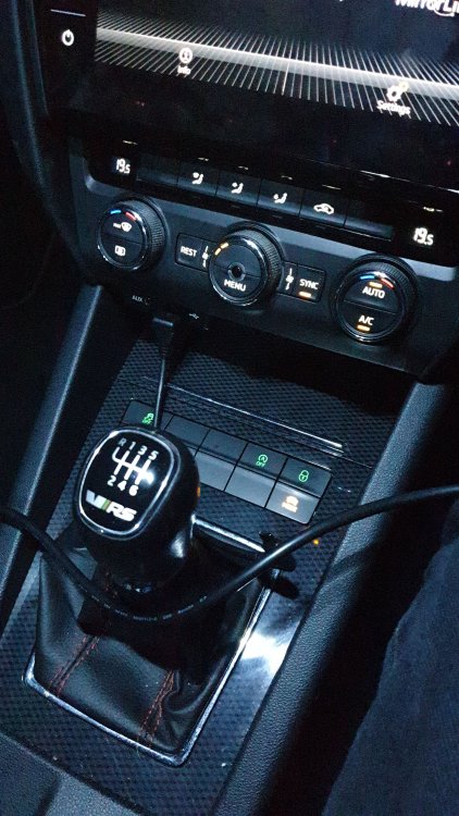

Got it working, just don't understand why I got it working.
Read on a forum where someone couldn't get his AC on after swapping the panel, and solved it by pressing AC and Demist at the same time for a few seconds. Did the same, and it worked. And the Run AC Compressor Run In fault code went away.
Now I did read that there is a way of coding the AC by pressing the buttons, but really not sure why it solved my problem. Just glad I did. Looks a lot better with white dials.
