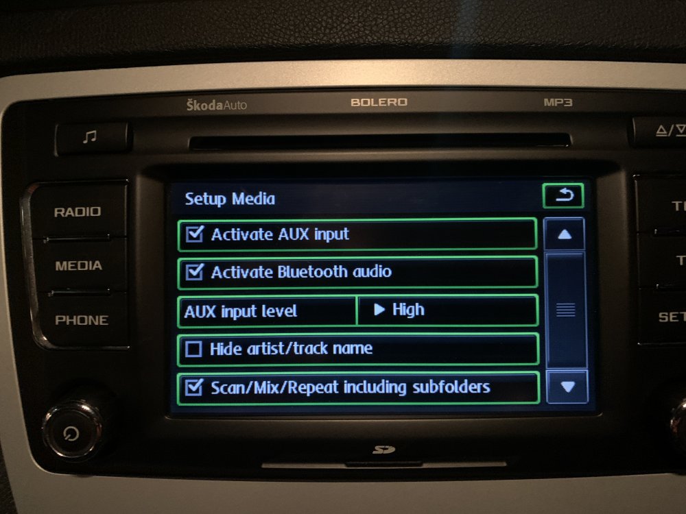

I’m having a similar issue.
when I go into the settings I can tick to “allow Bluetooth” but I still can’t connect to it!
would it show that option if the module wasn’t installed?
No box under the drivers seat, no Bluetooth...
The Bolero did not get Bluetooth as standard, so if you have it then it was added as a factory option or someone has retrofitted it.
Some people locate the module in the dash end panel with the fuse box, be sure to check there too.
A lot of people now have access to App based diagnostics, it is possible a previous owner enabled Bluetooth in the hope it would work (hence the listing in the on-screen menu) but didn't install the module and microphone.

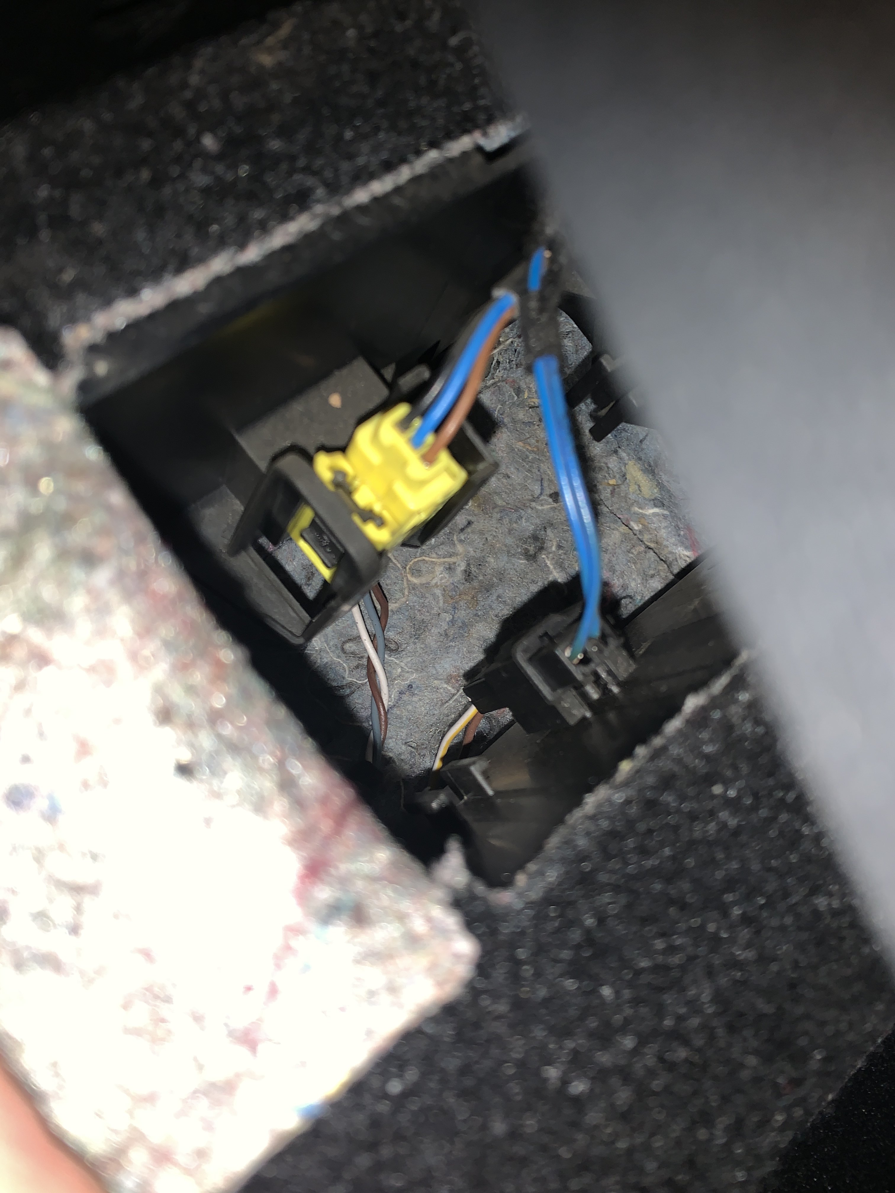

Thanks!
nothing under the drivers seat except for some plugs under a flap but they are there on the passenger side too.
anywhere else it might be than under the seat?
See above...
