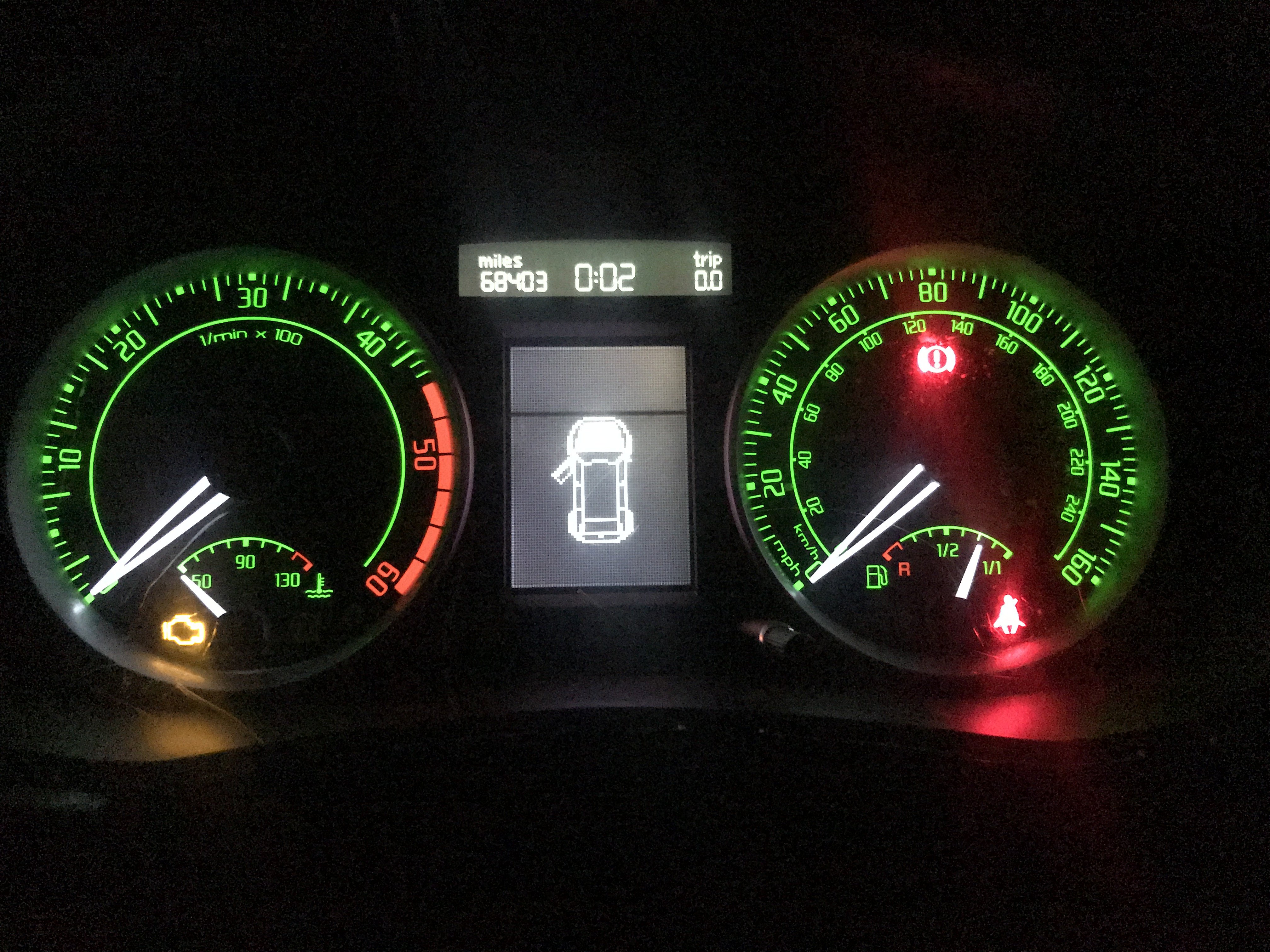

I’m still looking for the door fault after replacing the door micro switch and the loom hasn’t cured it.  Then, after taking out the instrument cluster, I’ve now discovered that previous owner has been in there and purposely disabled the speaker as well as removing a couple of bulbs (door open indicator and heater plug/fault light indicator) and supergluing it back together!
I’ve picked up a replacement cluster, an early maxidot unit with the same two plugs, but after fitting it discovered it isn’t as straight forward as it used to be to code them in.
I’ve tried a search on Google and the forums but couldn’t pull much info up. Does anyone know If it’s possible to pull the pin from these clusters or get it to recognise keys without having an original? What software or hardware is required?

The replacement cluster I picked up is a Fabia unit but it’s a straight fit into the Roomster. I need to change the cluster pin to match my old one but I can’t do it with my usual software, VCDS and Vag Commander 3.6. I can read the pin from the engine ECU for my original one but I need the pin for the replacement cluster, I don’t have the ECU for that one.
