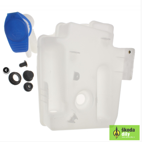

Here is a Yeti washer bottle and associated components...
You can have a search through this website and see if you recognise the parts you need, or better still post up some pictures of the damaged parts...

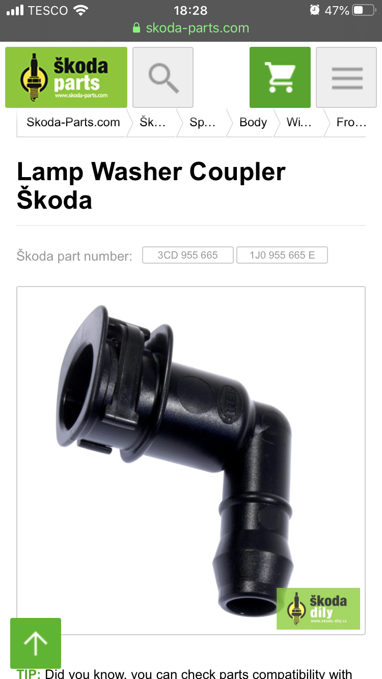

Your link was very helpful. I tried fixing this again today. It’s the lamp washer coupler which is where the leak is coming from. I replace the o-ring and clip but it still leaks, or though less so.
The clip in the attached link/image is the other way up to how I was attaching it, although if you do a google search for it there are images with it both ways. Maybe that’s the issue. I will have another look tomorrow.
