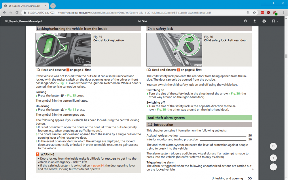

The way I operate (not private hire etc 😉 ) I'm more and more ticked by the INABILITY to unlock all doors in my car from inside. I've checked both all options in computer settings as well as went over the relevant section in manual.
How do I unlock the doors for my wife, whom I just arrived to pick up and continue drive, without either opening driver doors (literally cracking them open) or switching engine off and pulling the key from ignition? Locking - including auto - is fine. it's the unlock that's killing me.

If autolock locks the doors and you stop to pick someone up, that button should unlock the doors without you needing to turn the engine off etc.
At a guess, it sounds like you might have a faulty unlock button. Might be worth removing it to take apart and clean or replace :)

Or the door wiring harness has cracked.
Have you leaned over and tried the passenger side unlock switch?
If this works then as above door wiring harness
Loads of posts on here about it 😎
Also why not switch of auto lock the now till you get it fixed
