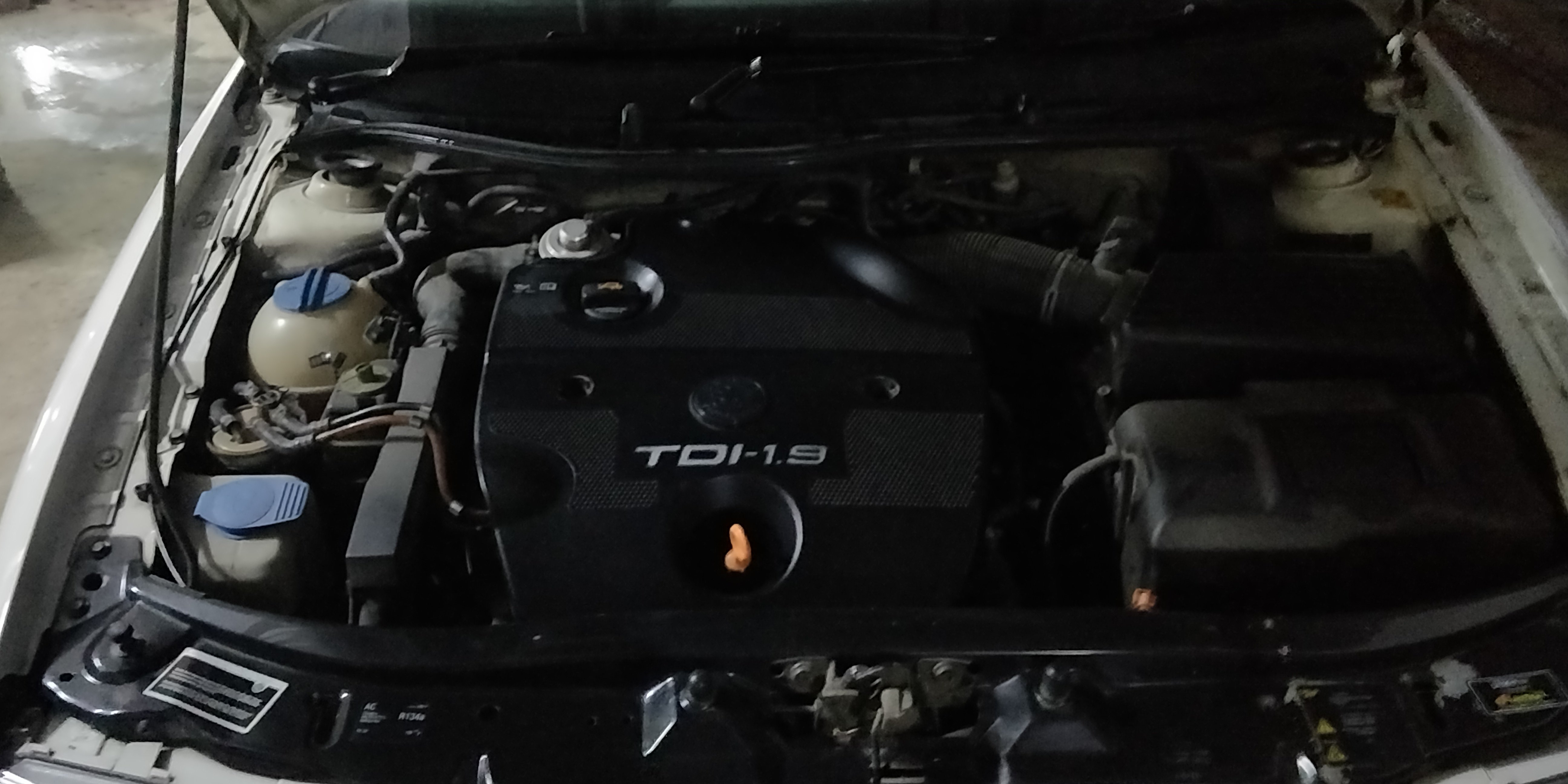

Need help with my Octavia mk1
Someone put the terminals wrong way on my octavia, now it is not charging the battery and also the windows and the stereo isn't working. Any clues what could have gone wrong?
Putting the terminals the wrong way round has killed your alternator and likely causing the other issues.
