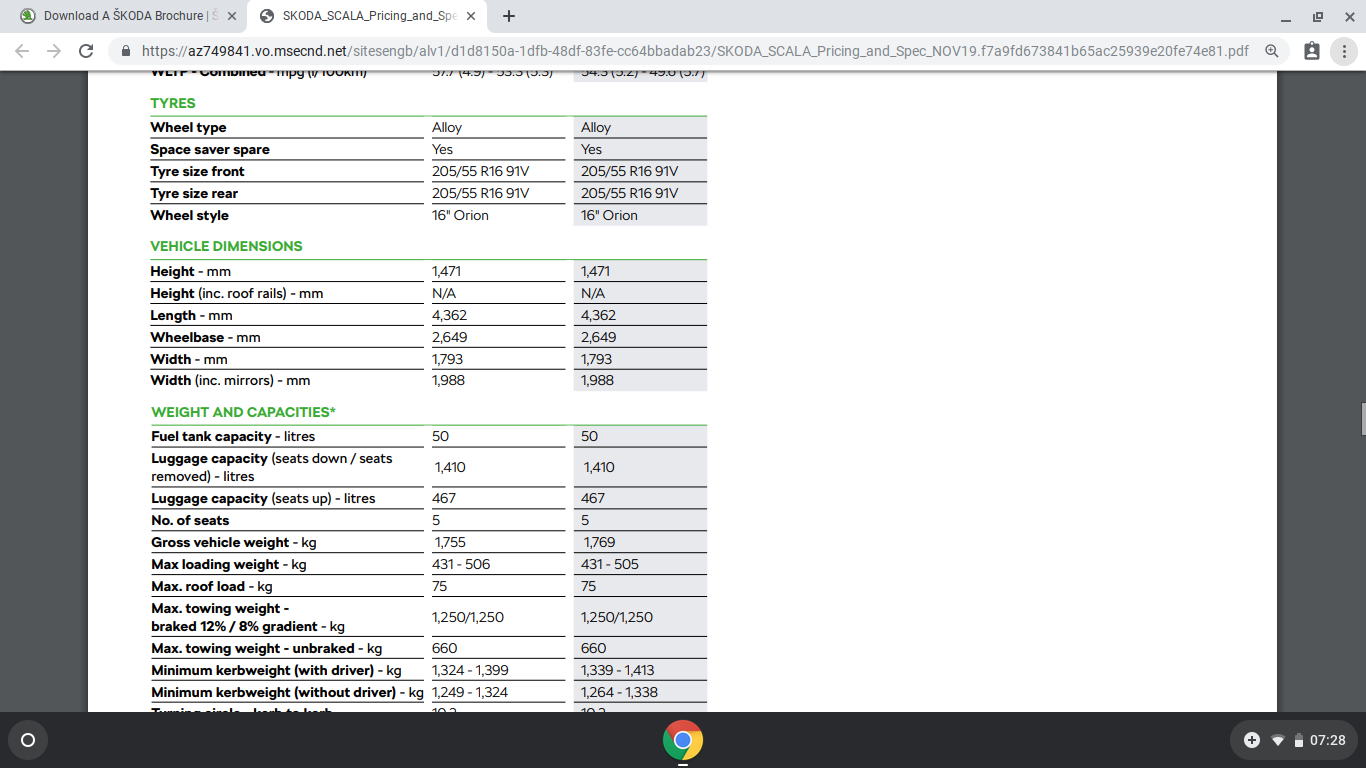

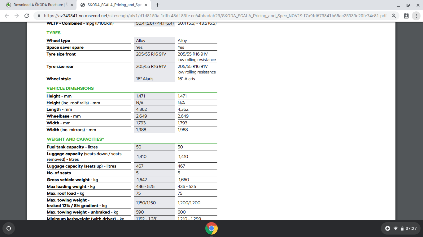

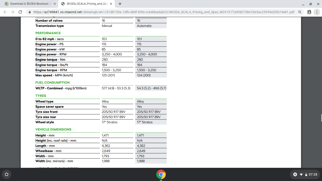

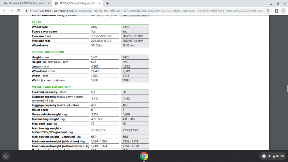

@Carlston
Which country have you seen 195/60 R16 as an option on a Scala?
It is not an option in the UK that i have seen.

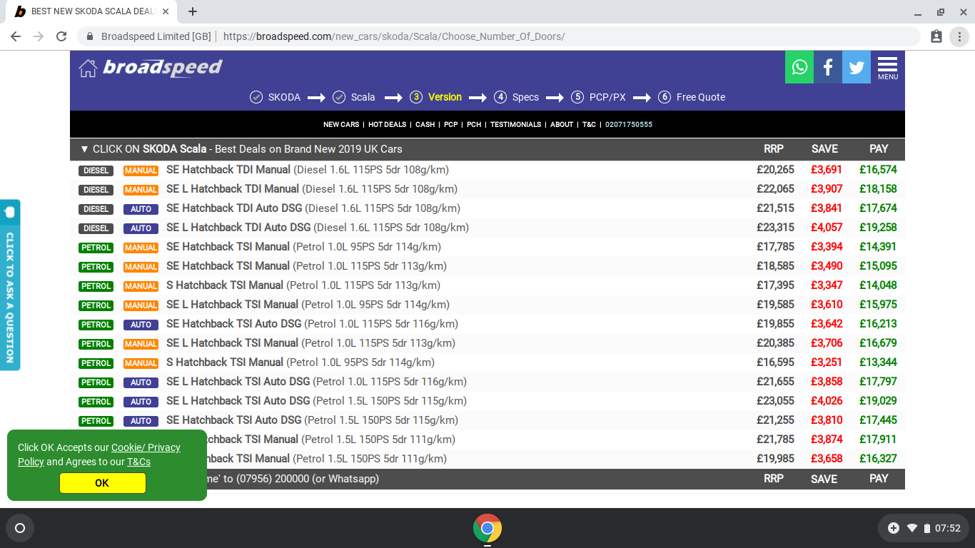

Starting @ under £14,000 about the right price for them.
