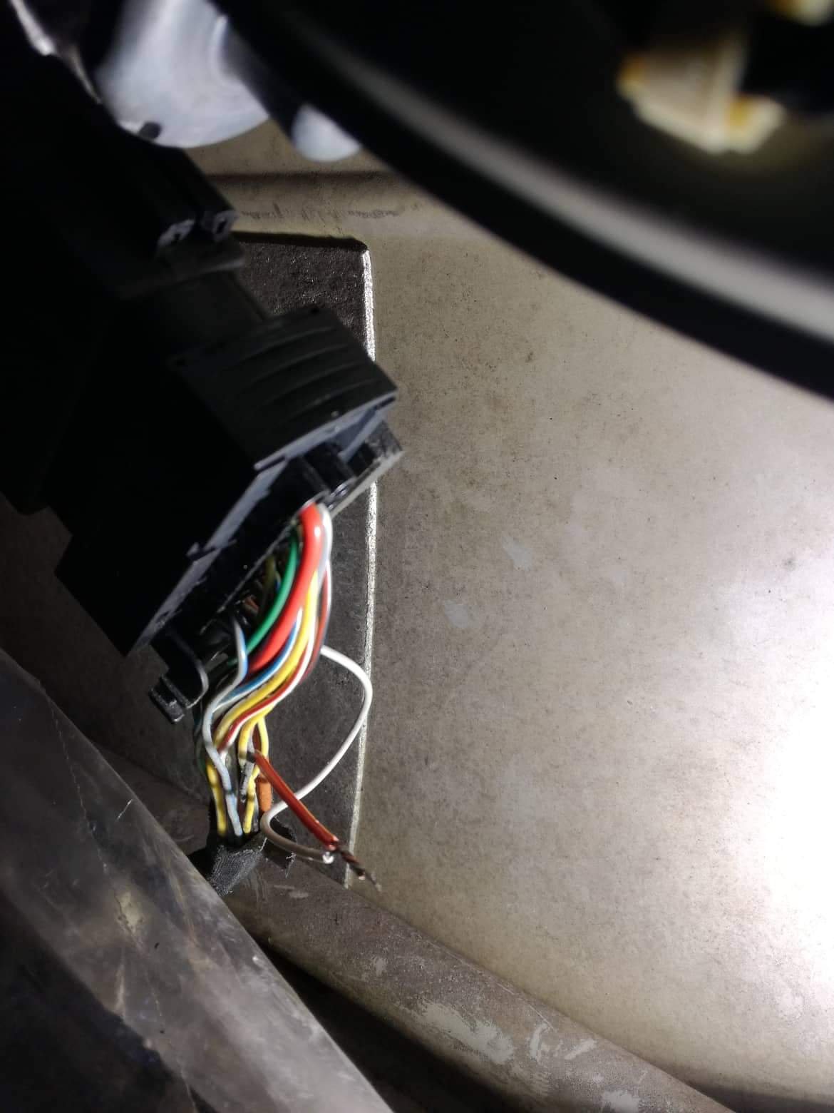

I had the same problema on the right front door, The electricion found that the window regulator motor is bad. He rewired the connector (like in photo).

Would you recommend contacting an electrician then?  My Driver door Central Locking doesnt work, but the key in the door does.

I had to lock door from interior to lock it (push the pin in), and them I had to pull the handle from inside to unlock it. If you will contact an electrician, I think he will find the problem, and it wont be just our guesses.
