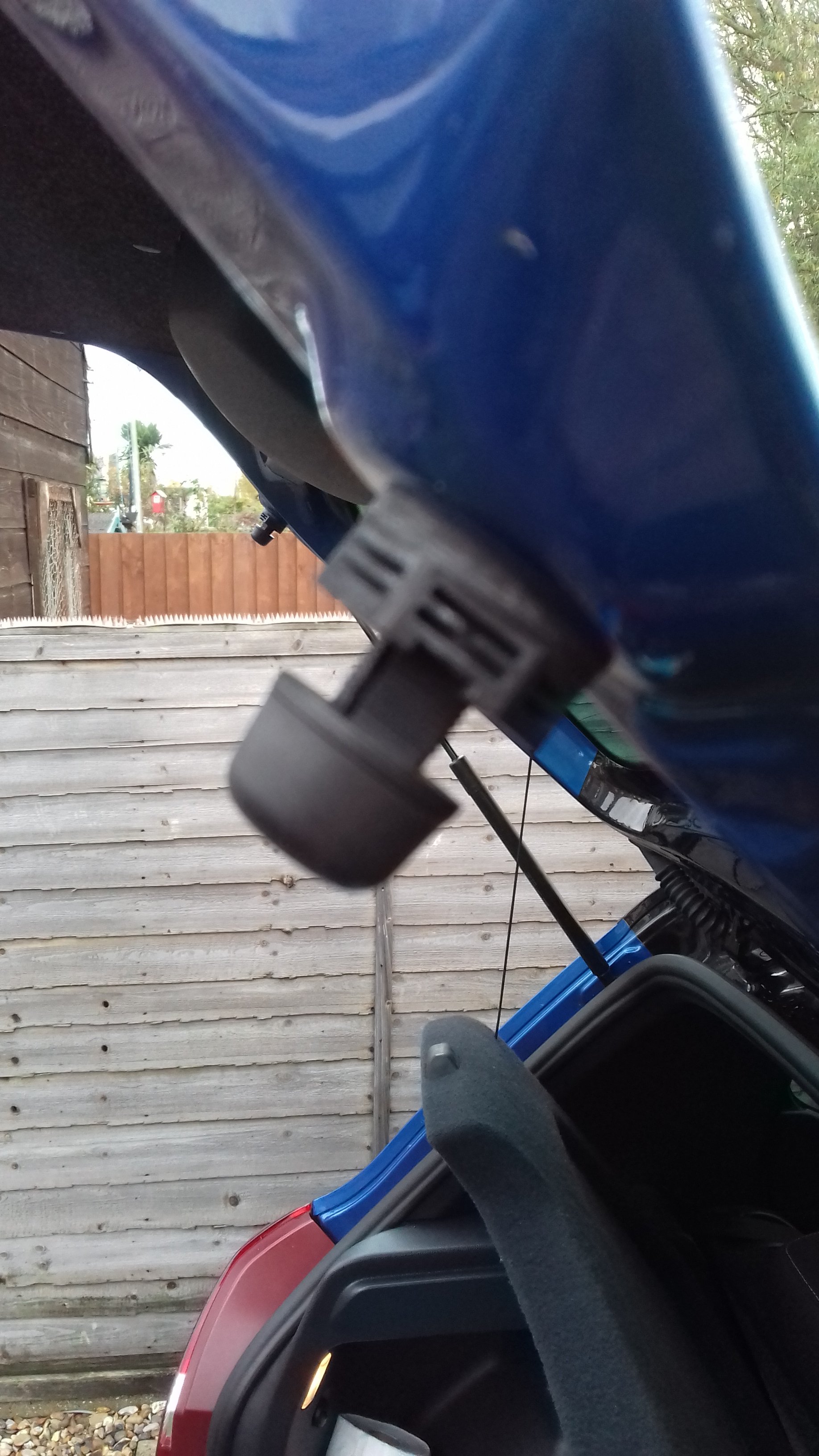

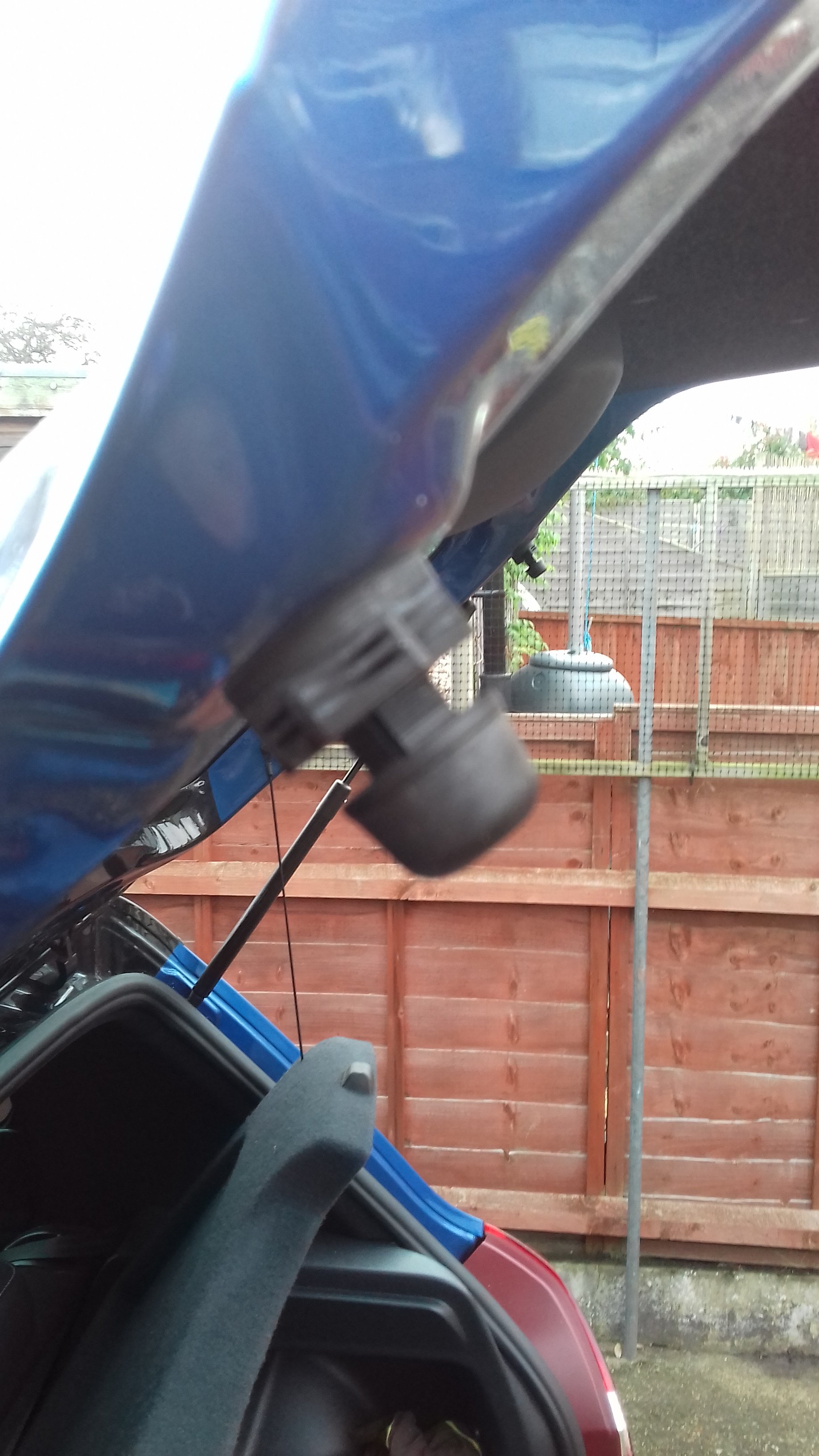

i don't know what the techinical name is for them but only just realised there are two of those rubber butt type things just above the rear lights attached to  the inside of the tail gate. One side  is extended out quite far, however the one on the side of the tailgate with the  issue is considerable less extended, so less cushion on that side when its shut, so first job is to extend that so its the same as the other side....trouble is can't figure out how its done

They don't twist, but must be adjustable with one being longert than the other, i think the difference can be seen on the photos

So got this problem sorted with a somewhat easy fix in the end.  Thought id share as i see other users have had similar problems. There is an allen key screw in the centre of the plastic bit. Once that is unscrewed it comes away from the bootlid and it can then be adjusted.
