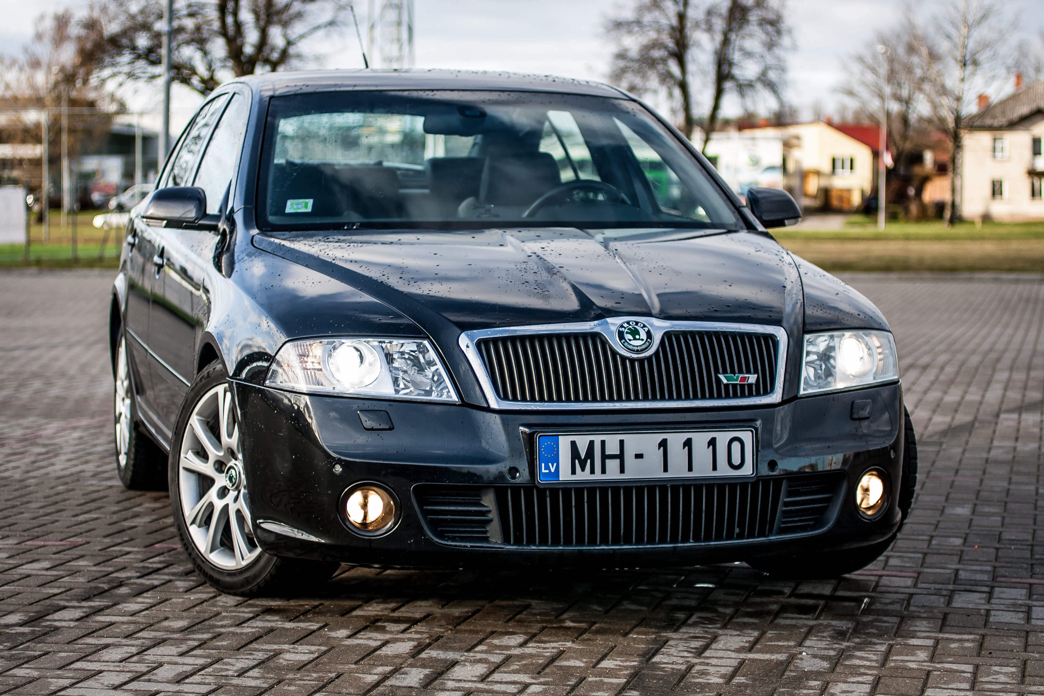

Hey there! ✌️

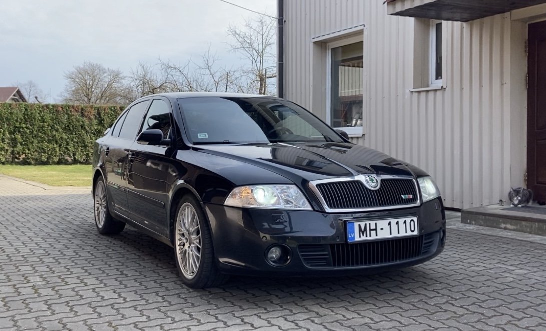

Meet my 2007 Skoda Octavia VRS. 140k km milage and looks daaam fresh!
Bought it few weeks ago and I’m planing to keep it for atleast 5 years.
Bought it without front bumper side grills and at the beggining I thought it will be pretty hard to find these grills. Why? Because at my friends partshop wasn’t possible to get the original grills. Using part nr. I got facelift stock grills. But then I found superskoda and got these grills really cheap.
Another thing that I did in these few weeks was fresh badge instal.
I’m planing to make this whip nicely stanced. Static, no bags. 😂
That’s for now. 😊
Some pics!

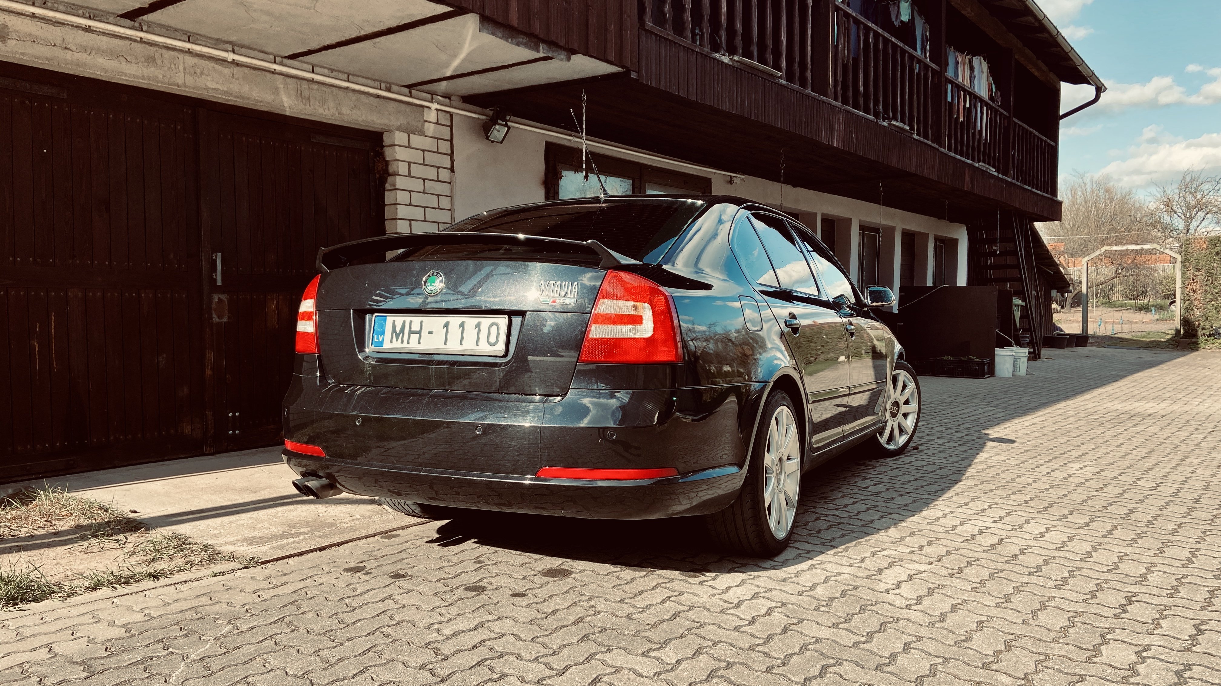

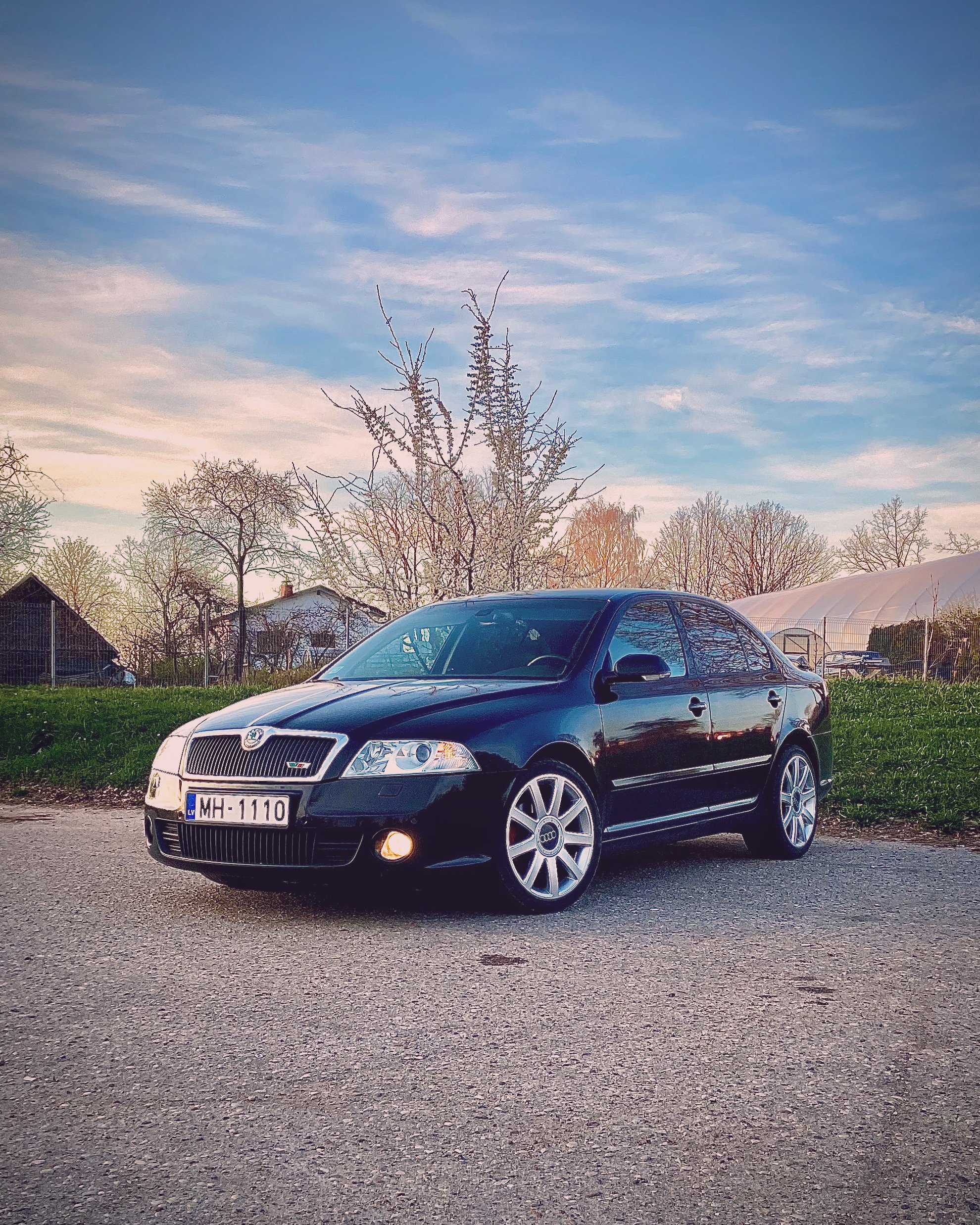

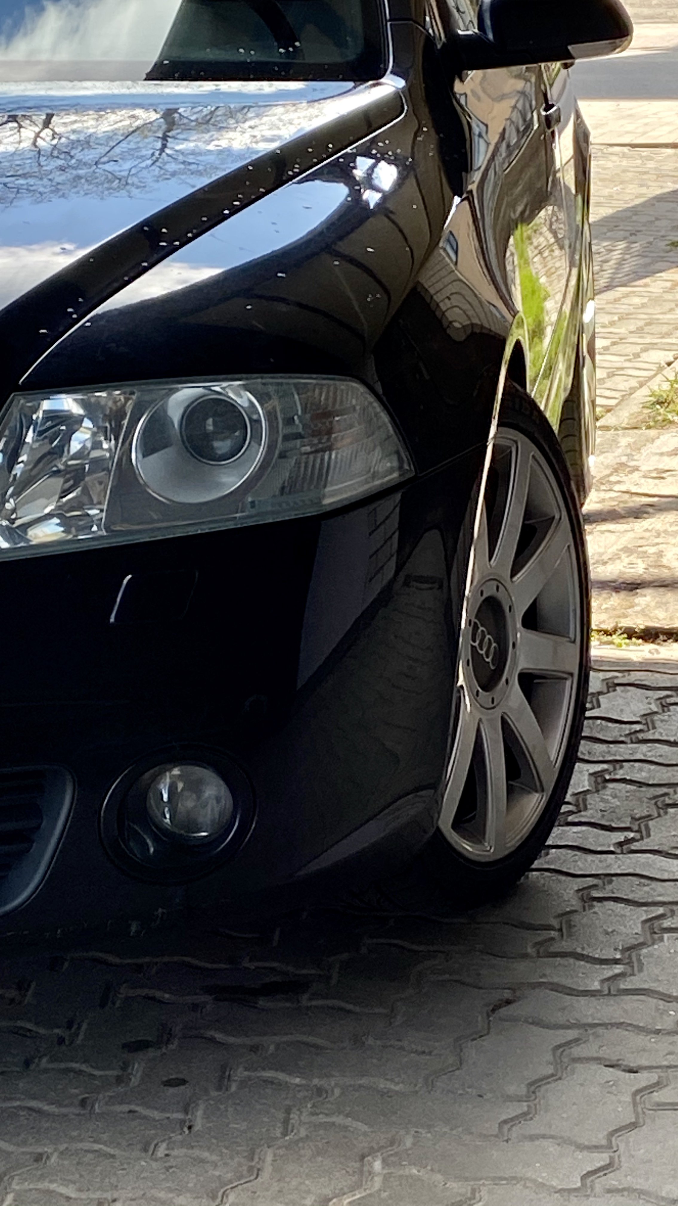

3rd one:
Got rid of those BBS, and bought Audi S-line rims. 18”, 8J and ET43. Great condition and looks great in my taste. :)
53BC2FCB-8824-42A5-80FF-41D9E99E97F4.thumb.jpeg.19e4d8b60ac64210f8a5f668b03684de.jpeg918CC728-7099-4084-81E4-CABC4CD65E1B.thumb.jpeg.0874a06635042155a425f34fae6b168f.jpeg

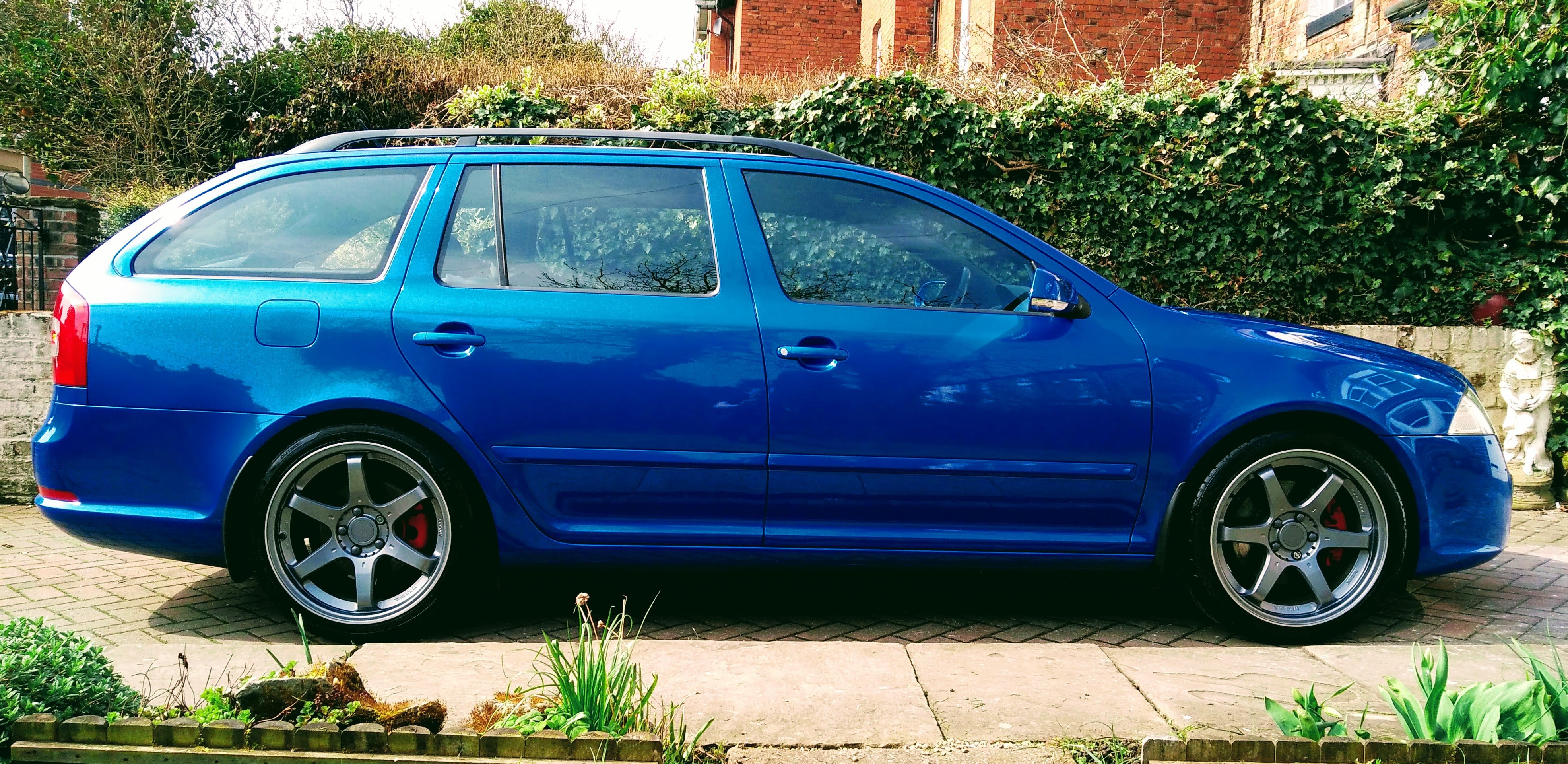

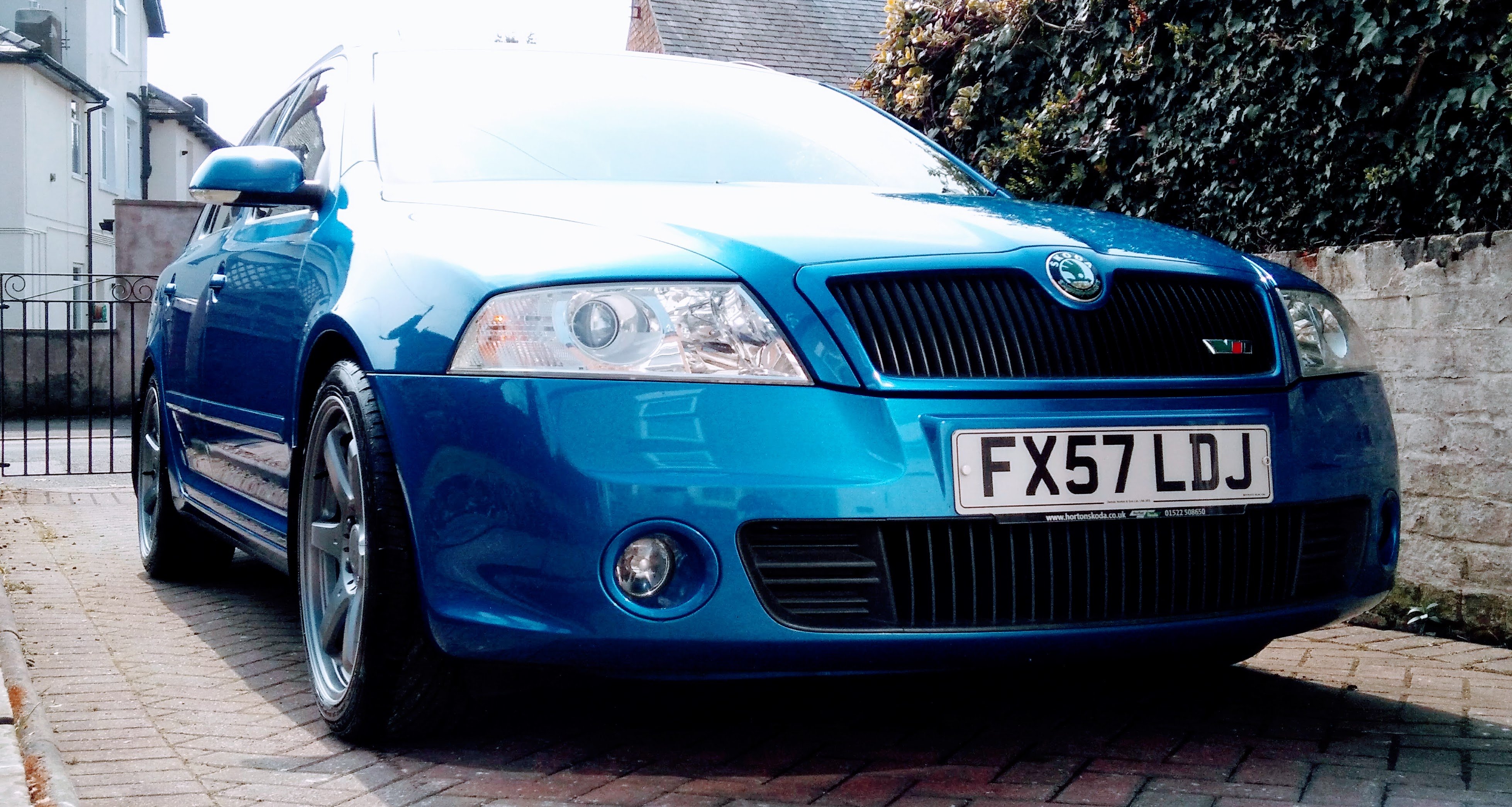

I noticed you were talking about coilovers.  Some people love them and some don't.  I've had cars with them on and have never bonded with them really.  Admittedly, my last set were extremely hard and although the handling on smooth tarmac was amazing, they were really for track use.  In the real world I couldn't make as much progress as on the standard setup on bumpy B roads because I was bouncing off line mid corner.

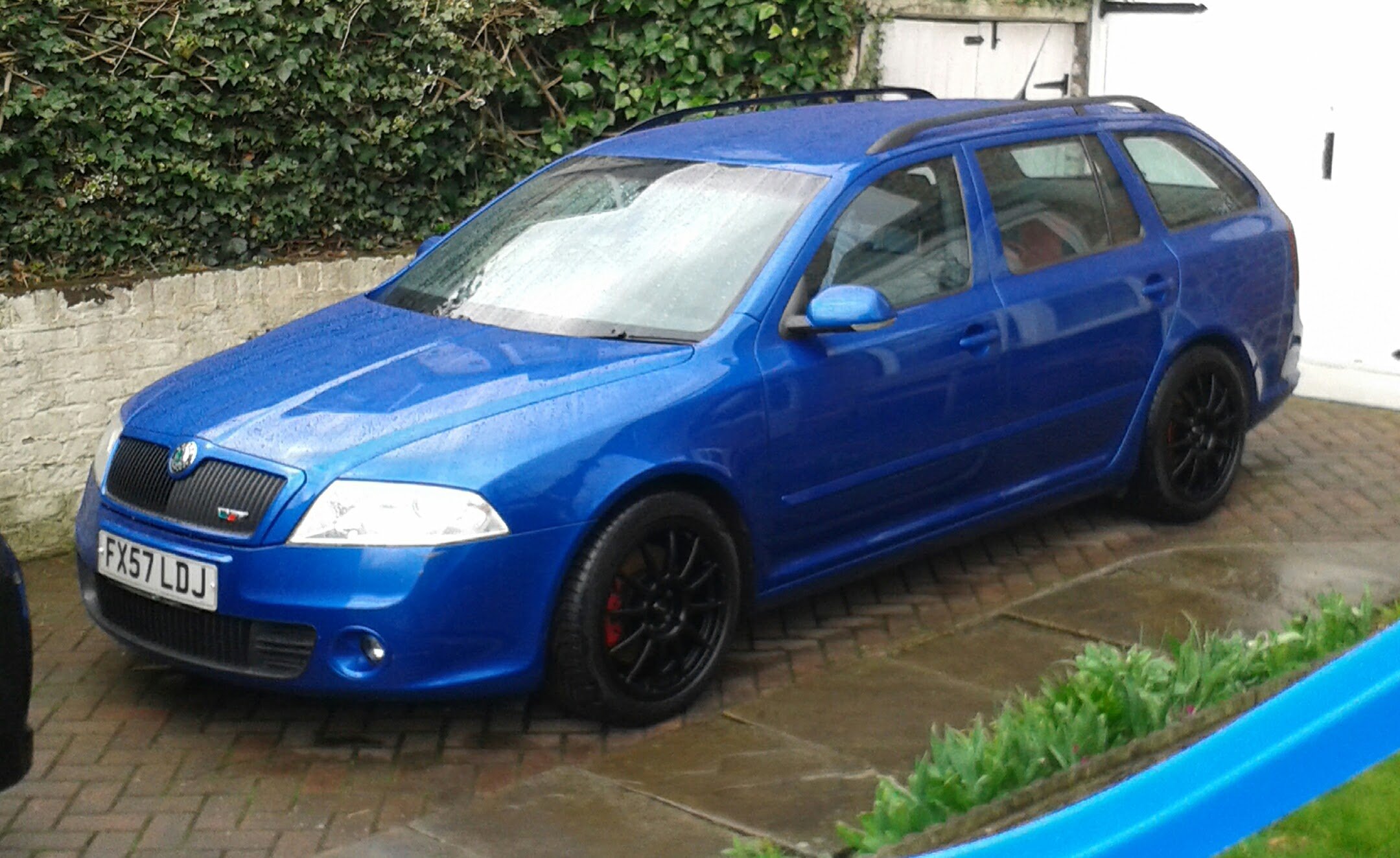

Have you considered some decent lowering springs and new shocks?  When I had my Mk2 Octavia, I used Eibach Sportline springs and Bilstein dampers and found the setup to be just about right for road use.  By the sound of it, coilovers would shake the car to bits on your roads so you might need something with a bit of give and compliance.
I've put a couple of photos to show how the car sat on the Eibach springs with both 17" and 18" wheels on.
My current car has a similar setup and it works well as a compromise for daily use, although that's a Mk1.

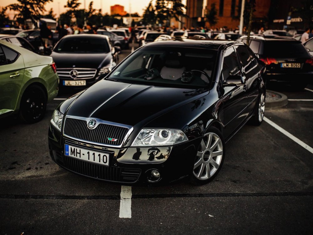

*I was at CC Nation season opening, was totally good event, which can’t be missed. 🤟🏼
My current plans are to new spark plugs (just in case) and to build up exhaust system. The muffler is quite rusty and whole pipe also. As I like the sounds of Magnaflow, I will probably choose this brand. And another one is to chech turbo system, few wet spots, don’t know why, I hope that everything will be possible in closest future.
Picture from CC Nation season opening 2020.

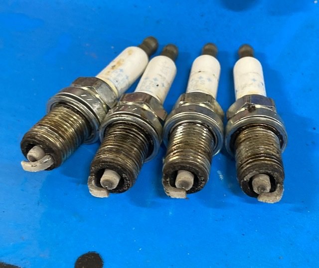

*Changed spark plugs to new Bosch Dual Platinum. I was shocked. Omg. 🤦🏻‍♂️ At least I feel safe now. Last owner didn’t change them and I was like whoaaat?!? 🥶
*Measured exhaust pipes and end muffler. Planing to order Magnaflow universal stainless steel muffler 4”x9”. And grab the necessary stainless steel pipes for ‘catalytic converter>end muffler’ part. Hope that it will sound deep and not so loud. 😬
Check out the spark plugs 😂😂

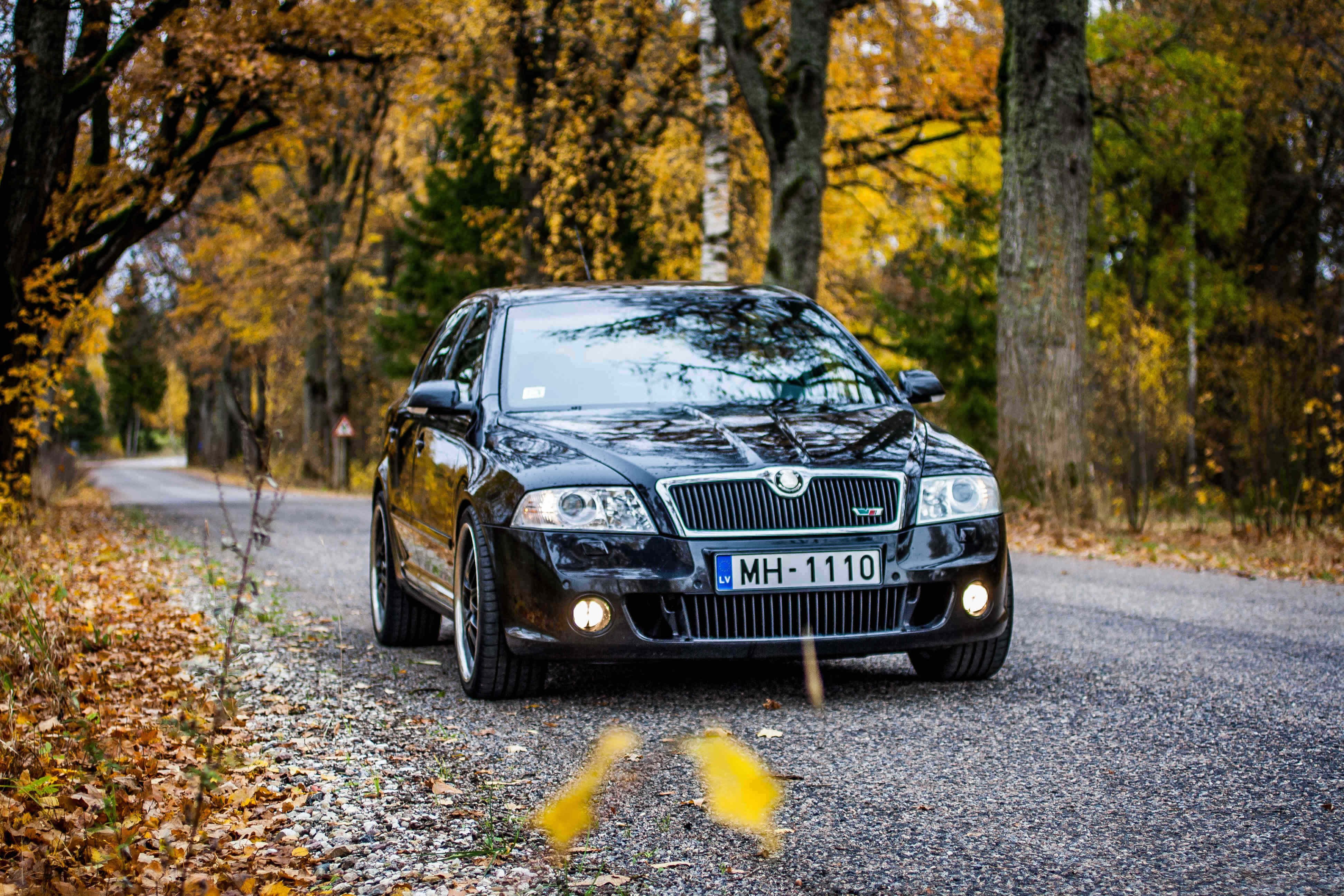

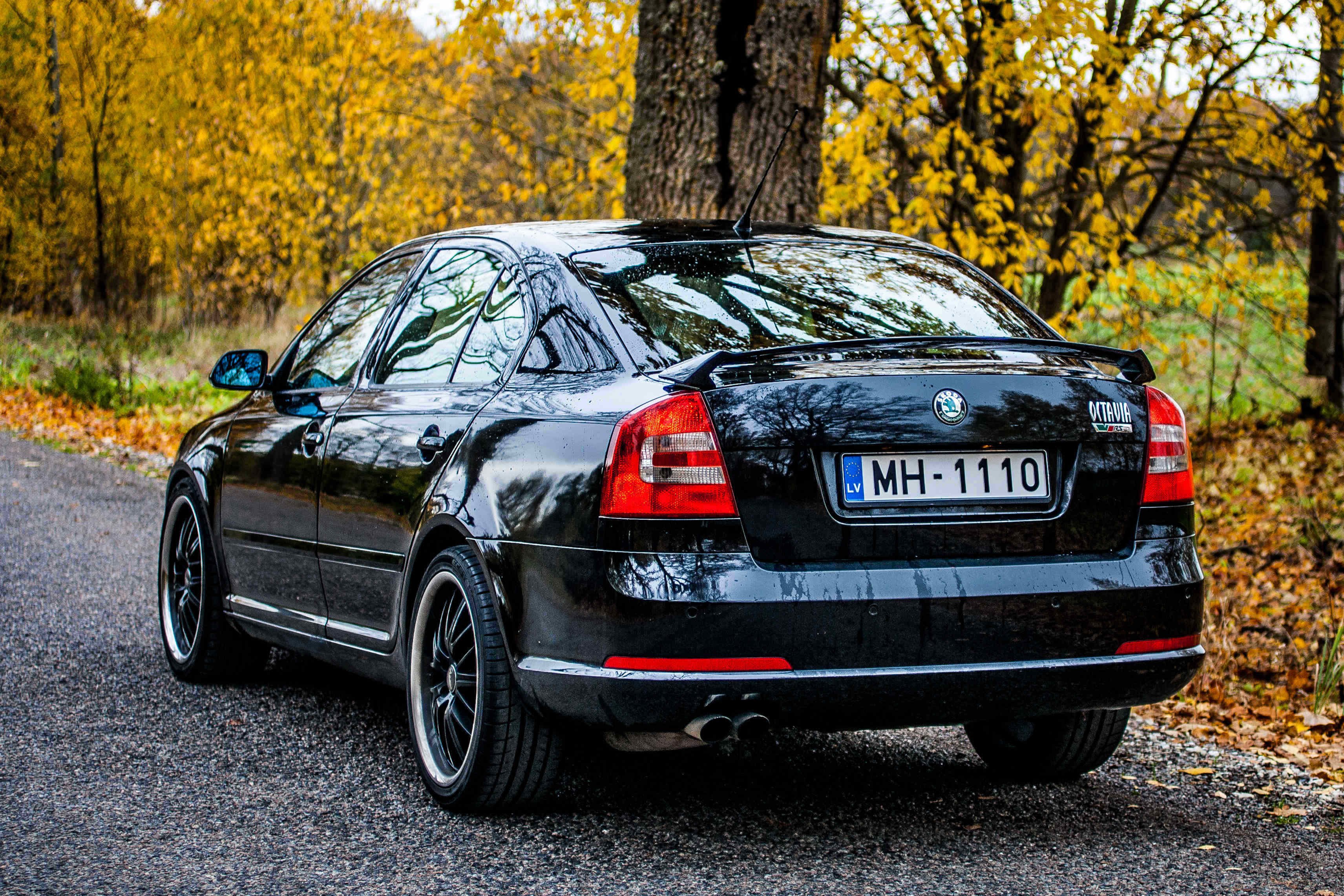

Here are some pictures from Autumn and beginning of winter and of course the wheels preview. :)
