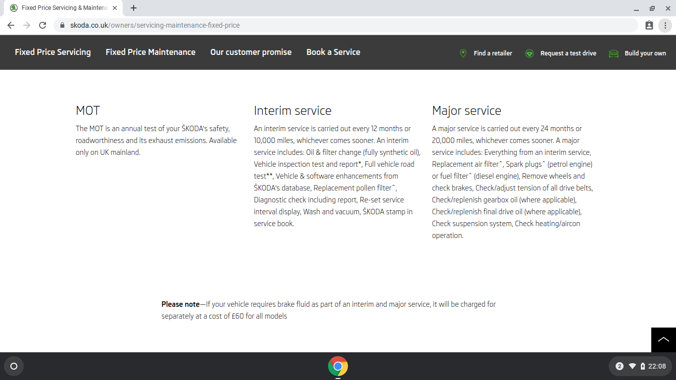

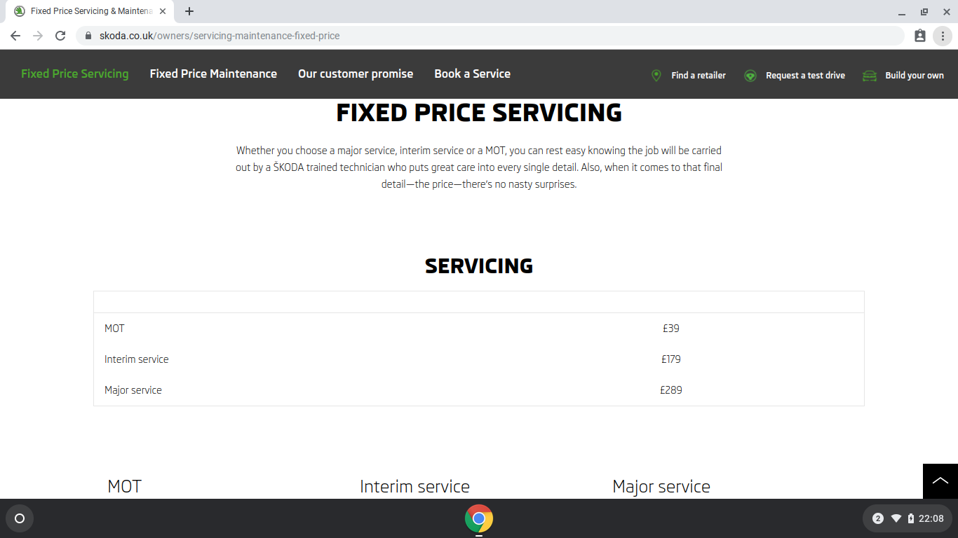

Where do you see a schedule showing the Pollen Filter replaced at 1 year?
It is not.  You could ask for it to be done.
(The schedule is at the 2nd fixed service or the 1st Variable / Flexible service, so basically after 2 years,
but then cars get used in different environments, that is the guidelines. Pollen filters can get a clean out, you can do that,
or replace yourself., same with Air Filters.)
*New car @ 1 year old just needs the Oil & Filter change, body inspection and health check*.
Not the Fixed Price Minor or Interim Service that shows for cars 3-10 years old on Fixed Servicing, where often parts might not get replaced.
As posted at the bottom of the page.
What are you being quoted for a 1st year service?
Tell them to use VW 508 / 509 if that is what you want even if you are sticking with Fixed Servicing.
VW504 so 5w 30 FS LL is fine, it is Skoda / VW that talk about emissions, they brought in VW 508 for the WLTP  / RDE & now RDE2.
If you want to go Variable servicing you had best be going to check stuff yourself and not go a year between looking over things.

Interestingly I was told 12k miles for first service when I picked up my car in March. 8 months on and I'm about 80 miles from 12k so will need to book it in... hopefully will be cheaper than the 'standard' £179 they quote on the website.
