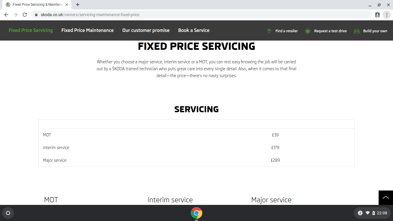

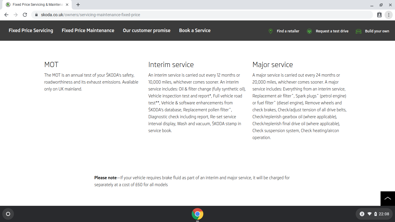

The 'Free Wash and Vacuum' is very expensive if paying Main Dealer for a Interim Service.
Wash and vacuum taking as ling as the Health Check / Inspection.

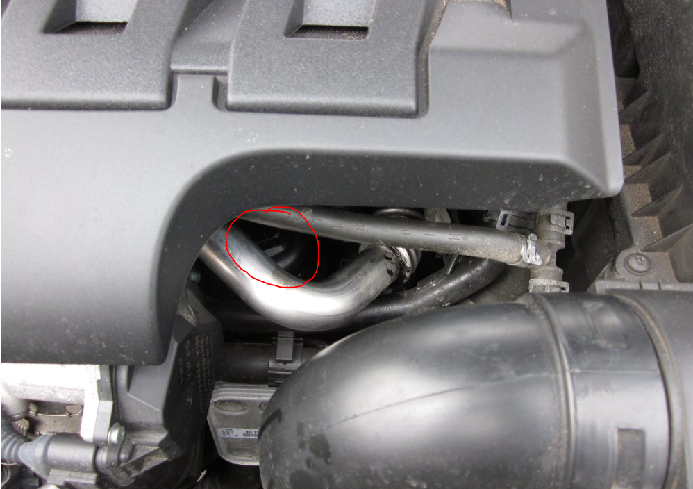

The oil filter housing is located under the engine cover...
You can just see it here...
With the cover removed...
As soon as the engine is run the oil will very quickly turn black so checking the oil filter is unlikely to reveal much...
If they've changed the oil then it is highly likely they've changed the filter too.

These use a replaceable paper filter in a permanent housing rather than a spin-on cartridge filter, perhaps why you didn't spot it.  You may not be able to tell if it has been replaced like the old days (ie a clean new cartridge filter was easy to see) - there may be signs of disturbance of the filter housing and the area around it.
