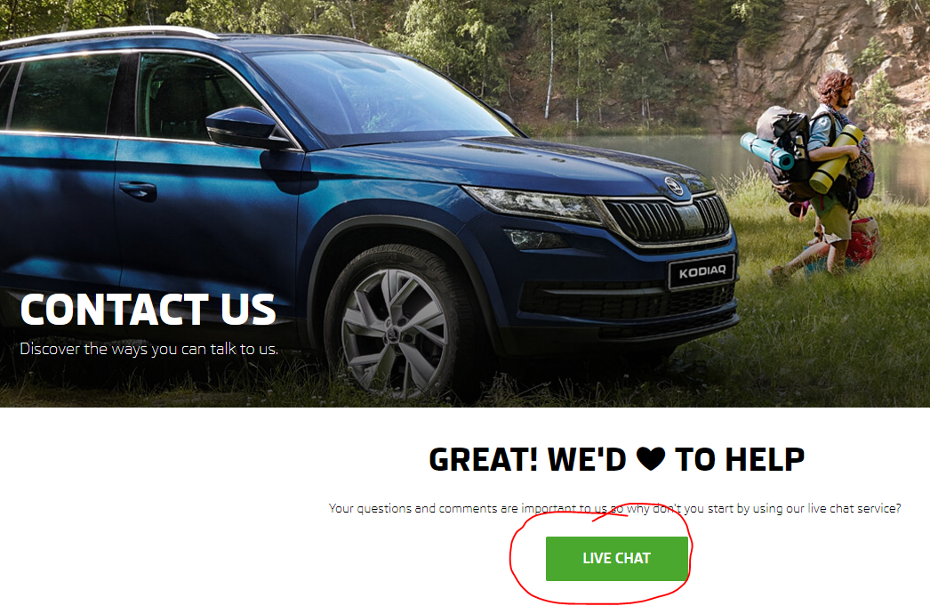

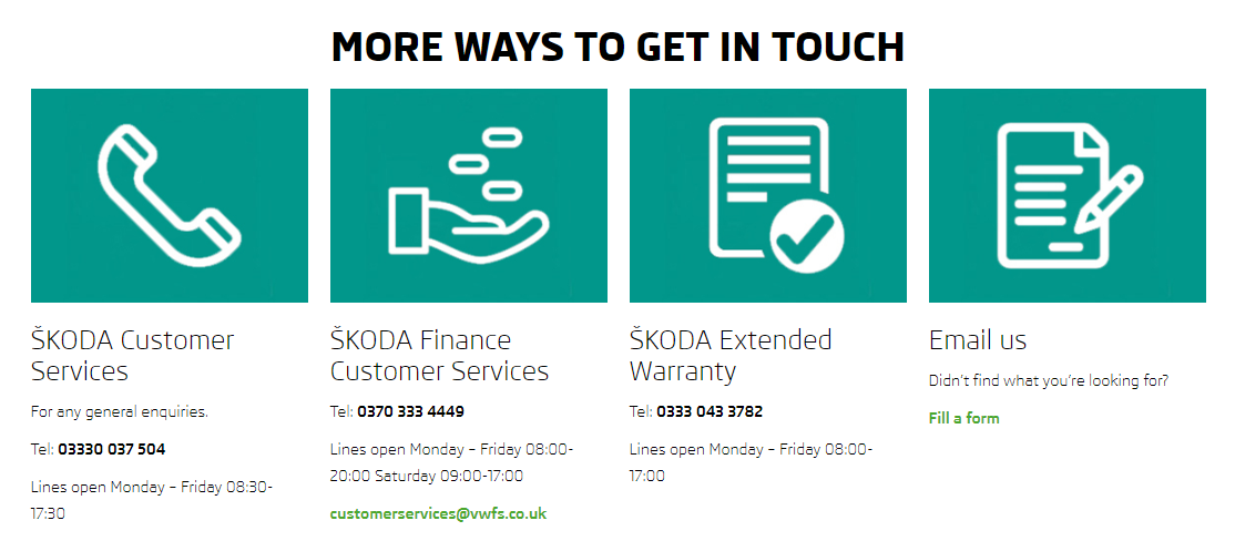

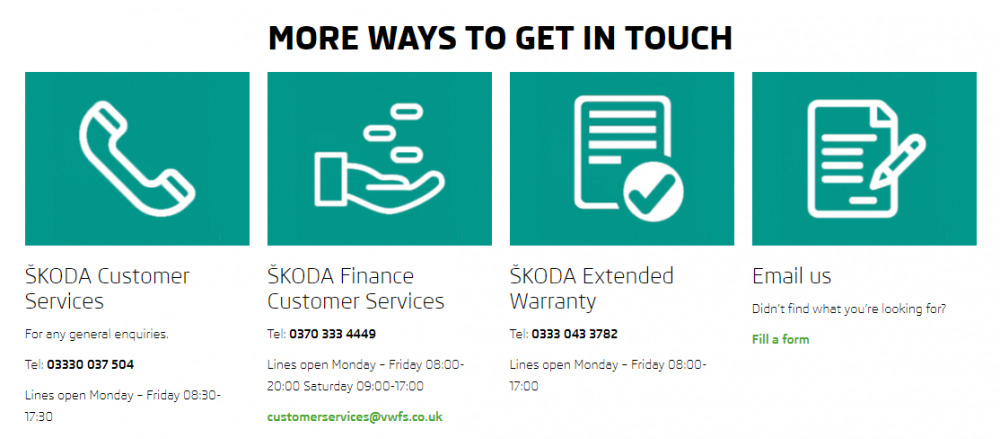

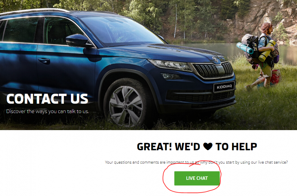

If you're at a computer, you can use Skoda's Live Chat feature. Afterwards you can select to have emailed to you a transcript of the conversation...
If not then best giving them a ring, their email response times are quite slow. ideally this wants resolving before the job is complete...
https://www.skoda.co.uk/discover/contact-us
