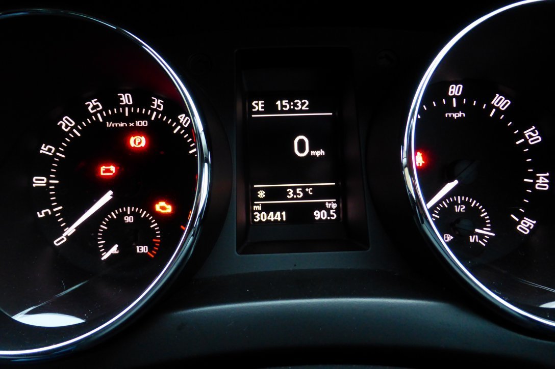

Is there anyone in Gloucestershire that can help change my Maxidot computer on my Skoda Yeti from KM to display MPH?

No, it can’t be done through any on-board settings. It has to be done through intervention via the OBDII port and some appropriate software.

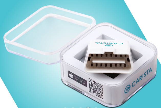

1) Buy this...
https://caristaapp.com/pricing
2) Await delivery of this...

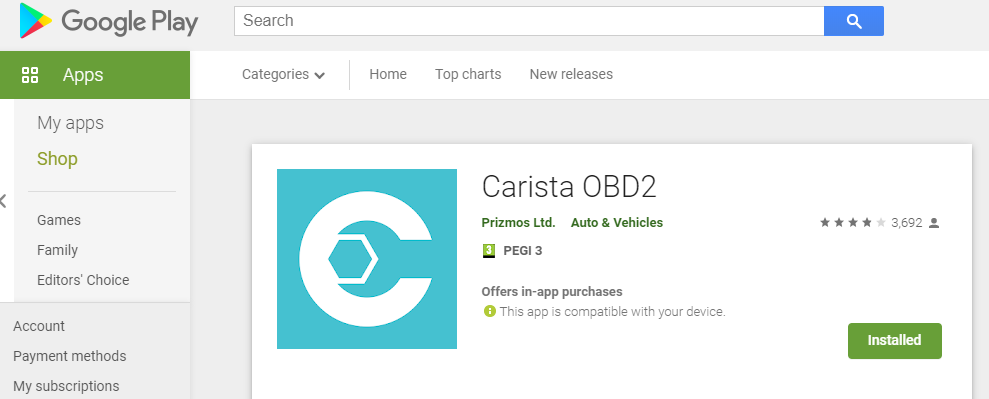

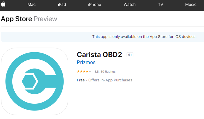

3) Download the Carista App onto your smart phone...
         Android > Google Play
         Apple (iPhone) > App Store...
4) Plug the Carista dongle into the OBD port on your Yeti.
Crouch down next to the car and lean into the drivers footwell. Look up to the underside of the dashboard and you will see a purple electrical port. This is the 'OBD' - On-board Diagnostic Port.

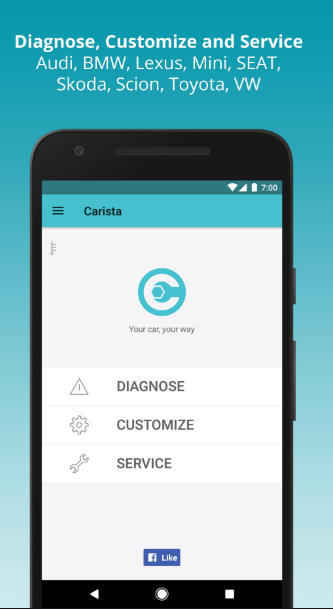

5) Open up the App on your smart phone and turn on the cars ignition.
6) Follow the on-screen instructions and select the features you'd like to enable, disable or adjust. The interface is very user friendly. No code or bits or bytes, simply text and selectable options.
