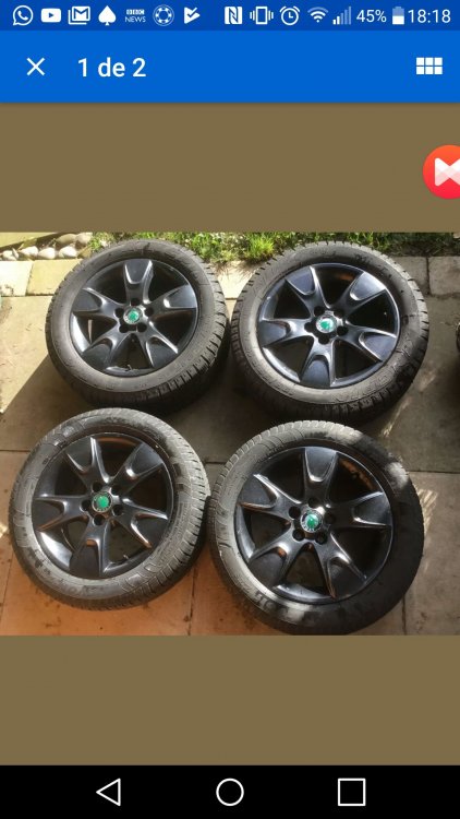

Would 15" rims (wheels) from a mk2 fit on my MK1 2004?
Hi there all!
Just looking to get some new rims for my 2004 Fabia. I've currently got the original ones with 185/60R14 wheels on. I would like to fit the SKODAFABIAMK2 Black Metallic 15 INCH ALLOY WHEELS ON 195/55/15 TYRES.
Please would you give me any info you can? I was under the impression that all Skoda ones would fit?
If anyone happens to know a ball park figure for a tyre of this type as well that would be an extra bonus!
Thanks! Zach
They should fit.
I've got mk2 steel wheels on my fabia with 195 55 r15.
They are cheaper than my 205 45 r15 but not as cheap as the 14s you  currently had.
About a year ago Toyo proxies in 185 60 r14 were about £45 each. 195 were £60. 205 were £90
Munfred! Thanks very much! I really appreciate it! :)
They'll fit. 5x100 both mk1 and mk2
