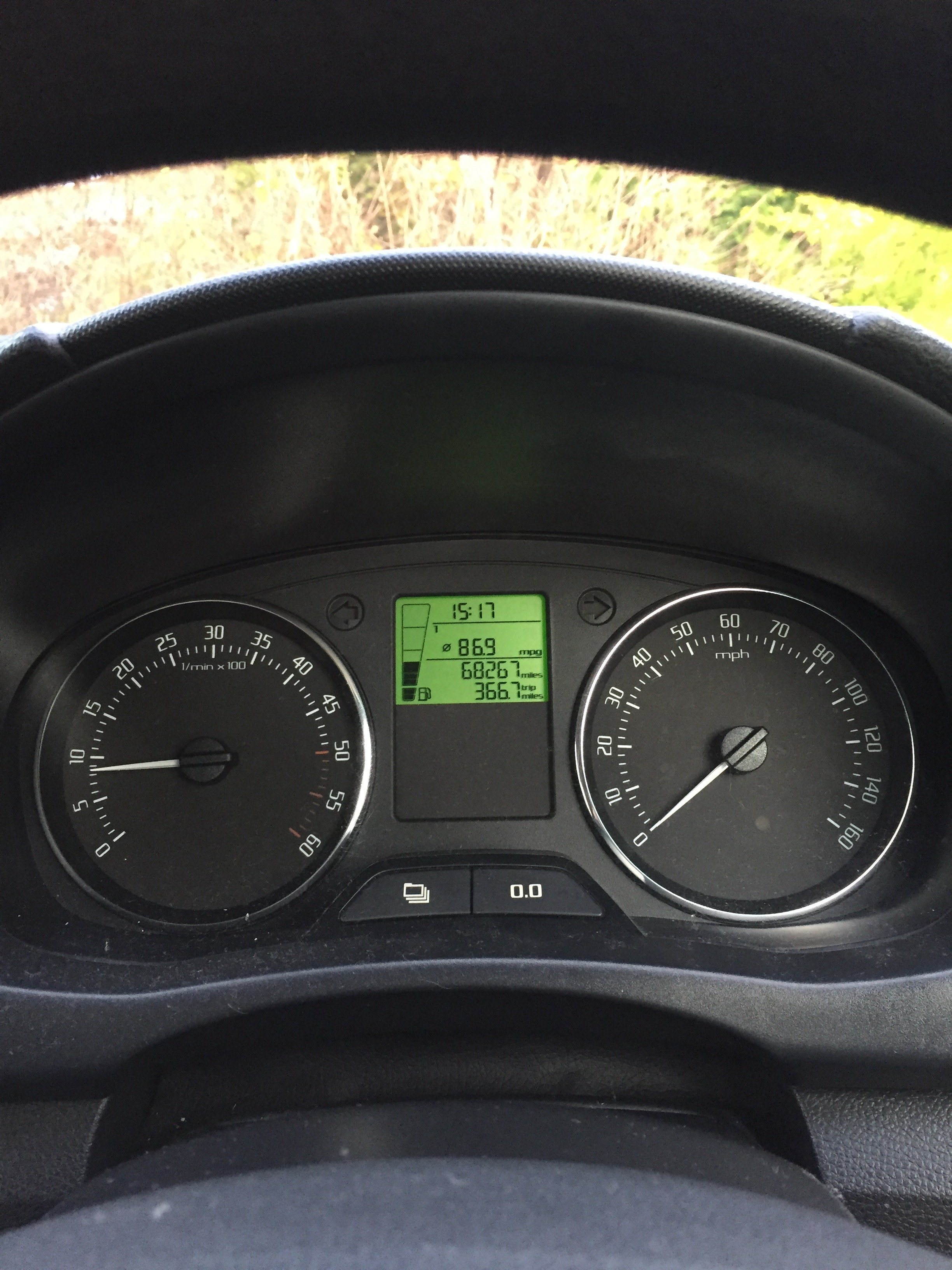

A bit of troubleshooting:
Which instrument cluster is it?
Maxi-Dot : gauges light up white and there is a black and white screen in between, with small analogue fuel and temperature gauges on the bigger gauges.
OR
Multi-Function computer : Gauges light up green when the lights are on, and there is a little green lcd between the dials. There is no temperature gauge, and the fuel gauge is a digital readout with bars. I’ve attached a picture of it.
FE7534D3-C131-4384-BE1D-F09DCA47767A.thumb.jpeg.5b549d8eca2091b41e82c2c33c341b73.jpegThe LEDs in both of these clusters can die, but that wouldn’t explain the engine issues.

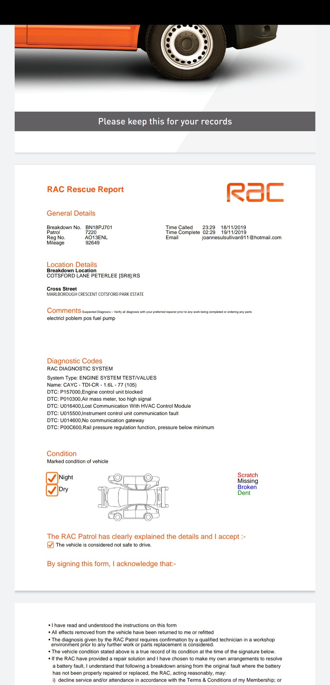

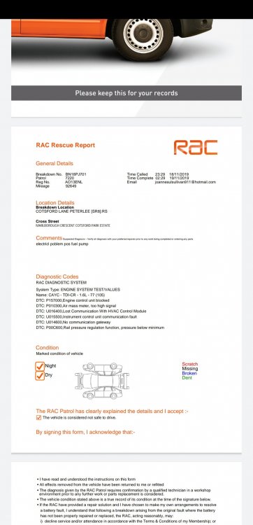

Had the rac to have a look and when scanned it these came up, I'm going to check the fuel pump later today
From looking at those codes, I think it’s unlikely to be the fuel pump alone.
No communication Gateway can often mean that one of the main computers has stopped working, and that’s what’s causing the rest of the car to lose it’s mind.
