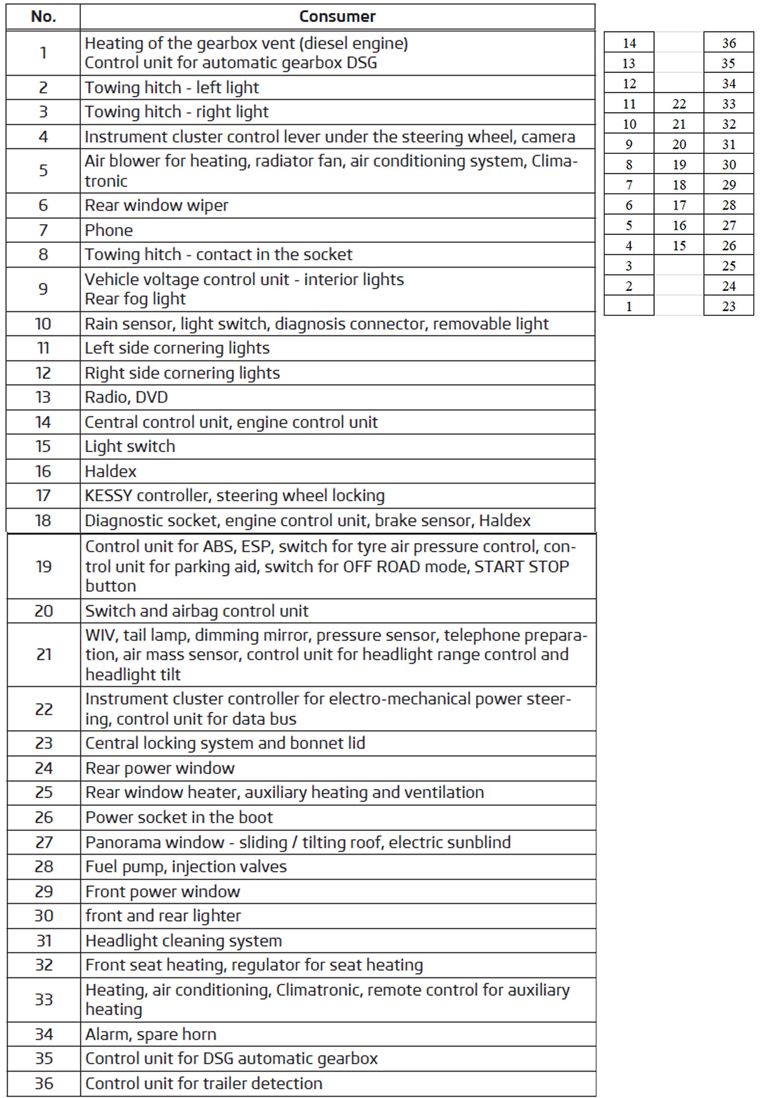

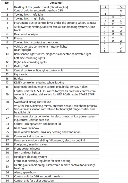

Check the fuses.  If towbar prep is fitted there will be towing-related fuses on the board.
