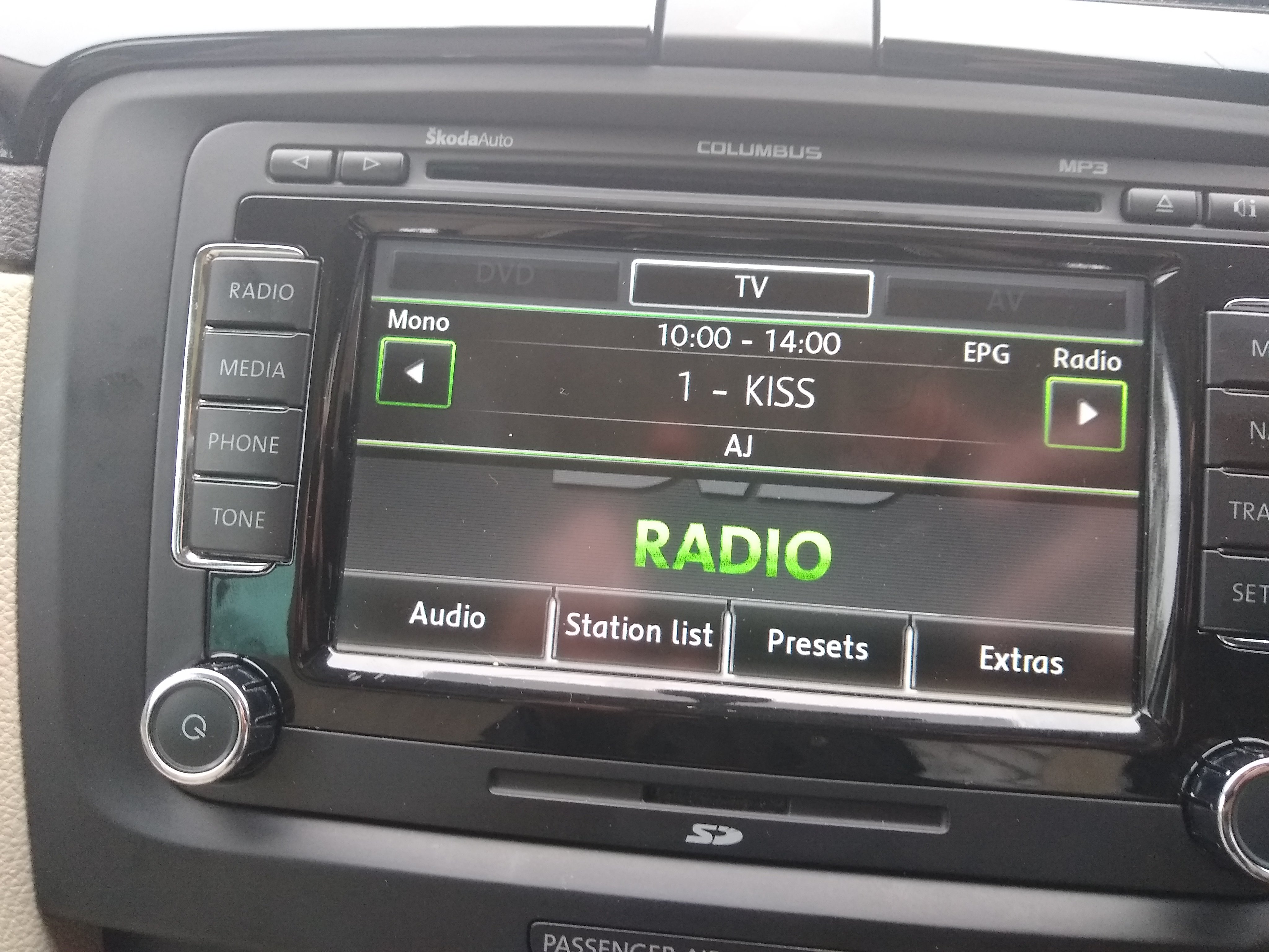

1. When I switch between a DVB radio station and a digital TV signal it will still display the DVB radio graphic - won't go away, but if I press to switch stations I can just make out the TV picture in the background of the overlay, so it is there. If you look at the picture closely you'll just make out a man in glasses in the black bar across the screen - that's the TV show. I just can't get a tv picture without a hard reset.IMG_20191124_115207848.thumb.jpg.d7e17ef07b8f07db630d89971f6b92d3.jpg
