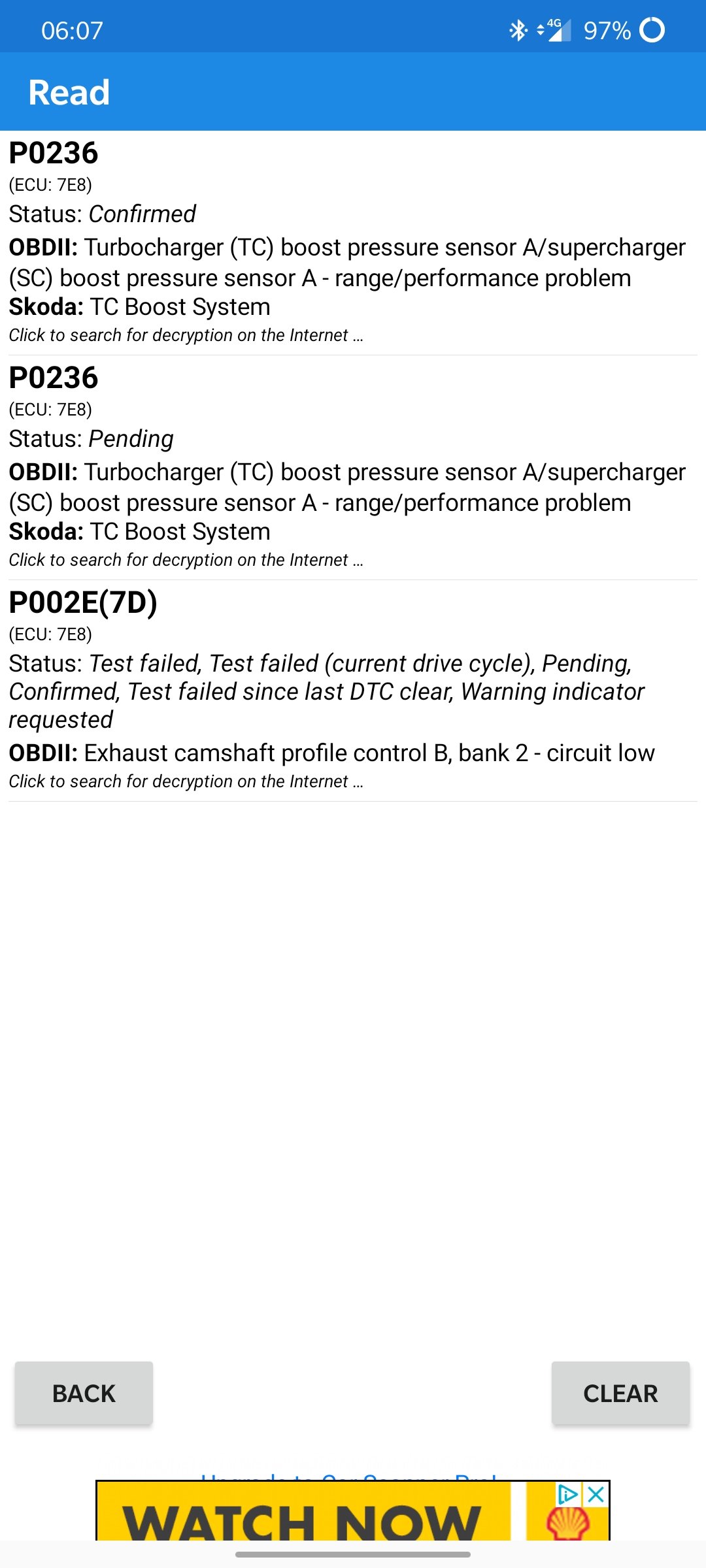

My car is in Limp Home mode with a flashing glow plug light. I have a P0236 fault code  -Turbocharger boost pressure sensor.

Okay thank you for the information. I've managed to find a few posts since which suggest a common issue as you say. Although I can't find a TSB number.
I also managed to find its location & have attached images should anyone come across this threat in the future.
