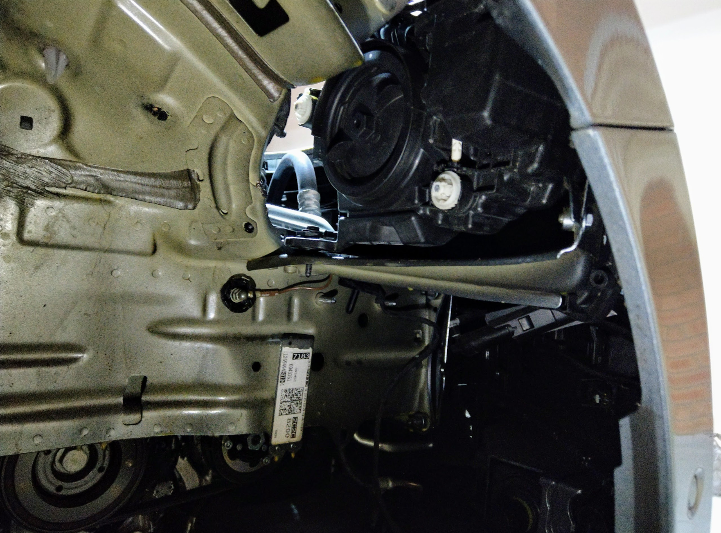

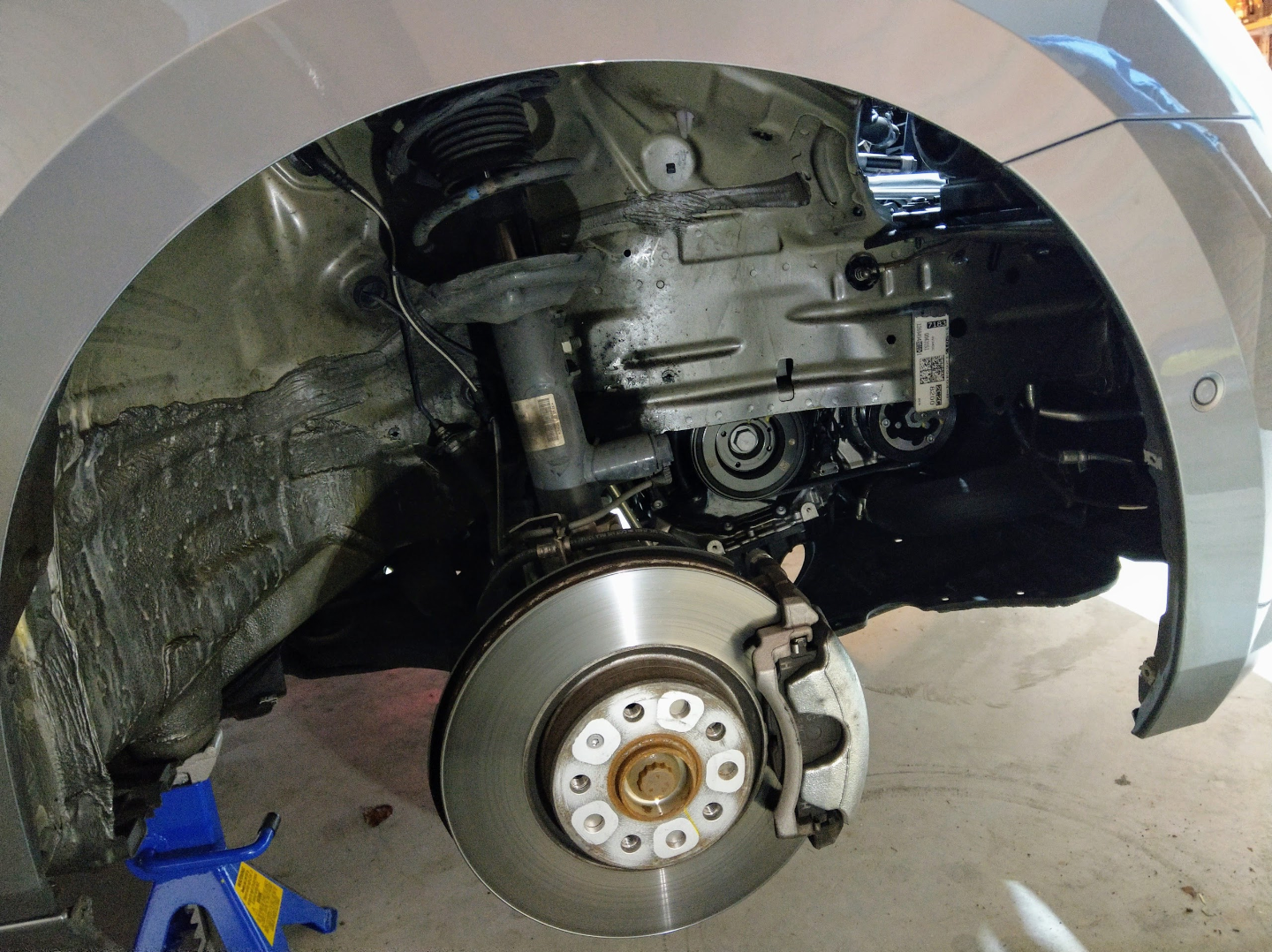

Bumper off.....
The bottom ones r the drivers side access, without having to remove the bumper.
Edited by JR RS
