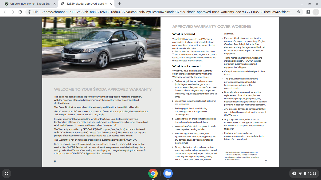

Strange thing is, I was told that the water pump is not covered under the 12 month used car warranty.  SKODA paid 50% parts and 70% labour and the dealership picked up the rest of the tab out of good will.  All parts and labour for this fix is guaranteed for 12 months apparently
2 hours ago, Roottootemoot said:
@Maffa
Who told you, and did they show you in the T&C's of the Warranty where the failure of the 'Water Pump' is in the Exclusions.
Were you communicating in Writing with the Warranty Provider and not just with a Dealership member of staff?
It was the girl on the service desk over the phone at the dealership, so no not the warranty provider.  The pdf you posted doesn't have any parts like the water pump excluded from it so sound like she was making it up
