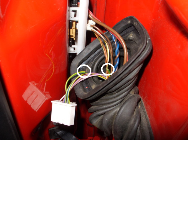

Hi front windows on my sons fabia 1.2 has suddenly had window failure. Started with some days they work others not. Recently not at all .Has anyone got ideas ?
Check for broken wires in the door bellows. Also the switches can stop working properly or sometimes it's a fault in the driver's window motor which contains the electronics.
Bellows example...
