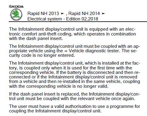

In the meantime, I found this in a workshop pdf:
Which seems to suggest I'll need the stereo re-coded if I pull the plug to insert the patch lead (or even if I just disconnect the battery??!)
This can't be right, surely???
