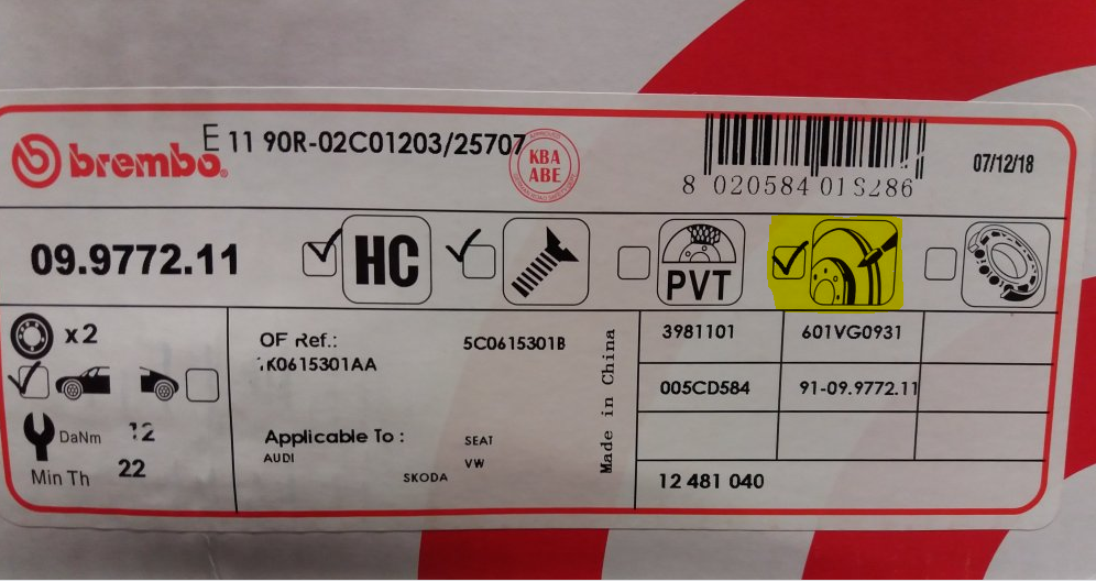

So are Brembo
I didn't think mine were, or at least if they were it didn't seem to offer much improvement to the time taken for them to begin to rust...
Is that what this logo means (highlighted in yellow)?
No aggressive / corrosive alloy wheel cleaners used, and this was my MkIII Octavia Scout after a year <10,000 miles...

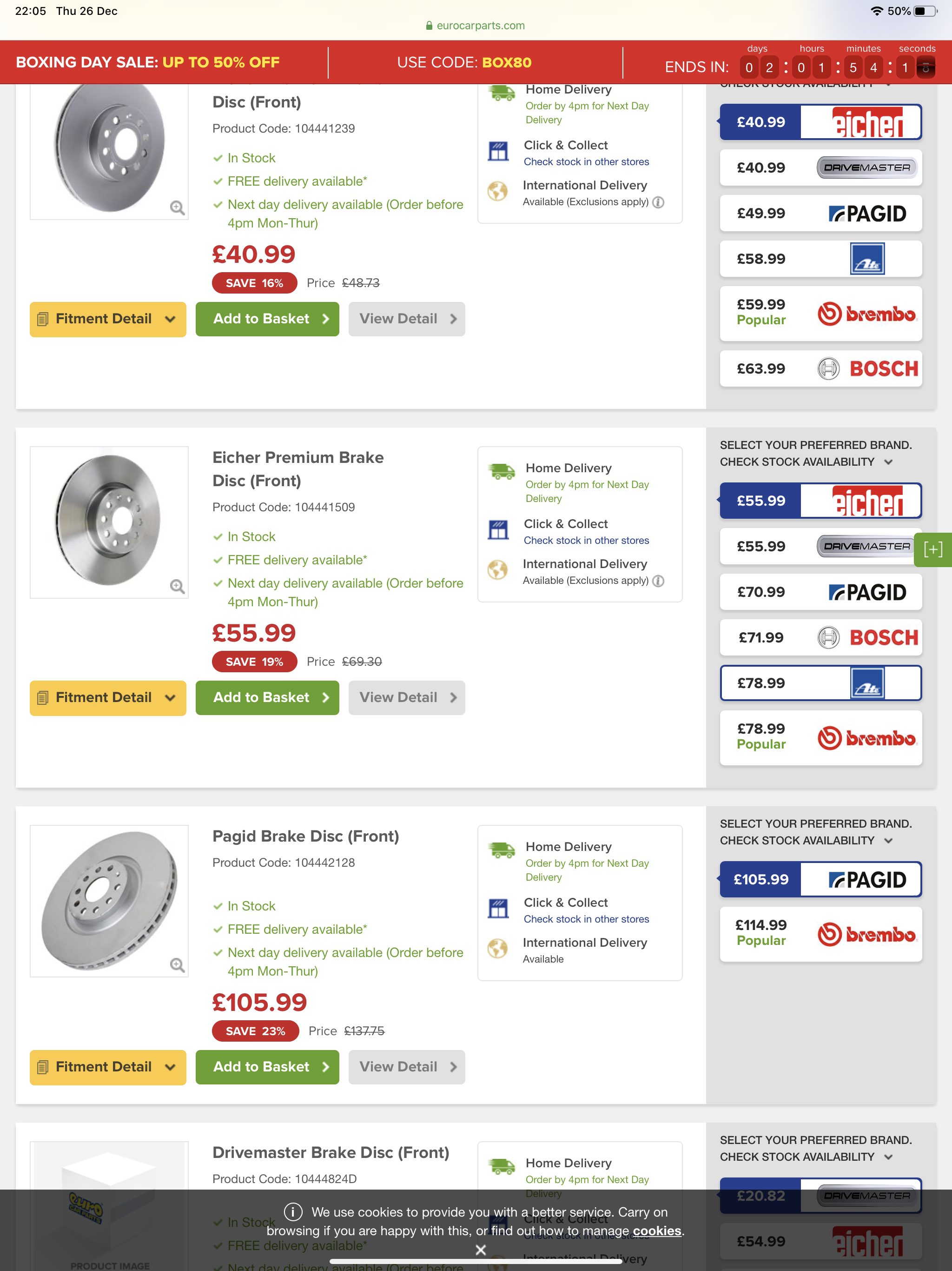

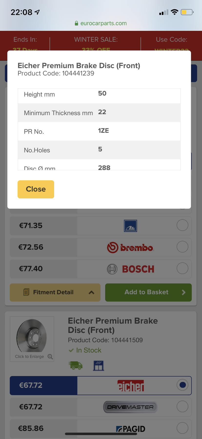

Thanks for all the replies, problem I am seeing on most websites (e.g. euro car parts) is when I put my reg in, I seem to get multiple front and rear disc sizes it seems. For example I see multiple Brembo options at different prices, but no idea which are for my car?.... any thoughts?
Pic below as an exampleF1F40D46-005C-4026-8ECF-455FE2034454.thumb.png.3e67910c55793f91e21de39851e194cc.png
Look under your boot mat left  hand side under the carpet there is a sticker with the pr codes for your car and is youse to match what Components specs your car was built with
Edited by Scout151
Unfortunately the front disc PR code is often missing from the boot sticker.
Grab your VIN and try this instead...
