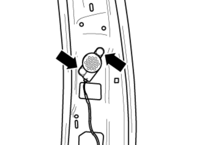

Parts catalogue shows it in the B-pillar.
Edited by TMB
That schematic looks like a MkI Octavia rather than the Fabia?
See the sixth post on this thread...
It suggests the buzzer is mounted above the headlining near the high level brake light.
True, and not all Octies have a reversing buzzer.

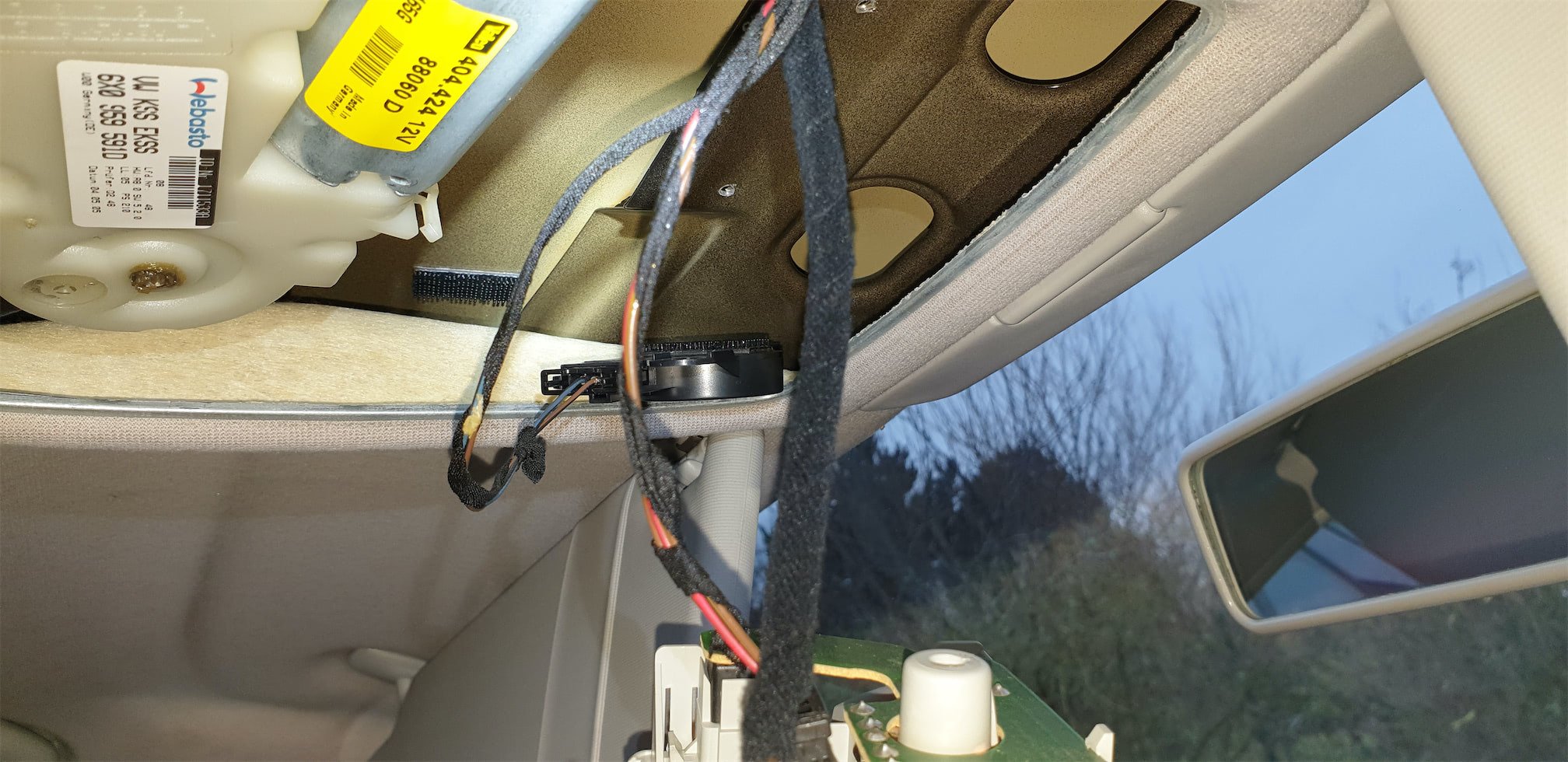

So the good news is I found it. Hidden up inside the roof lining> I needed to remove the front interior light cluster and hey voila there it was. See Photo.
So now when I go into reverse it beeps, which it did't before, but the sensors are not working. Tomorrow I will plugin VCDS and see what's wrong.
oh, forgot to say, as you can see it was stuck to the inner roof with a square of velcro.
