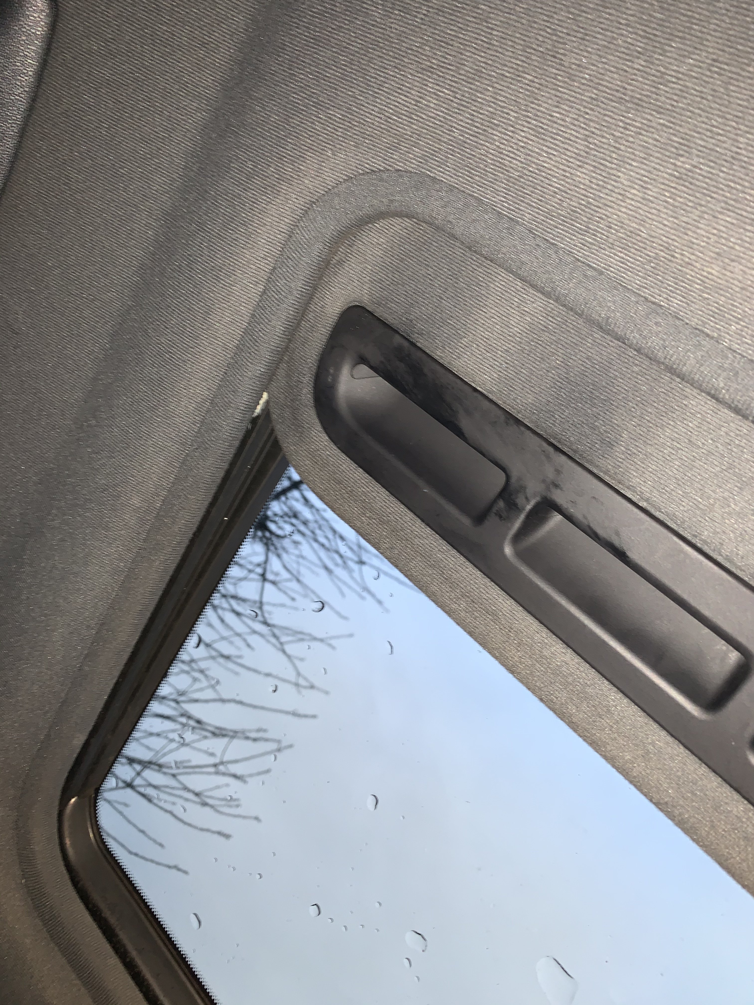

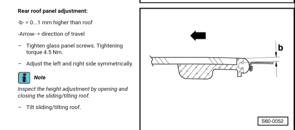

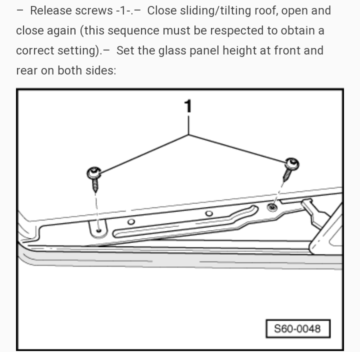

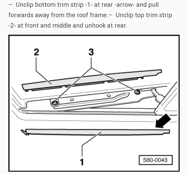

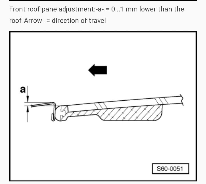

Update on the water leak looks like it’s coming from the rear drivers door but have found a leak on the sunroof on passenger side off the sunroof any suggestion on fix. Sunroof window seats abit lower on the passenger side than the drivers side of the window
The tray under the sunroof mechanism is meant to collect that water, pretty sure the drains are clogged. My sunroof sits even lower than yours and I have no leaks. You can adjust where the glass sits by prying those bellows on the sides and undoing the torx screws below, then with both hands level the glass where it sits flush with the roof, tighten the screws again, put the bellows and you're done.

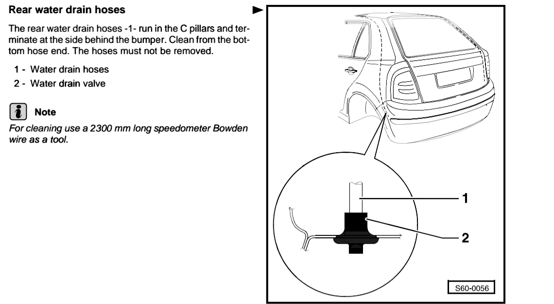

There’s rear drains aswell isn’t there if there is  I think there the ones that are clogged two front ones seem to let out water
Yes sir, there are rear drains, they go from the roof through the C pillars and down near the back of the rear wheel arches

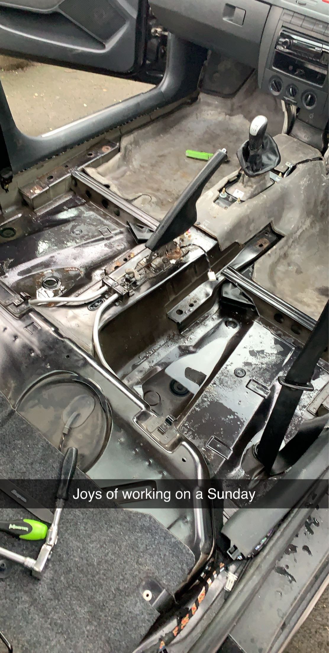

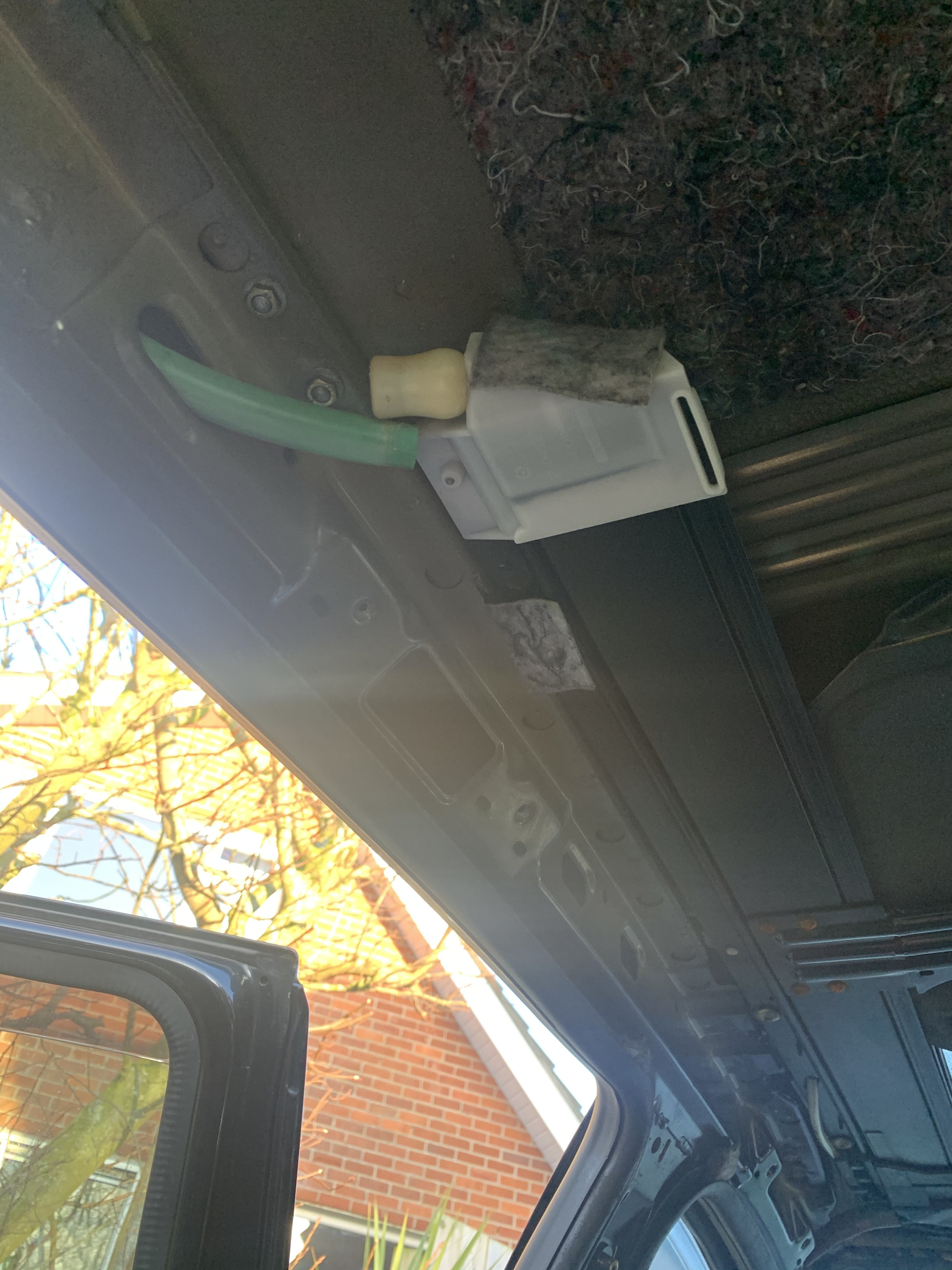

Update on the leak took of the headliner found the pipe joining to the passenger rear drain hole is leaking the pipe joins to a rubber  sleeve then onto sunroof drain which is where it’s leaking from on the sleeve think I’m going to get some pipe sealant hopefully will stop it. And for the sunroof window leak not quite sure if it’s the pipe is doing it or the window hope it’s the pipe fiddleing around with the window sounds a pain in bum
Please and by all means, clean the hoses, enlarge the drain valves even.
The draining will be the problem not the glass sealing.
Update I unblocked the pipes for rear drains and the outlet buns for pipe under the rear bumpers which I made them bigger so water can flow abit better. the pipe joining to rear drain on passenger side was leaking aswell the rubber joint that goes from green pipe and rear drain on sunroof was leaking from the joint itself so sealed that with sealant seems to be working. And adjusted the sunroof window itself was still leaking with the pipe fix so adjusted The sunroof window brackets and it stopped getting water through the window . Just to rebuild all interior itself
