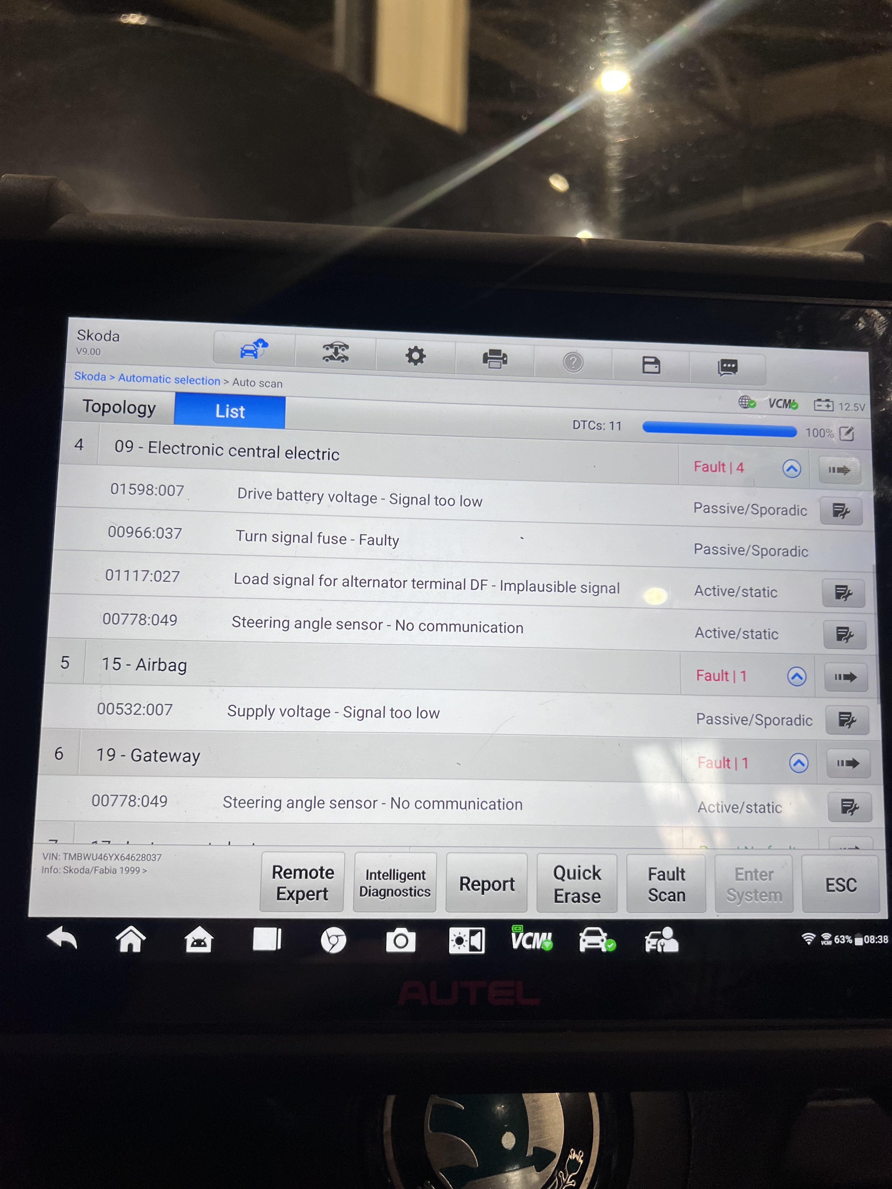

  1. Well folks been awhile just recently purchased a fab vrs complety stock but have a few electrical issues. Drivers indicators not working one in the headlight front fender and rear tail light not working. Also central locking not working car won’t lock with key or lock button inside the car. Checked the wires at the door check strap there all ok any ideas guys fault codes below

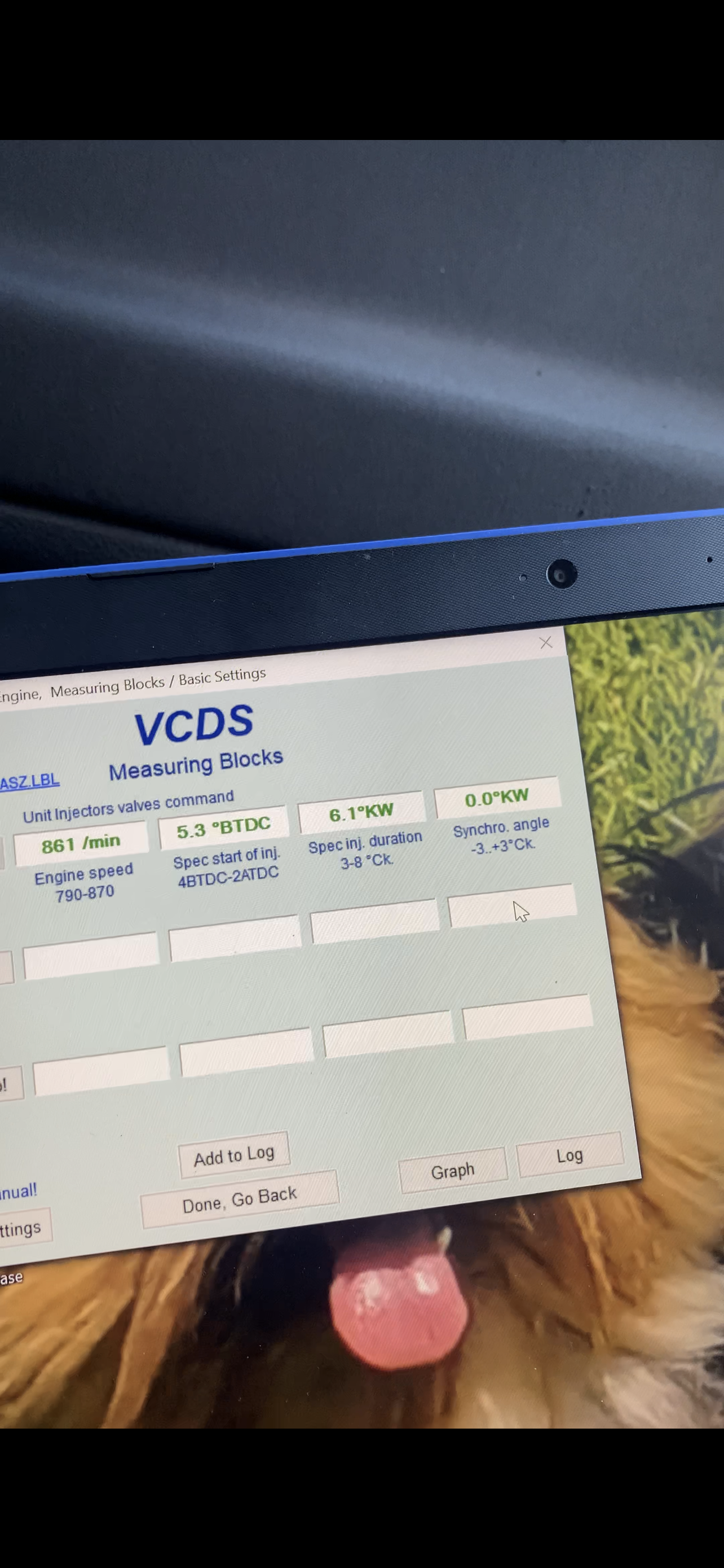

  4. I replaced the timing belt myself few month ago now and was checked on vcds torsion values set to 0.0 and when reved it goes to -0.6

  8. Have a 2005 fab Vrs which is struggling to start first thing takes a few cranks to start after that it’s fine doesn’t sound lumpy or anything. Starts on the button after the first start ie when warm or a few mins later after turning car off from first start any ideas folks glow plugs?

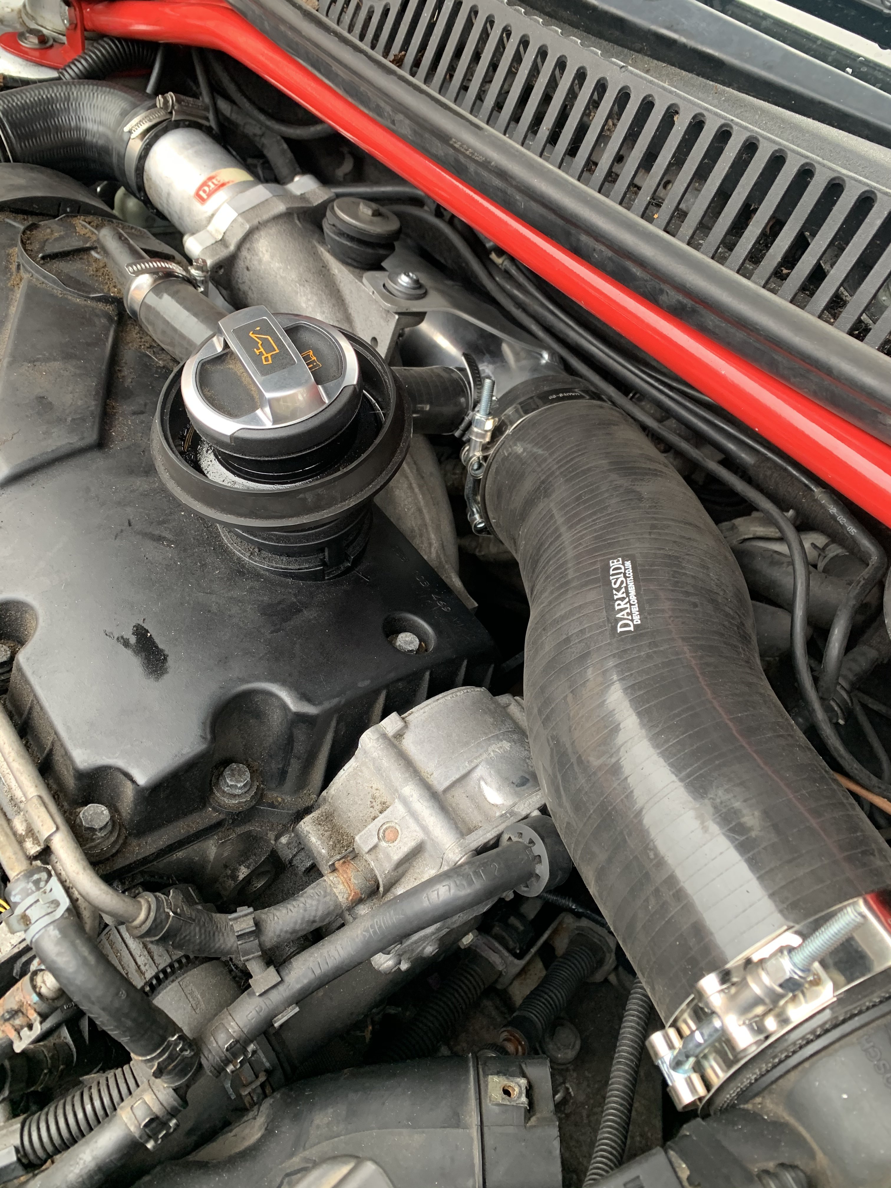

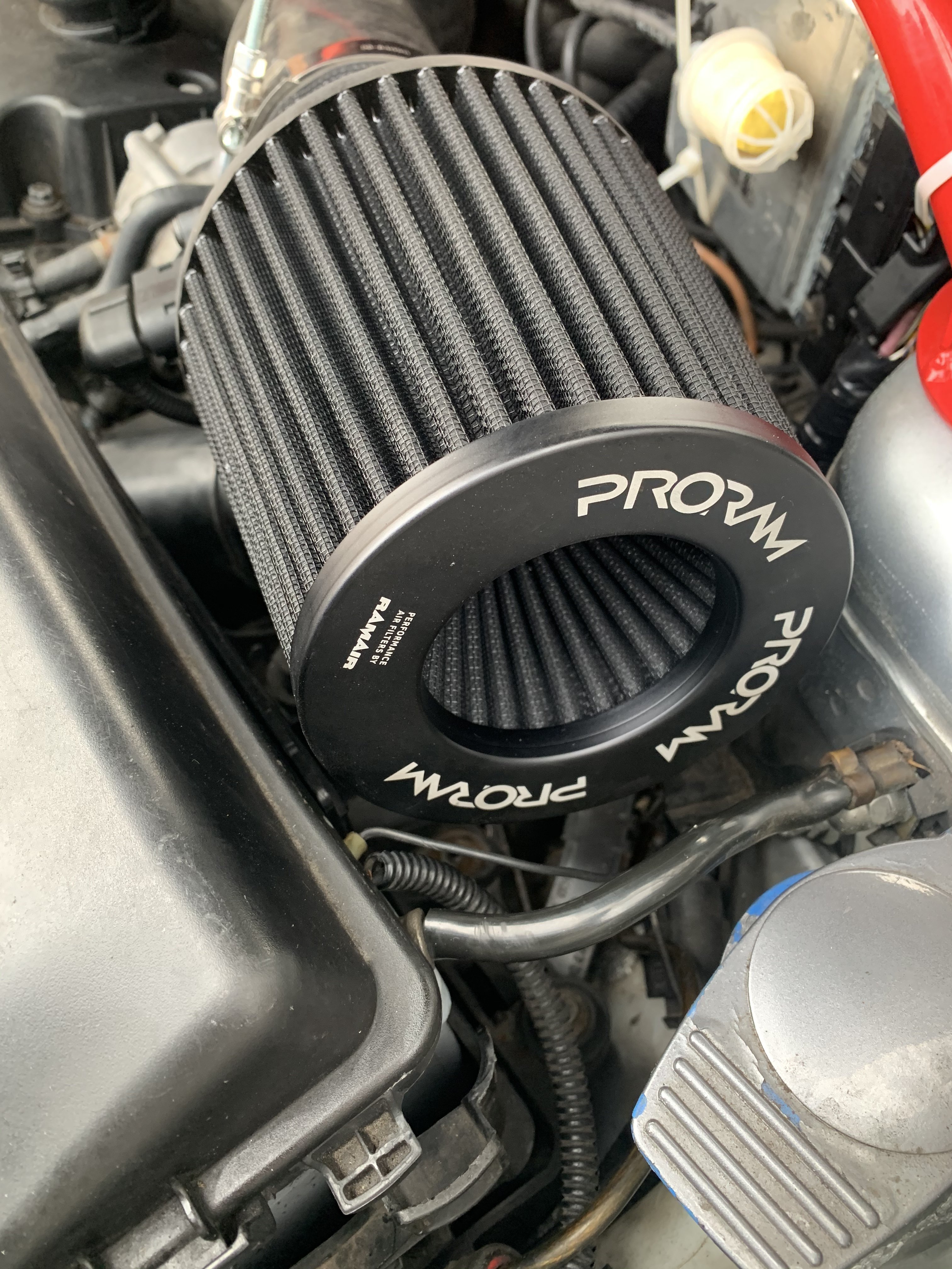

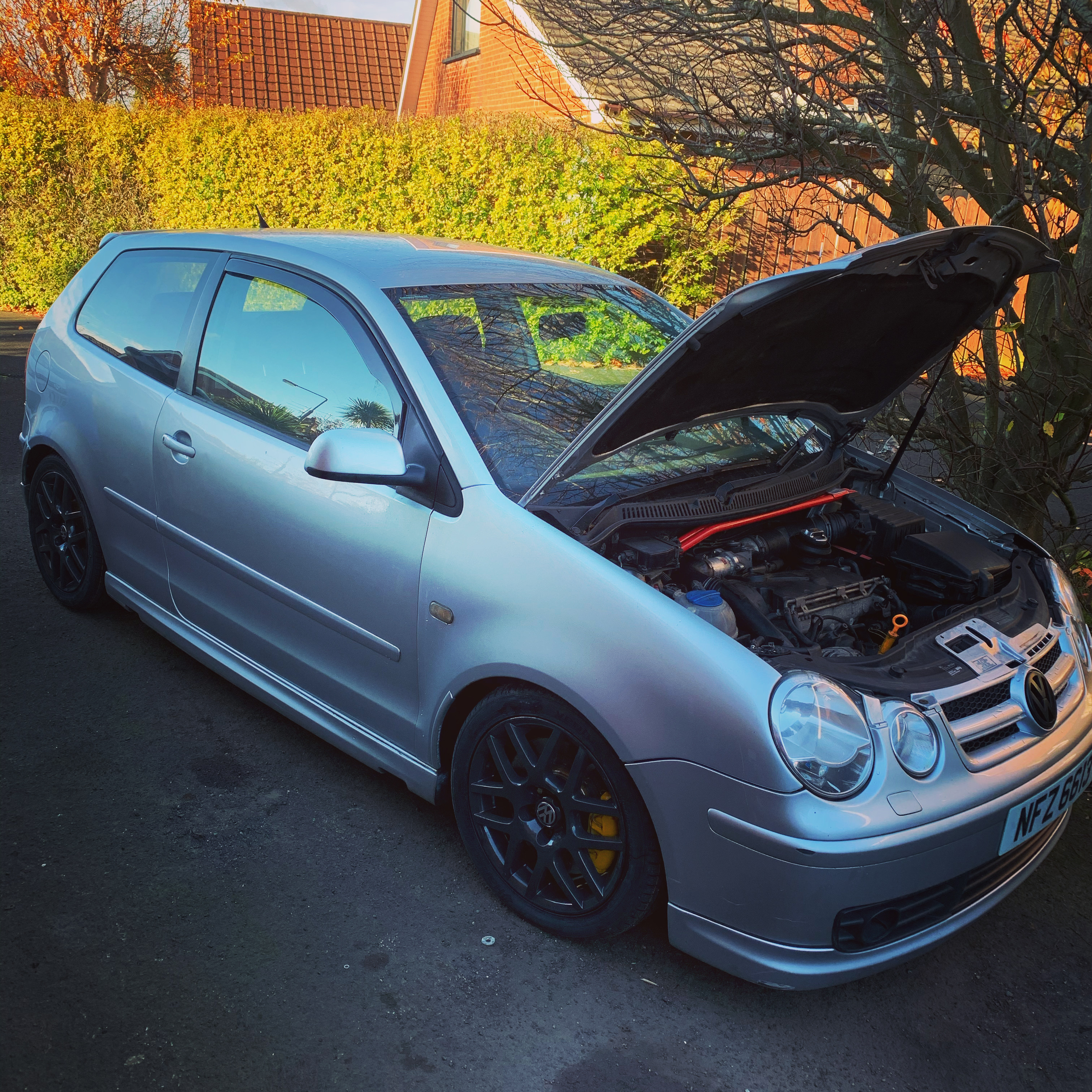

  9. New air intake fitted today from darkside developments 😊 Recently refurbed alloys looking well with hankook Ventus v12 evo2 wraped on them. Alloys aren’t 100% Perfect due to them being corroded quite badly before them being done but a lot better than they where

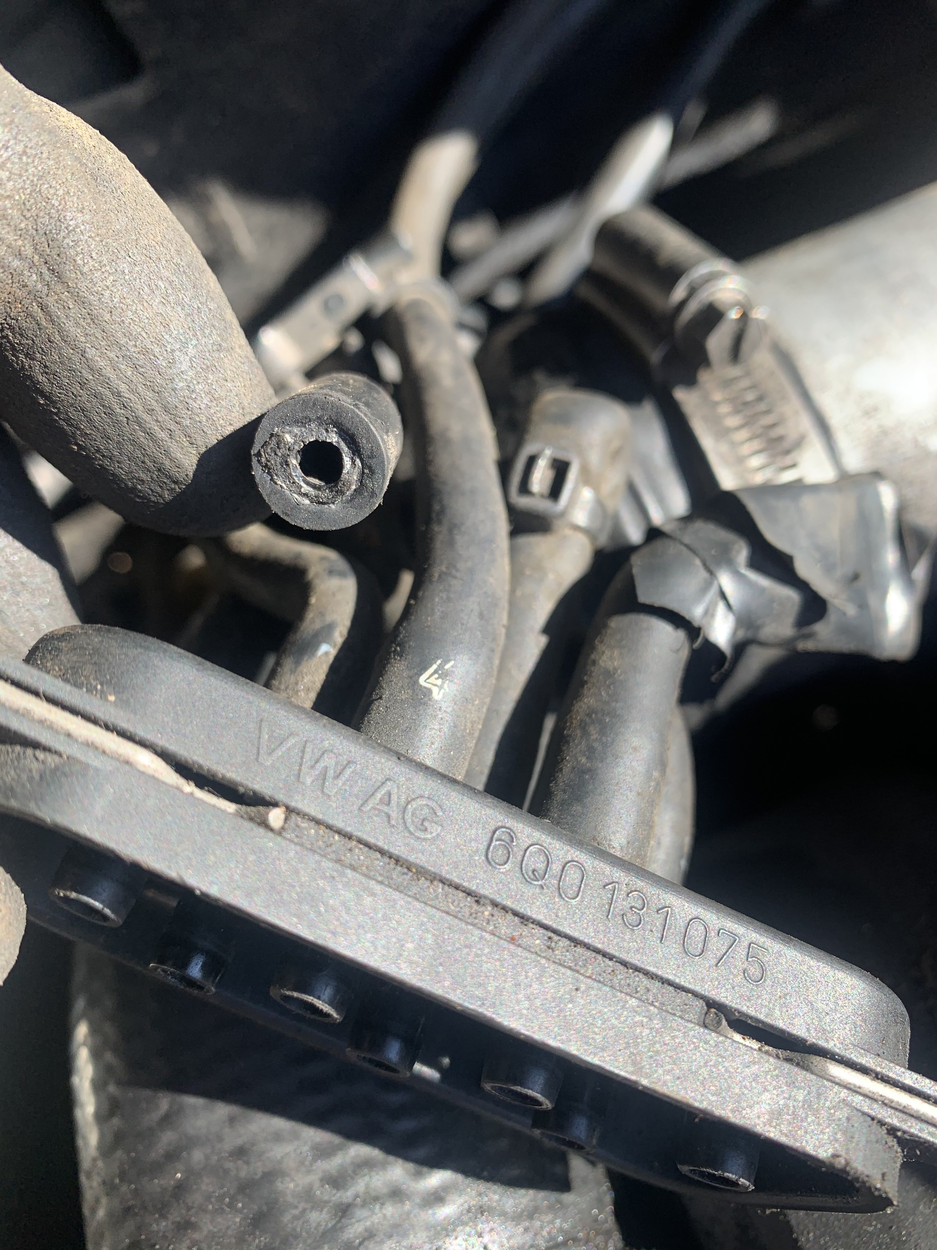

  12. Just wondering does anyone know if the vacuum connectors and hoses r the same on asz/blt engine broke one of hoses just need the connector and hoses but can only find asz ones for sale

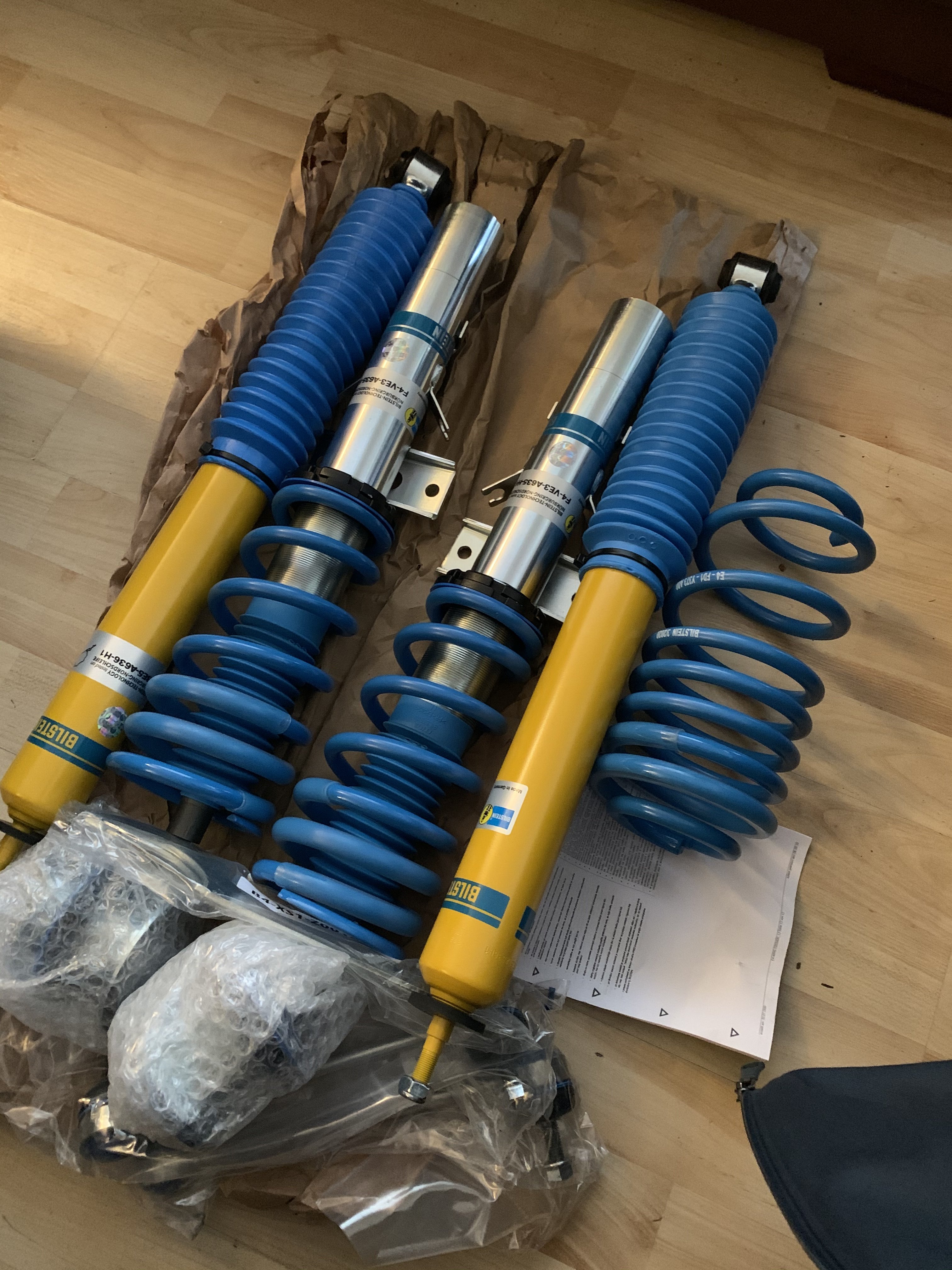

  13. Few follow up photos on more bits that have been done and lovely new parts that have arrived 😊

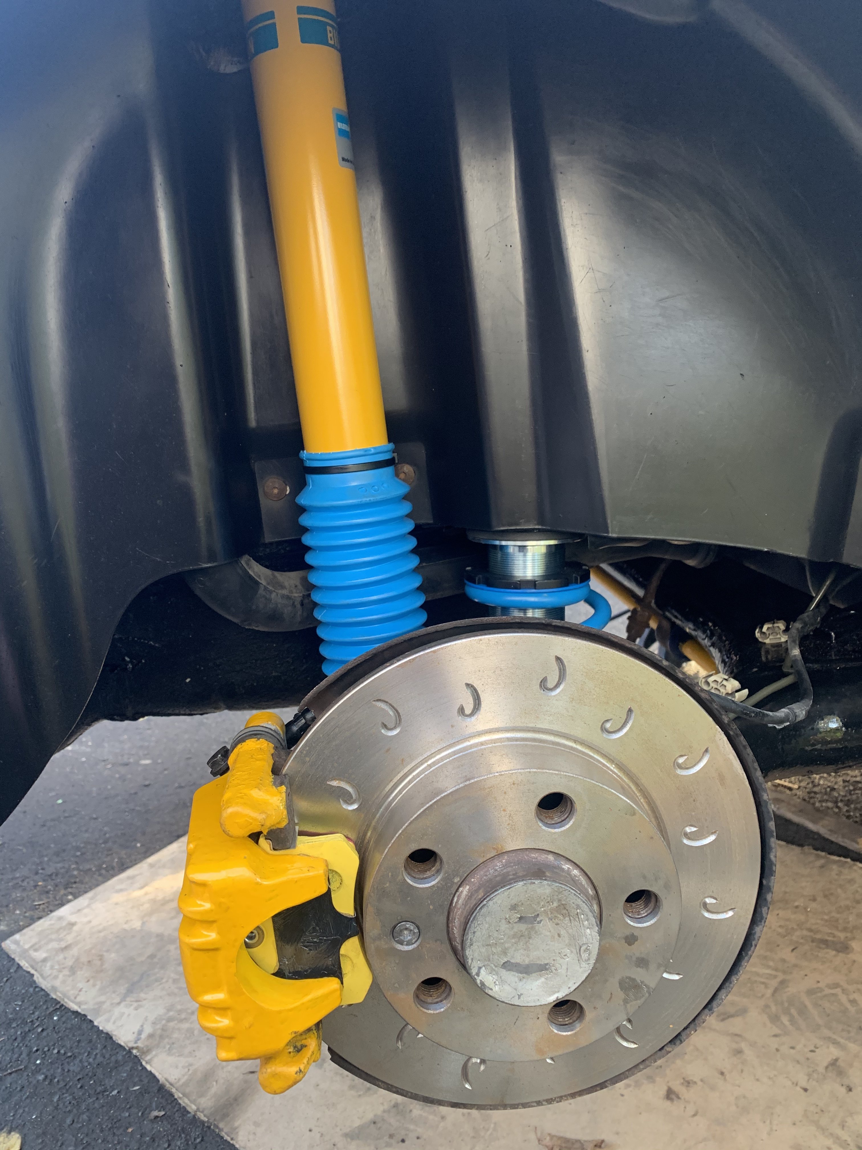

  14. Was looking back on ur photos looking at the rear b14 springs wondering do I have my springs upside down ? Having them ur way they don’t sit on the coupler to well
