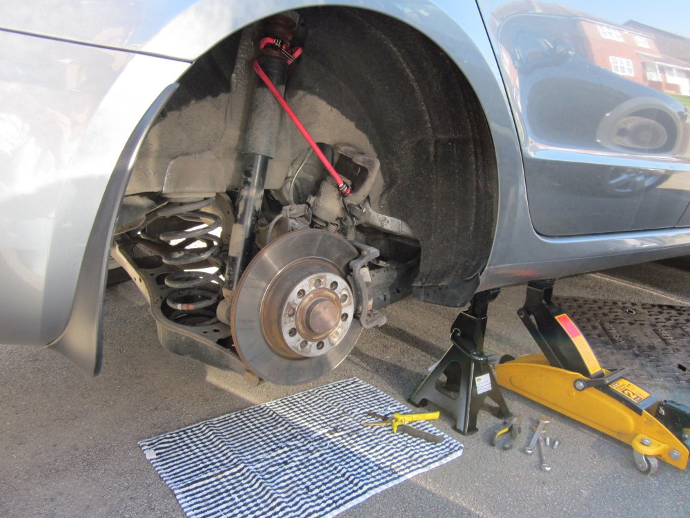

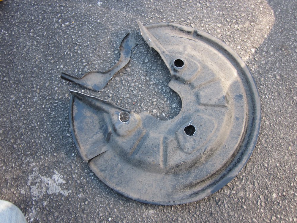

I'm not quite sure how to explain this, but having heard the odd graunch that we thought was a stone caught between the disc and the disc guard on the O/S front wheel, yesterday it got really bad to the point of thinking "something has come apart or dropped off" yesterday over 100 miles from home on the A38 just south of Burton on Trent. It was dark so I found a filling station forecourt and after telling them what I was up to I jacked up the car and removed the wheel in an out of the way (aka SAFE !!) spot.   The disc guard was still there, but flapping around as the centres had been ripped out of all three attachment points. I was able to slide the shield rearwards off the hub with no tools and that revealed some serious grinding marks where there had been contact with the revolving disc. I'm not aware of anybody having contacted anything that might have damaged the disc shield
I have never had the hub off, but it did have a new front wheel bearing/hub unit fitted last spring. After removing the shield it was of course totally quiet, which was a relief.  When putting the wheel back on I found myself wishing for a wheel locator pin like Alfa Romeo used to supply with the 164. Getting those lug nuts in is a complete PITA....
I've ordered a new one. its a common VW/Audi/SEAT/Skoda part.....so now I know what I'm doing with at least part of next weekend...

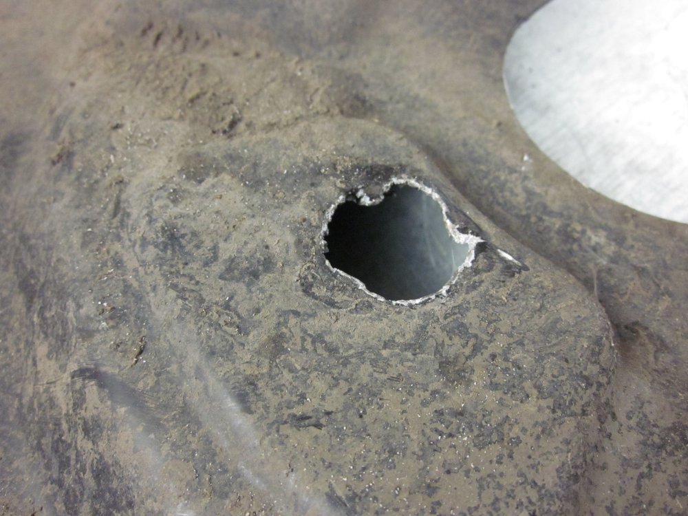

In my experience the most common cause for failure is when the wheels are removed. if they are allowed to drop off the hub without being supported they catch the shield which after a couple of times and several thousand miles of vibration elongates the holes eventually resulting in its demise.
Oh dear......so now I can expect the other disc guards to fall apart as well can I ?  As the same guard/part number is fitted across the entire VAG group range I expect  there is a regular little ongoing epidemic of disc guard failure..😒   Its not very good design is it, and they don't give them away.  I understand it is going to be the wrong kind of 'fun' getting the fixings out and fitting the new guard. Hey ho, what are saturday mornings for anyway....😐
VAG might not give them away but there are loads of pattern part ones available, I have never paid more than €10 for one.
I dont think that dropping the wheel on them when removing causes the failure, its a combination of rust & metal fatigue at a stress raiser, when they are about to fail dropping the wheel on them will help them on their way.
It was quite obvious when all of mine were beginning to fail and needed replacement, one hole will break away before the others and the corrosion was very advanced and would warrant changing the shield on its own.

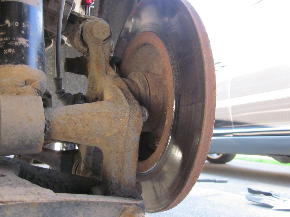

I have never had brake disc corrosion on any car where I have removed the backplates (and there have been many) and I have pretty much always suffered corrosion both inside and out when they have been retained, hard to understand why it should affect both sides unless its heat related.

Don't catch them when removing the wheels. The sound they make when the alloy catches them is very familiar to anyone who has spent time in a garage or main dealers.
Corrosion plays it's part but it is the weight of the wheel temporarily pushing on the guard that starts the elongation of the thin metal.

mine failed and dislodged as yours did so I replaced both sides on the front of my Oct 3.
