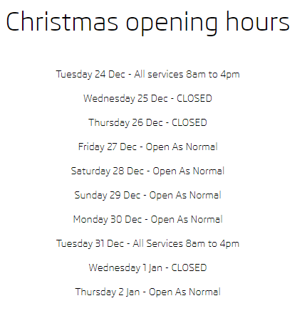

Ring Skoda UK customer services and ask them to get involved.
