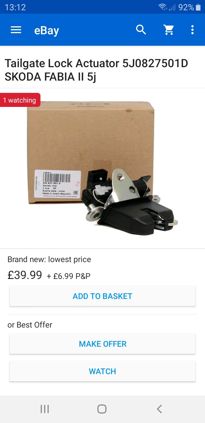

The boot light is the clue here. The car thinks the boot is open.
The 'door open' warning and boot light combination is a common fault across many Skoda models. There is a microswitch in the boot catch, if this fails the car can't tell the status of the boot.

Thanks very much for the suggestion. That makes perfect sense so I'll get the catch changed. There is no wet in the spare wheel well by the way.

Just to close this one off, the suggestion of replacing the latch was correct. No more warning lights and no more false alarms, so thanks to everyone for the suggestions.
