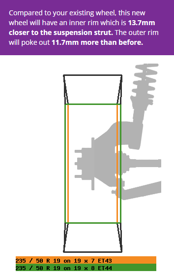

Measure the gap between your current wheel/tyre to the strut. If it is greater than 13.7mm then technically they should fit without interference.
It may also be worth measuring the distance between the tyre and the wheelarch liner in both left and right steering locks to be sure there is no interference here too.
Looks well within tolerance to me...
