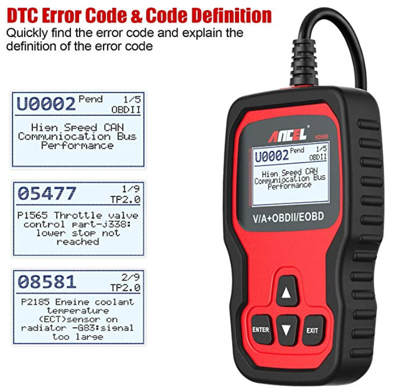

https://www.amazon.co.uk/ANCEL-Diagnostic-Volkswagen-Diagnosis-Throttle/dp/B07BS7PDC2
If you look at the example fault codes (U0002, 05477, 08581)...
...these are the generic codes that don't mean much without the accompanying text on the screen of the reader.
However, in the example above if you look at the second code (05477 in the middle), it also gives you the Ross-Tech code (P1565) underneath...
This is the important / useful one as it can be used to cross-reference on the Ross-Tech fault code page linked earlier, and again here...

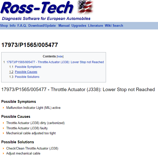

http://wiki.ross-tech.com/wiki/index.php/17973/P1565/005477
The advantage being that rather than just the basic text / description on the reader itself, you get the added benefit of "Possible Symptoms", "Possible Causes" and "Possible Solutions" from Ross-Tech, which can be invaluable.

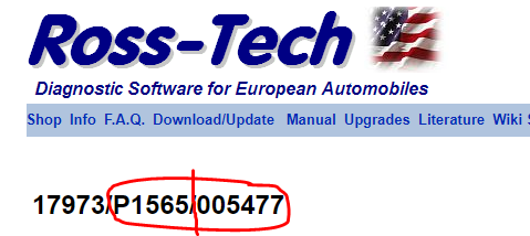

I did also just notice that the 'generic' code is also shown on Ross-Tech's site, but isn't on the list from which you search...
This may be deliberate, i.e. those that gain access to the generic code (05477 / 005477) find it more difficult to then use Ross-Tech's library without having the Ross-Tech code (P1565)?
