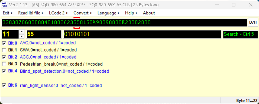

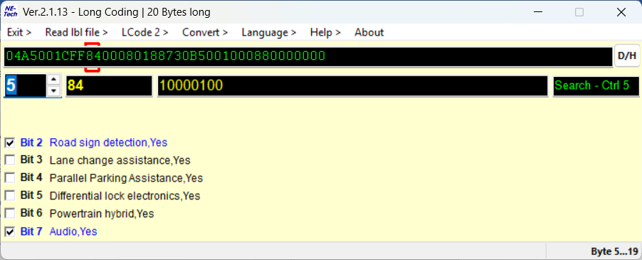

  4. @hamid_v Got finally the long codings, modules A5 and 17. There must be coding for front camera in module A5, but I did not see it. And of course be careful with coding, the long coding consist bits which may be not suitable for your car. Anyway, found an ancient instruction in my computer, maybe this would help: Enable traffic sign detection when Lane Keeping Assistant is installed STG 5F Adaptation Car_Function_list_BAP_gen2 Traffic_sign_recognition_0x21 Set to active Car_function_adaptions_gen2-menu Menu_display_road_sign_identification Set to active STG A5 encoding Byte 16, bit 4 Stg 17 encoding Byte 5, bit 2.

  6. @hamid_v Not familiar with Car Scanner. I did not enable these features on my car as I ordered them as options. You need specific camera, not all of them can be coded first. And not sure that 2021 car can be coded at all. Factory cut the access to OBD around that time.
