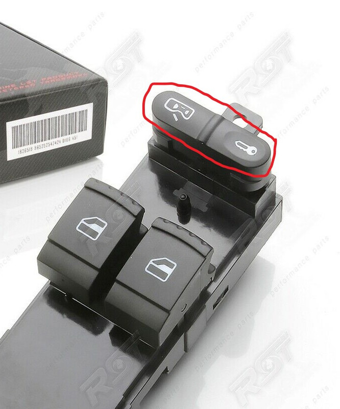

Easy way to tell - does it have this button on the door?...
Hi, no it does not. so no central locking then
No, probably still an issue with the lock module in the door though.
Thanks i will take a look  Mick
Yeah, was just trying to determine if it had central locking or not because I know the lock modules have the door switch in different places. Ones without C/L have the switch inside the unit I think, whereas it's on the outside of the others.
