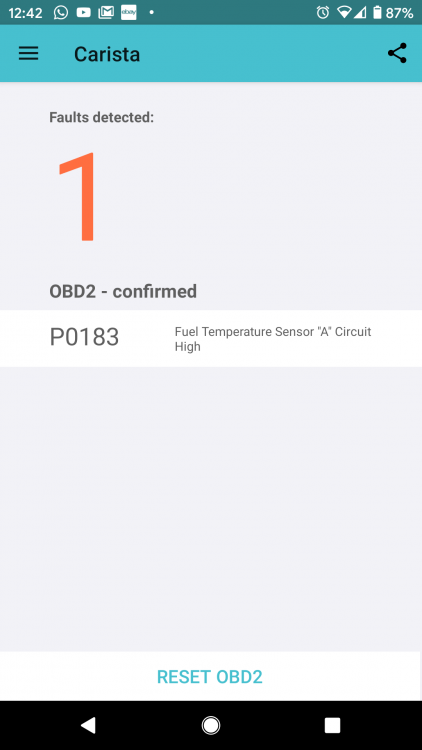

Had the orange engine light come on constant this morning. Used carista to scan and came up with P0183 Fuel Temperature Sensor "A" Circuit High.
