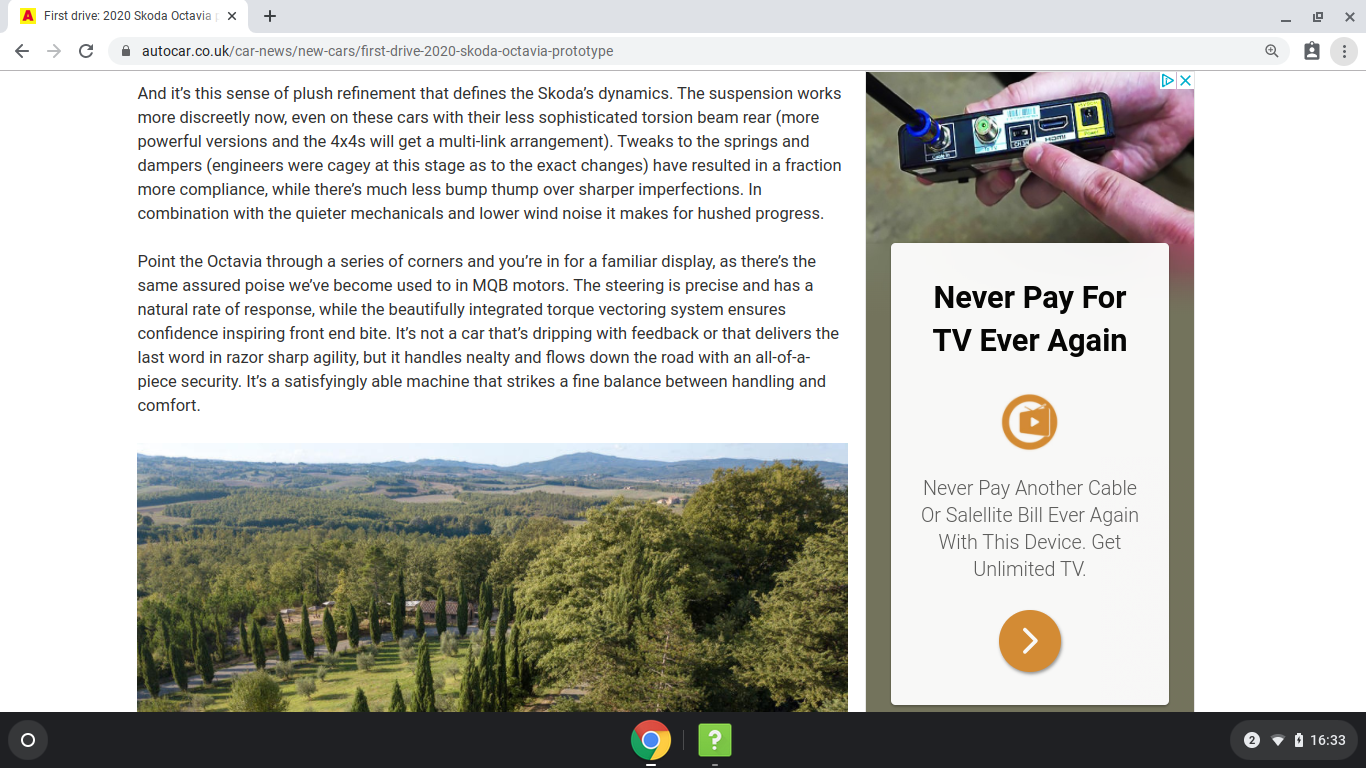

Has anyone seen information on what rear suspension is fitted to the 1.4TSi Hybrid?
A Phev version would interest me but not if it came with torsion beam.
You would hope this is considered by Skoda (& agreed by VW) as one of the 'More powerful versions' & gets Multilink.
