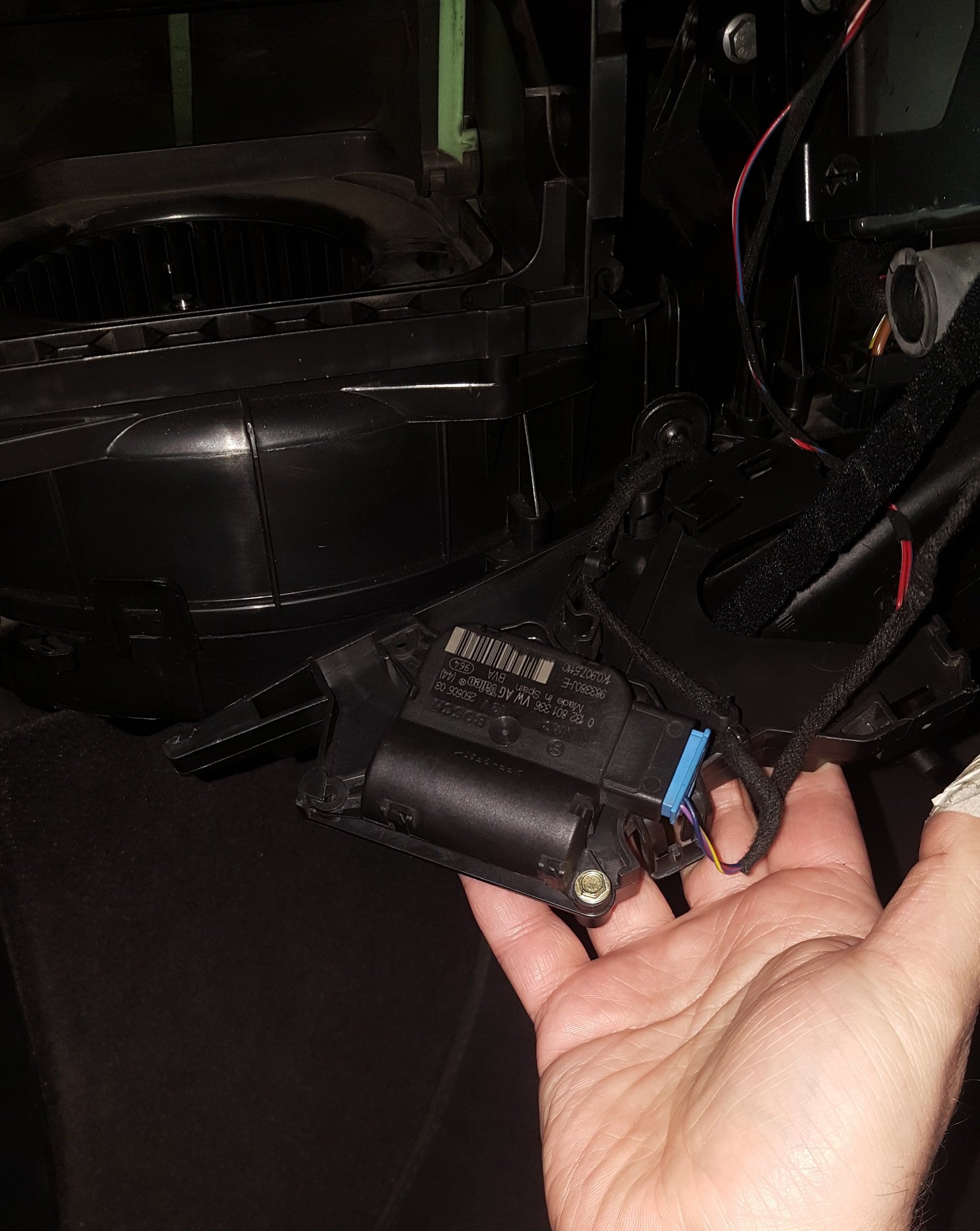

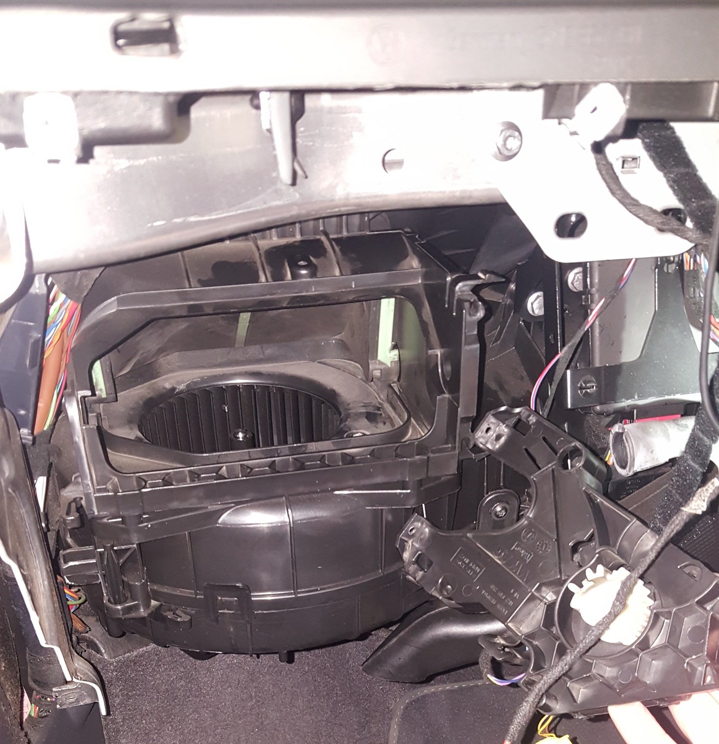

Anyway, the internal air blower system decided to self destruct! The fan blower bearings went which inturn blew the fuse relay. So I've replaced the fan & relay but noticed the Air Con Heater Vent Flap motor wasnt moving.
Does anyone know if the motor has a fuse or does it look like it needs replacing? I've taken it off & the Cog/Gear is solid - no moment at all. I suspect this shouldnt be the case.

I'd think that the gearing will be what is making that flap motor impossible to move with moderate force.  Have you exhausted all means of trying to command it to move using the heater controls?
