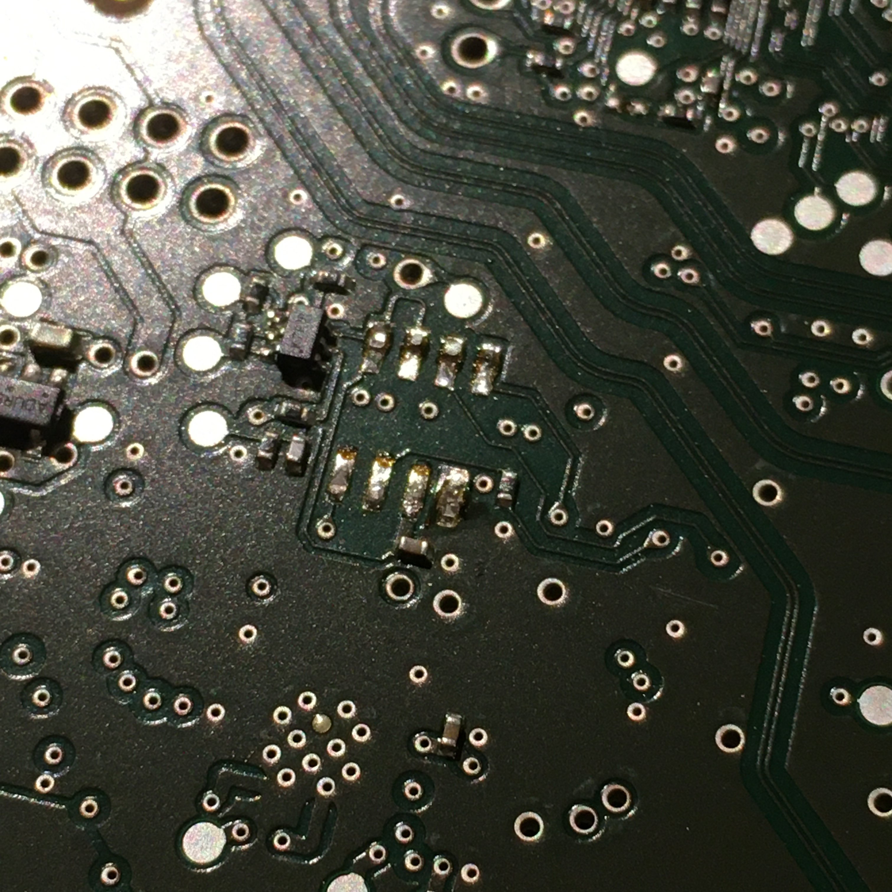

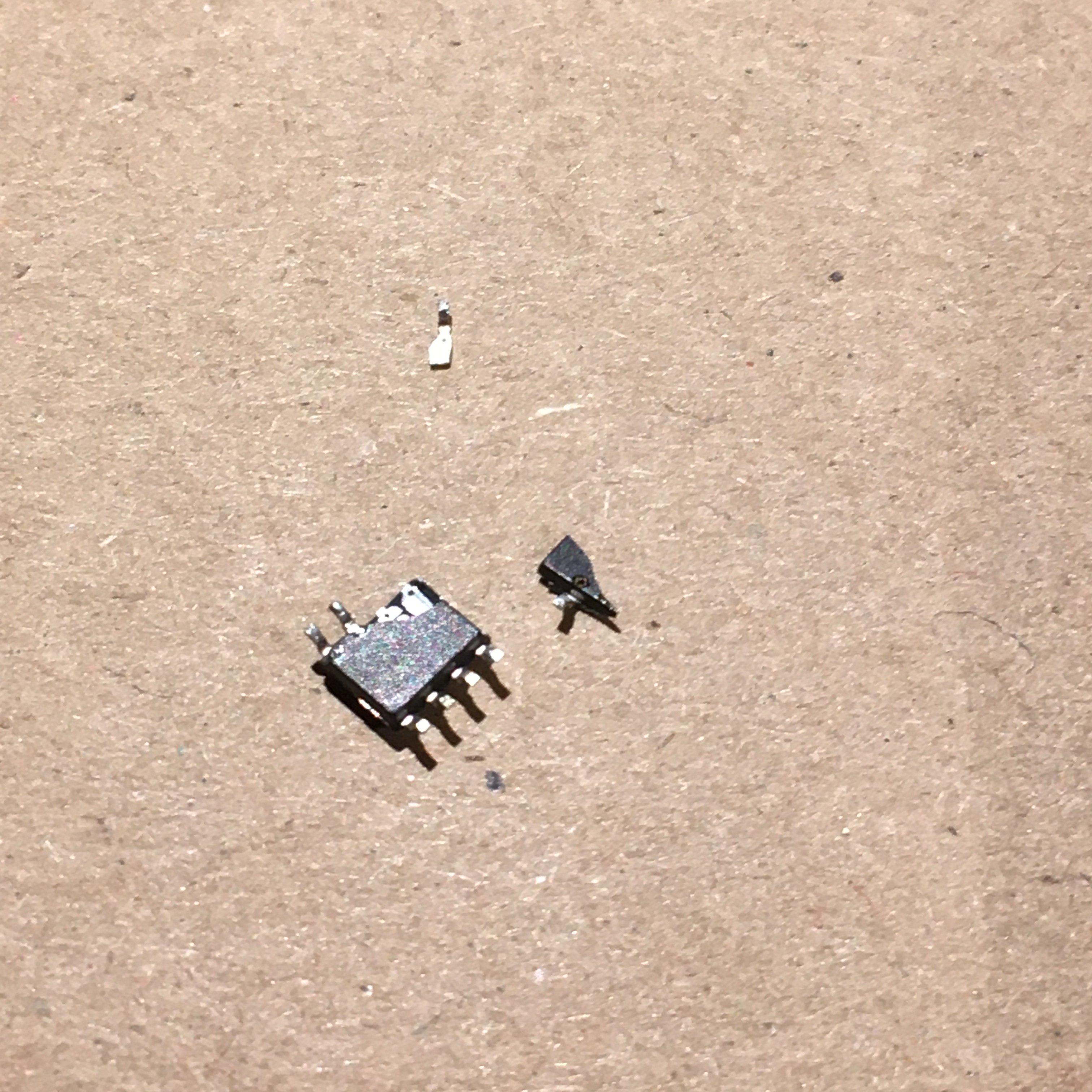

Dear @pab567 , I also can not send you PM, I have bought 5L0 035 680 C, with all functions active, but in process of patching eeprom chip fell apart into 3 pieces. Is this situation still solvable? I live near Poland border, so it may be easier with sending unit. I will be very thankful, if you can help me somehow, because now is device bricked..
Thanks in advance.
Thanks in advance.
I have deleted some messages so you can send me PM again.
Were you able to read EEPROM content or has it broken before you managed to read it?
Just reply you in PM
