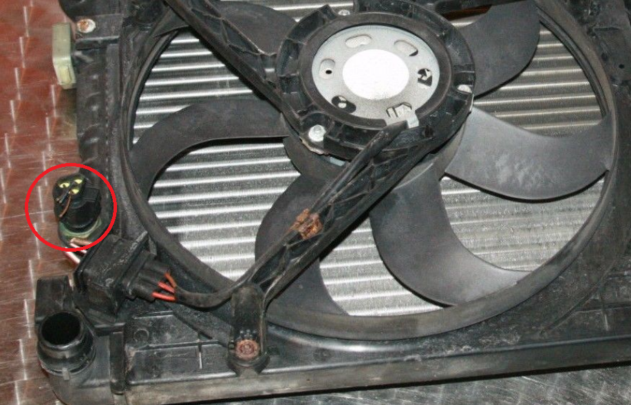

Passenger side near the bottom is where the thermoswitch is. You don't need to take the front off the car to see this, although it is in a bit of a busy area. Just look down (with a good torch) vertically below the top hose about 30cm and you'll see something with an electrical connector and three wires. If the body of that something looks wet with coolant, you've probably found the problem.
Same applies to coolant hoses, all are accessible from under the bonnet, or under the car, no need to take the front off.

No, but it's quite possible that the described leak is from the lower radiator hose end.
If you look at Wino's drawing, he's marked the thermoswitch; I'm talking about the union just below that (radiator installed). Either (or both) of us could be right, but it needs inspection to determine further.

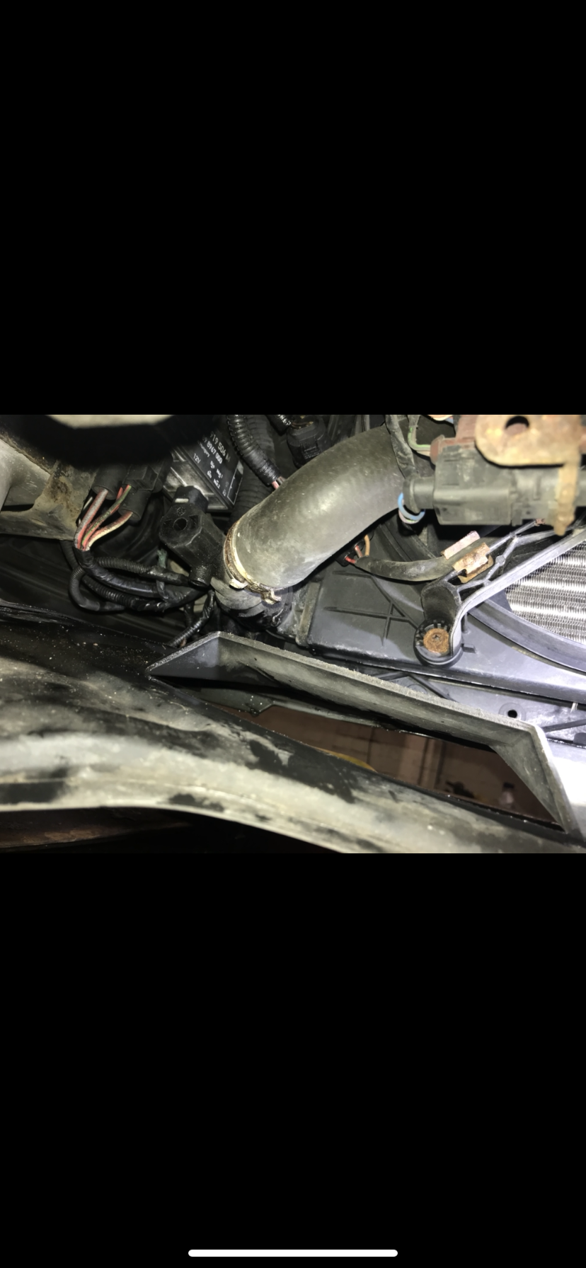

i have this photo from when i took it for inspection. this is the general area the leak is in, but i’m not sure exactly where. will get more info later
  • Sponsor
You've just caught the electrical connector of the thermoswitch at the top of that pic, but can't see the body of it for the obscuring lower radiator hose.

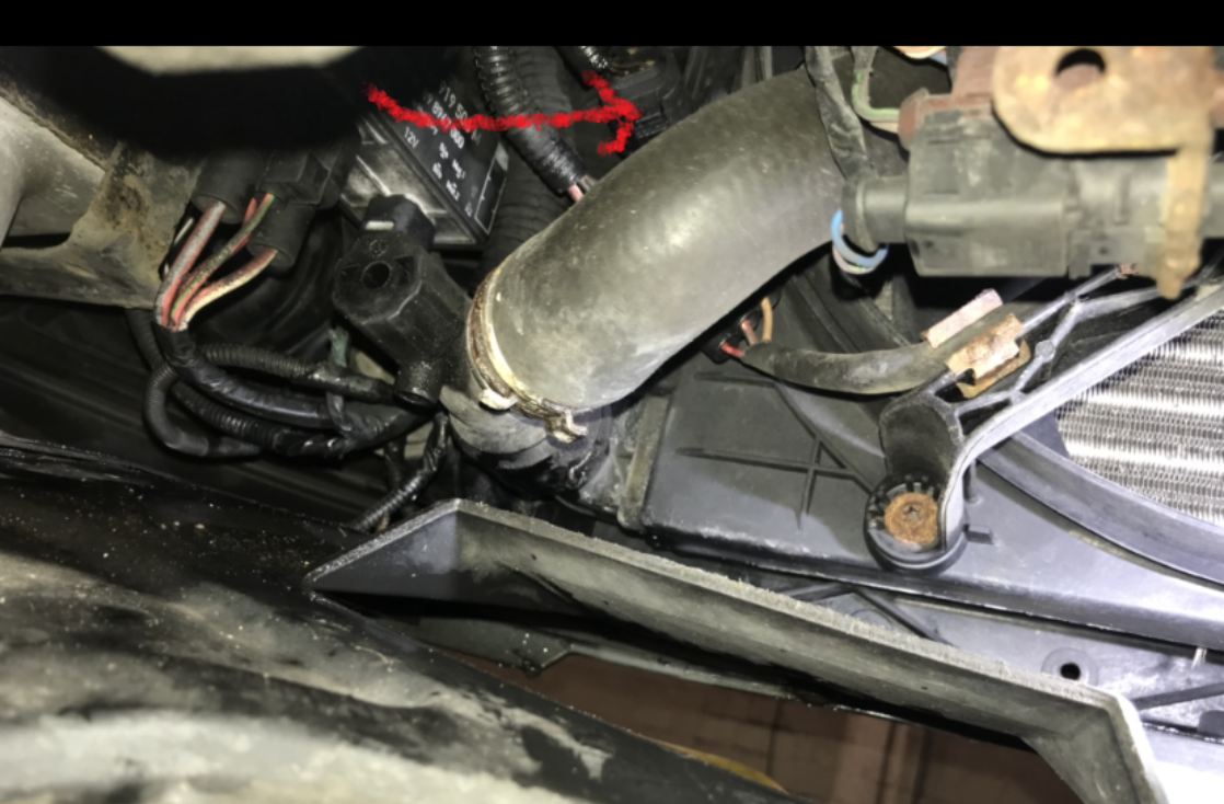

perfect, appreciate the help Wino. i know where to look now!

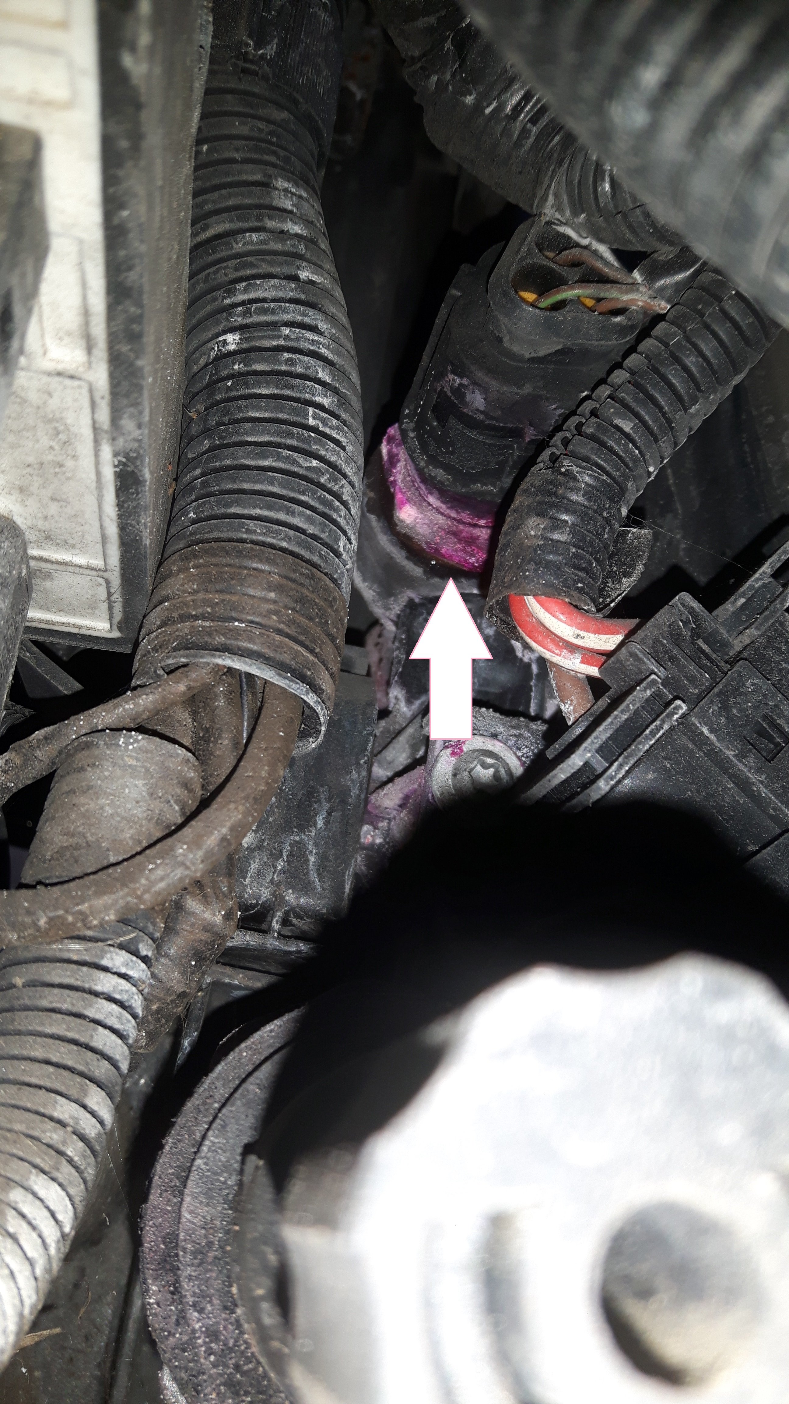

Another incidence of this found today, on the Polo I saved from the scrappies recently.  Thought the overfilled expansion tank was a tad suspicious but today was the first time I've got under it to have a browse while changing oil and filter.
Never seen quite such clear evidence of leakage from the thermoswitch/radiator interface. The thermoswitch metalwork is brass IIRC, somewhere under all that antifreeze residue:
Coolant drain tap blurred at bottom right corner of pic, radiator fan control unit peeking into shot top left.
